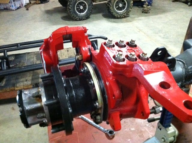

I'm wanting to up grade the brakes on the straight axle toyota. What do I need?
what Rotor?,what caliper?
grcthird said:What he said.I did the landcruiser rotors and ifs calipers before I knew about the tacoma setup.
mtngaprock said:What about the ifs hubs off a 98 tacoma will they fit?
grcthird said:Stupid question. Will the tacoma rotors and ifs calipers work with stock sfa hub bodies? I have all this stuff and have to tear into my front axle soon.
mtngaprock said:I went with the V6 calipers just to let y'all know I had to grind alittle off the outside of the caliper for wheel clearance.
