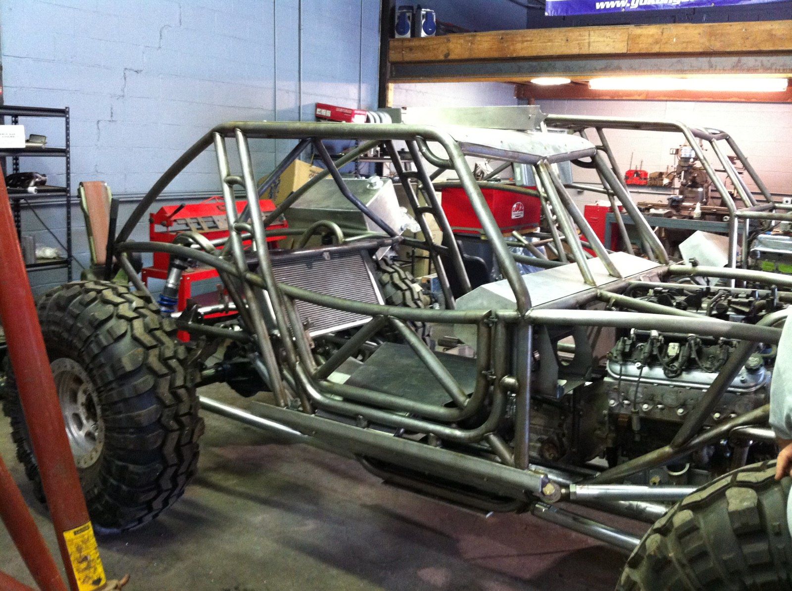

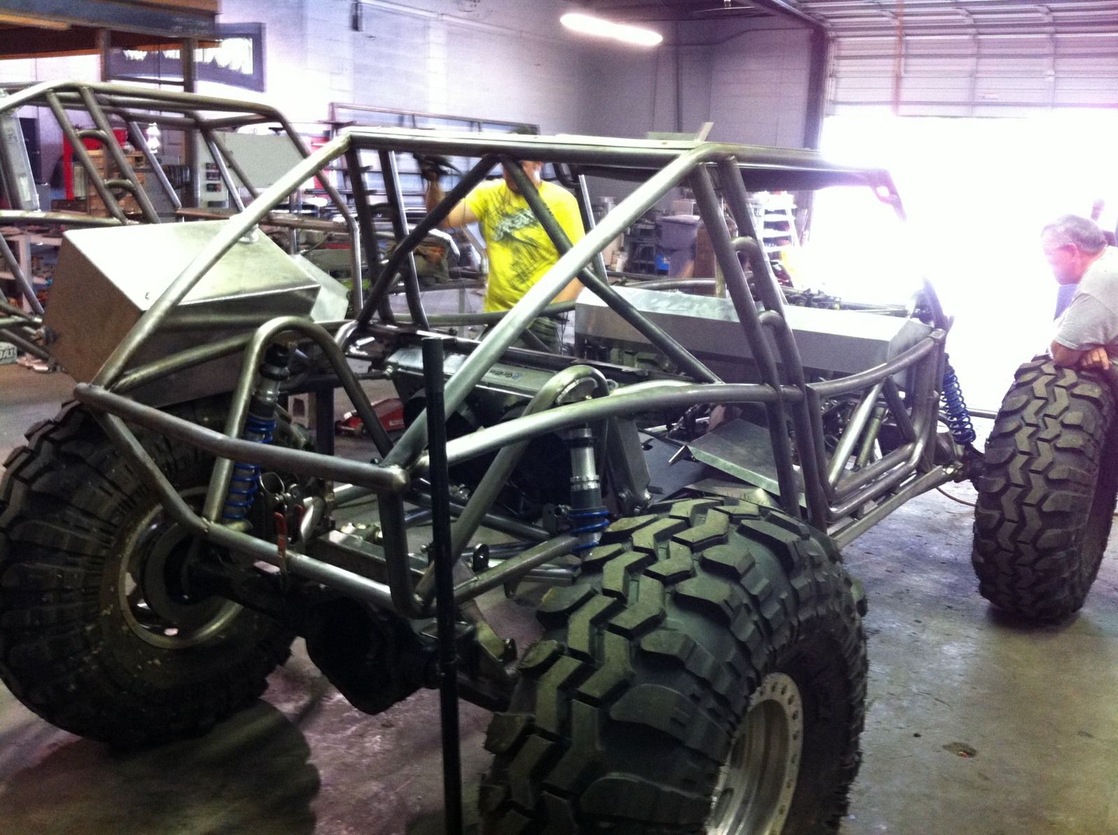

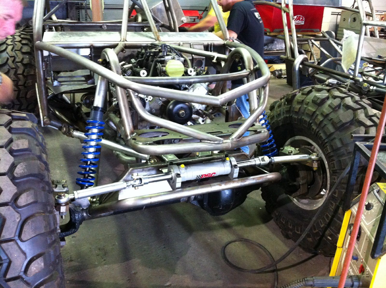

Heres a few pics of one he is building turnkey. Its the shorty with Evolution front end. Mine will not have the door option. Beside building mine into a roller hes also building me the engine skid, double ended ram mount, installing Crane high steer arms and roof panel. The link bars will be 7075 Aluminum (2 1/4" lowers& 2"uppers) with 1 1/4 QA1 rod ends.

xjcrawler said:
Man that chassis is sweet, love that it has doors. flashemifyougotem
I think Adam has done a great job on incorporating doors into this chassis.
bluzuk80, why did you decided to not go with doors on yours?
I might regret not getting the doors but just wanted to keep it simple and quiet. Figured they would rattle over time. They are badass though.
Should be picking it up soon. Adam called me monday and said that he had chassis done, about to link it. Setting the struts for 7in uptravel, 7in downtravel. 112 wheelbase with 20in belly :dblthumb:
