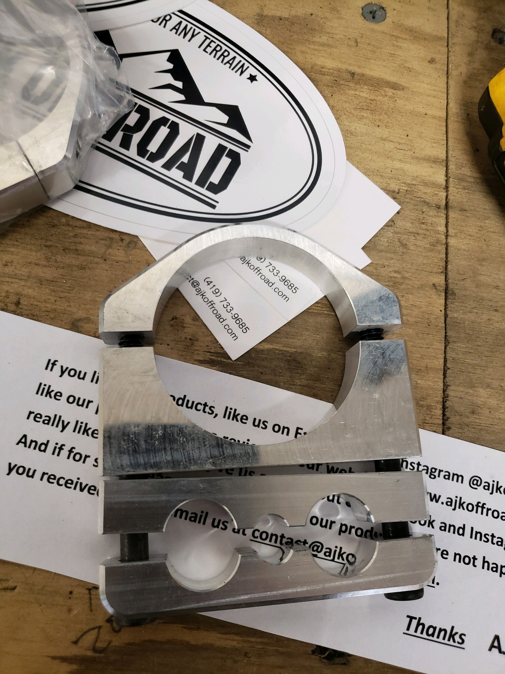

I just bought three of the AJK Offroad ones for my build. https://ajkoffroad.com/shop/brake-line-clamp/
Really nice pieces! I was going to fab something, but for $20 it wasn't worth my time to mess with it.

Yea there are some on there, and some we opted away from. They are cool pieces and are made really well, no doubt - but they are also kinda a pain in the ass. They have to be lined up perfectly to get started and juggling lines, a ratchet, 2 pieces and a bolt that have to be absolutely perfect....is easier on paper than it is in real life laughing1
They are definitely nice pieces though and if they are your thing...go for it. You wont be disappointed with them.

That was my experience with them on the bouncer I finished out. Found if you put 1 bolt in just a hair, and look at it just right you can get it to stay together long enough to get the lines in and the other bolt started. Quality is awesome, they do tend to sit the lines up off the link a little bit though, so if your links tuck up super close at bump you may have to watch where you put them.
kmcminn said:
Anyone ordered any of these from AJK?
Here's a couple pictures of mine installed. As mentioned, you can get the threads started in the bolt and there is enough room to get the line in the clamp portion from the top. You can loosely snug and then adjust spacing/angle, etc. There was enough room in the clamp to accommodate my -3An braided line without squishing it. Very line quality, but it is 1/2-3/4" above the link.

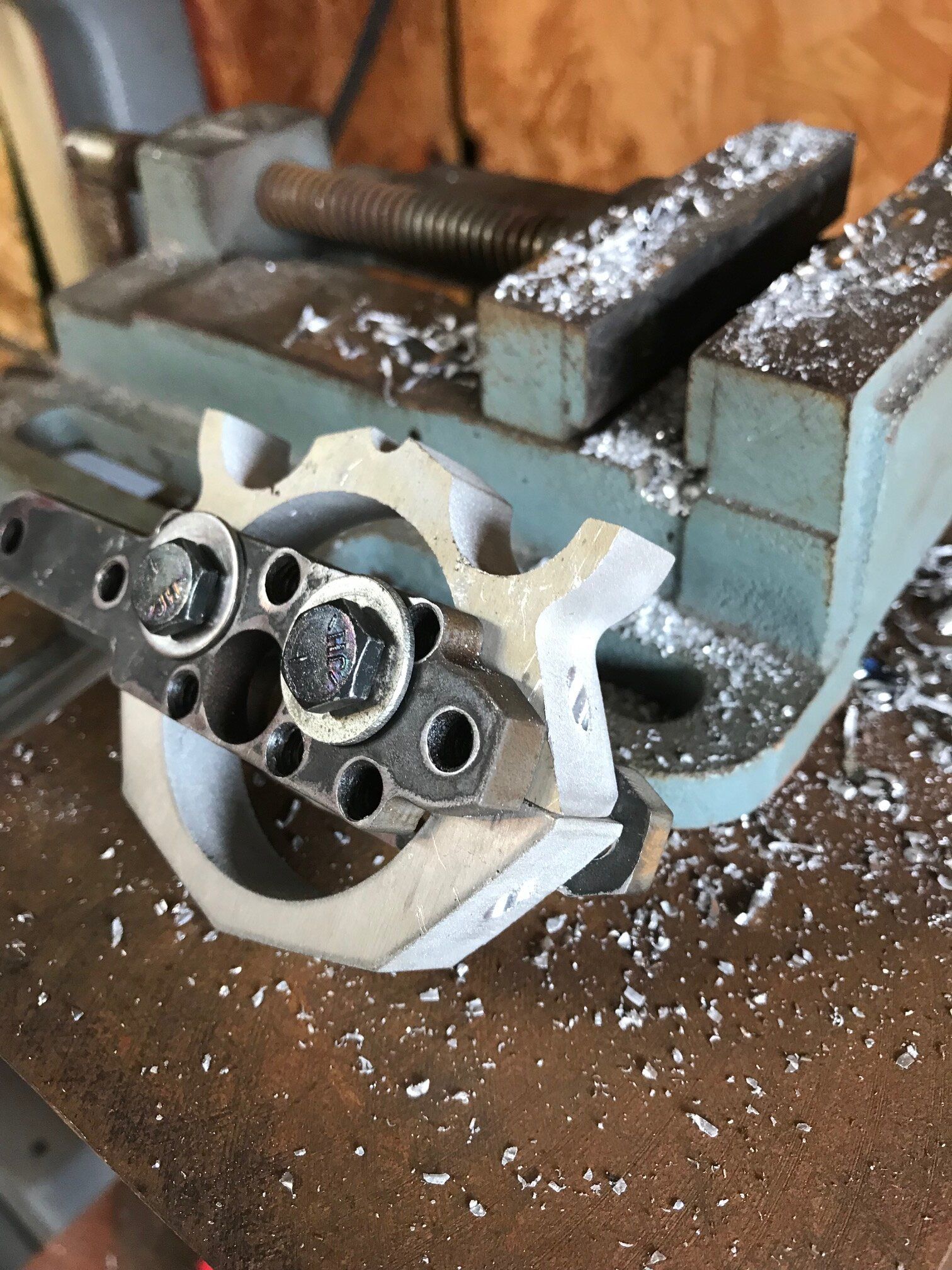

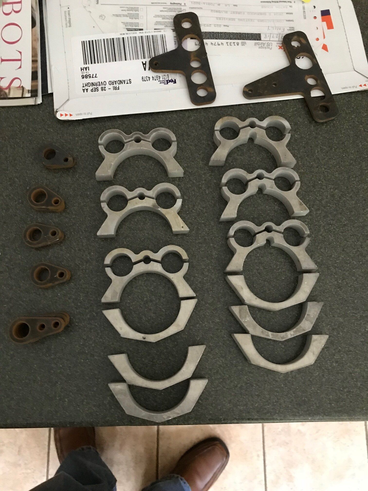

didn't find anything that met my needs, so making my own
