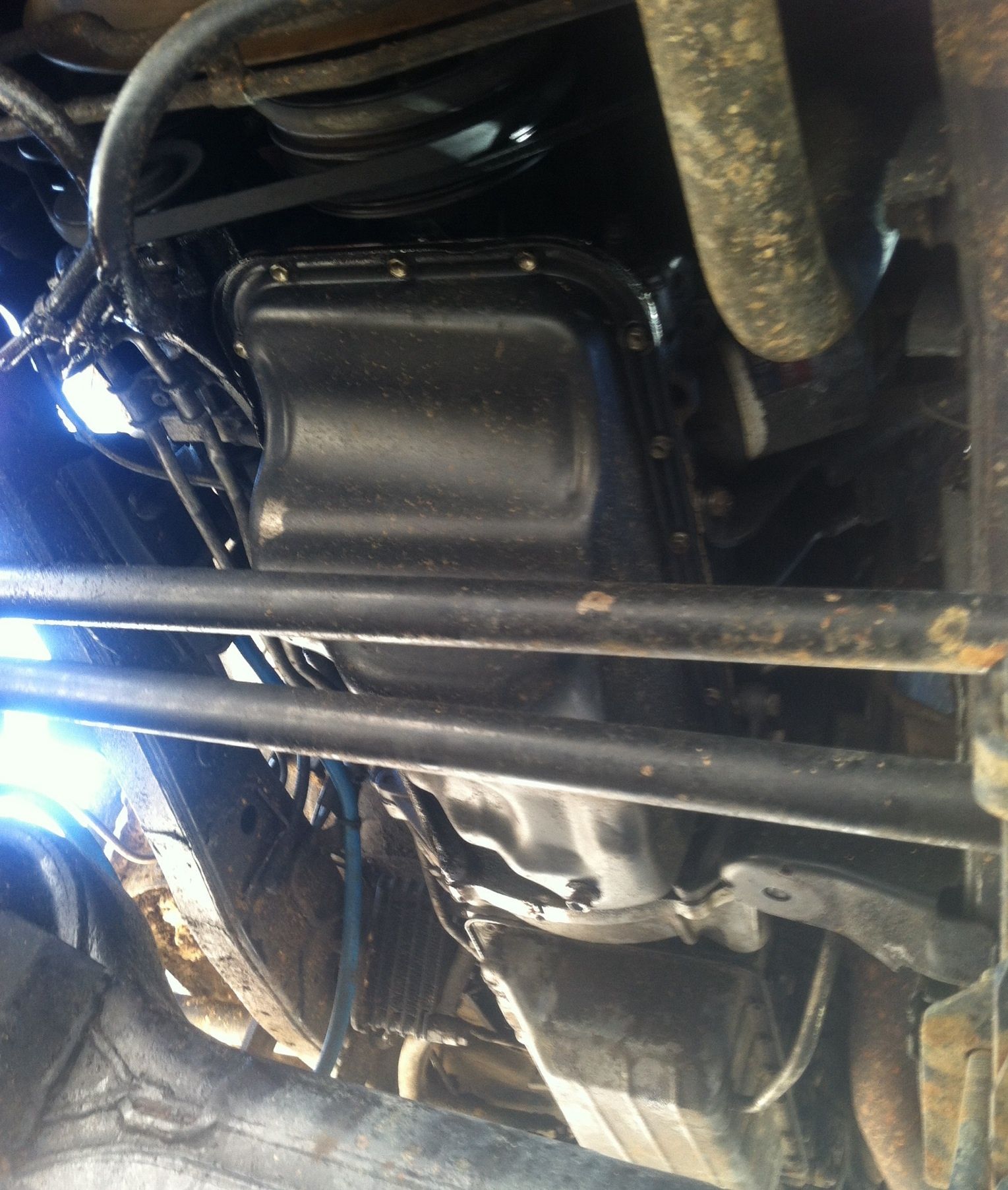

<blockquote data-quote="krackem" data-source="post: 366898" data-attributes="member: 4134"><p>Yeah you pretty much described it not sure on if an 88 suspension components are in the way as I have a straight axle 85, but just fit if using a rubber/poly gasket WITHOUT a metal rings (will not have metal rings in the gasket around bolt holes) don't tighten till the bolts wont turn anymore and the gasket squishes out the sides, Just tighten them down snug all the way around the pan and make sure the gaskets stays pretty flush with the pan <img src="/styles/default/xenforo/smilies2/dblthumb2.gif" class="smilie" loading="lazy" alt=":dblthumb:" title="Dblthumb2 :dblthumb:" data-shortname=":dblthumb:" /></p><p></p><p>Edit just seen the SAS your good to go</p></blockquote><p></p>
[QUOTE="krackem, post: 366898, member: 4134"] Yeah you pretty much described it not sure on if an 88 suspension components are in the way as I have a straight axle 85, but just fit if using a rubber/poly gasket WITHOUT a metal rings (will not have metal rings in the gasket around bolt holes) don't tighten till the bolts wont turn anymore and the gasket squishes out the sides, Just tighten them down snug all the way around the pan and make sure the gaskets stays pretty flush with the pan :dblthumb: Edit just seen the SAS your good to go [/QUOTE]
