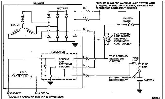

<blockquote data-quote="NotMatt" data-source="post: 996794" data-attributes="member: 15947"><p>Right, but if you read the original post, you'd see that I had the alternator tested and the parts monkey says it's working properly. If you've got money laying around to throw at my vehicle, you could send it to me... I'll try the free troubleshooting first. :flipoff: </p><p> </p><p></p><p> </p><p>Mine's internally regulated too it looks like.</p><p> </p><p>I was messing around with the rig earlier that day, pulling some old wiring out from a snow plow setup, and I'm thinking that I may have shorted something out and burned up the fusible link.</p></blockquote><p></p>
[QUOTE="NotMatt, post: 996794, member: 15947"] Right, but if you read the original post, you'd see that I had the alternator tested and the parts monkey says it's working properly. If you've got money laying around to throw at my vehicle, you could send it to me... I'll try the free troubleshooting first. :flipoff: Mine's internally regulated too it looks like. I was messing around with the rig earlier that day, pulling some old wiring out from a snow plow setup, and I'm thinking that I may have shorted something out and burned up the fusible link. [/QUOTE]
