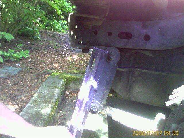

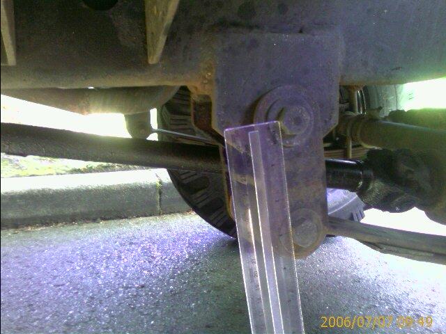

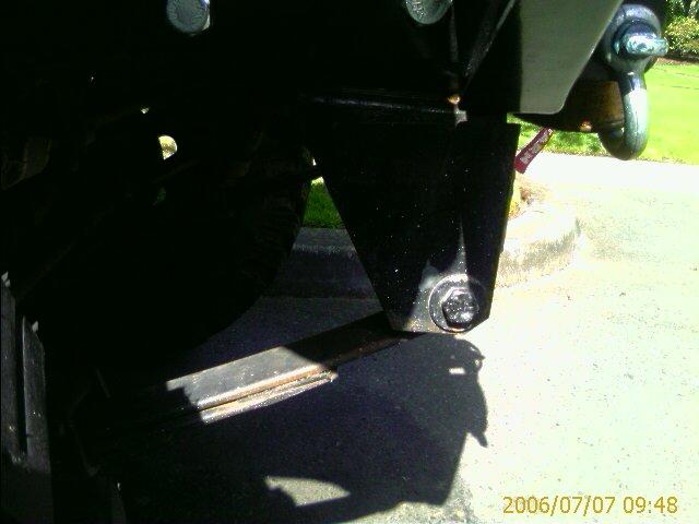

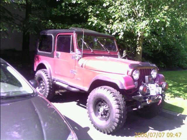

<blockquote data-quote="bobracing" data-source="post: 782607" data-attributes="member: 16070"><p>Like other have said, there is a RS on the rig.</p><p>RS is about 1.5-2" lift with stock spring, the shackle look about stock length up front.</p><p>The rear longer shackles were probably added to level the Jeep out.</p><p></p><p>IIRC, stock shackles are in the 2.5-3" range. which would make the back with 6" shackles about 1.5" (1/2 the extra length) taller. I don't see any problem with that rig being on stock springs, but it's still about 1.5-2" over stock height.</p><p></p><p>As NotMatt said, wouldn't be a bad idea to get the shackles pointed back. This will soften the ride and also won't allow the shackle to flip forward and bend the spring.</p></blockquote><p></p>
[QUOTE="bobracing, post: 782607, member: 16070"] Like other have said, there is a RS on the rig. RS is about 1.5-2" lift with stock spring, the shackle look about stock length up front. The rear longer shackles were probably added to level the Jeep out. IIRC, stock shackles are in the 2.5-3" range. which would make the back with 6" shackles about 1.5" (1/2 the extra length) taller. I don't see any problem with that rig being on stock springs, but it's still about 1.5-2" over stock height. As NotMatt said, wouldn't be a bad idea to get the shackles pointed back. This will soften the ride and also won't allow the shackle to flip forward and bend the spring. [/QUOTE]
