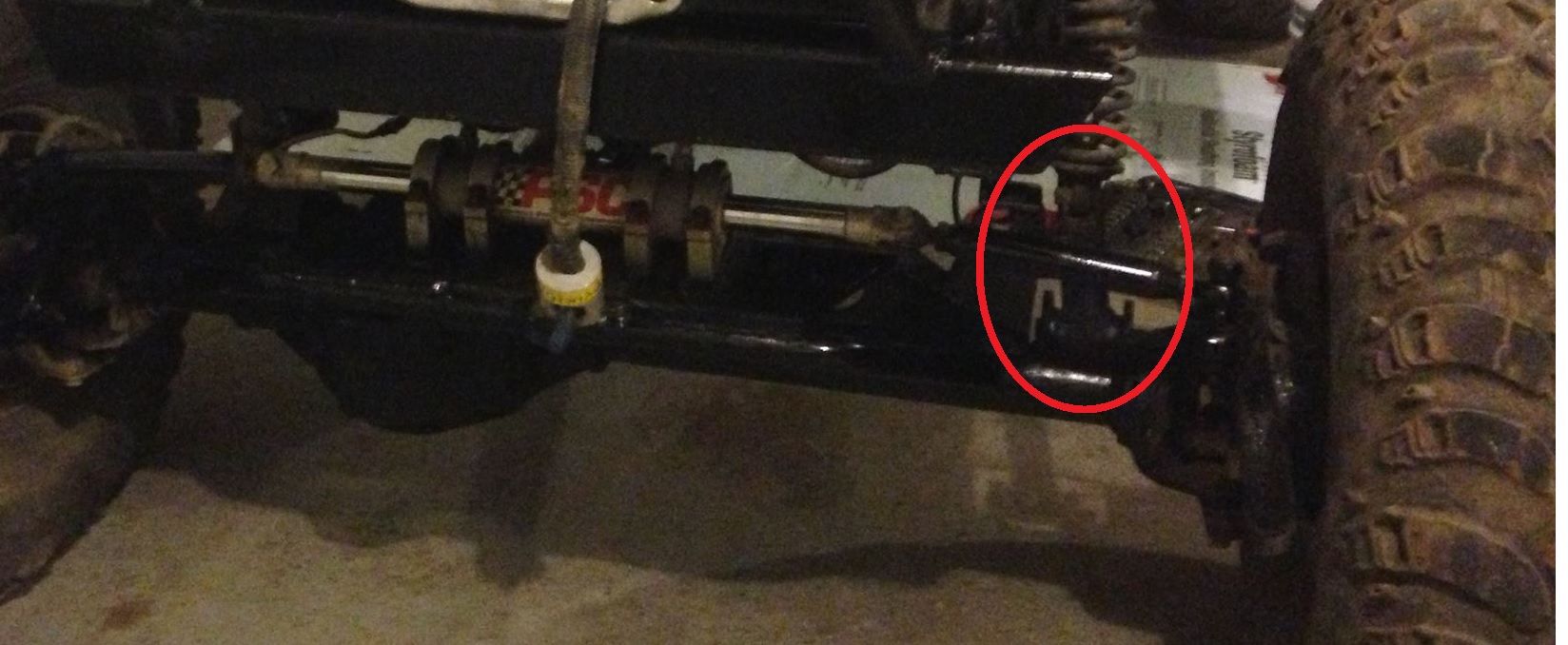

<blockquote data-quote="RustyC" data-source="post: 433532" data-attributes="member: 1997"><p>The link or arm also needs a bushing or machined washers or something added to the hiem to stop it from rotating at one end of the link. Most I have noticed are on the chassis side.</p><p>The advantage is slow shaft speeds of the shock shaft meaning less heat. Heavier springs a also needed.</p></blockquote><p></p>
