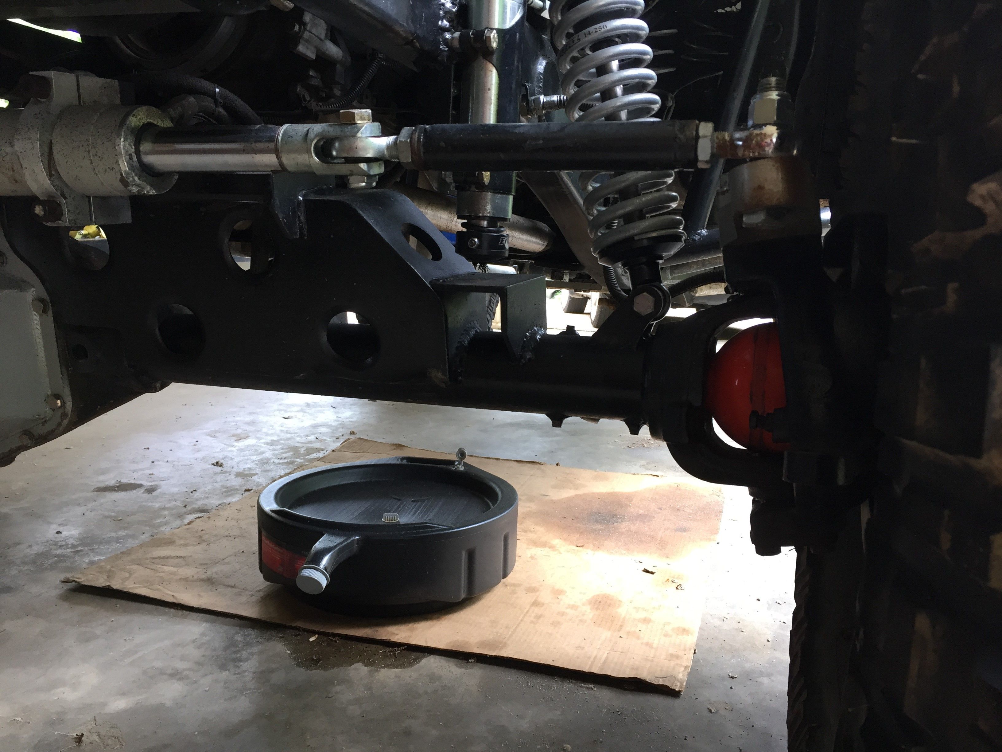

I noticed 1 of my fox 2.0 bumps is stuck in the up position. Has anyone else had any experience with this or had the same problem?
I bet your bolts are to tight on the can. They need to be just tight enough to keep the bump stop from falling out of the can. Loosen the bolts up and I bet you will be fine.
Thanks for the help! Ill try that out.
I loosened up the bolts and the shaft extended back to normal. Thanks again.
