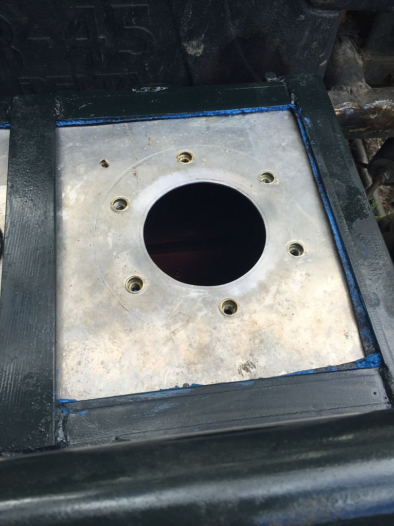

M Metchosin joe Active Member Joined Sep 20, 2014 Messages 44 Oct 24, 2016 #3 Here's what I did Only recommendation is to use rivnuts that are capped or what ever. I get some fuel weeping through the bolts
