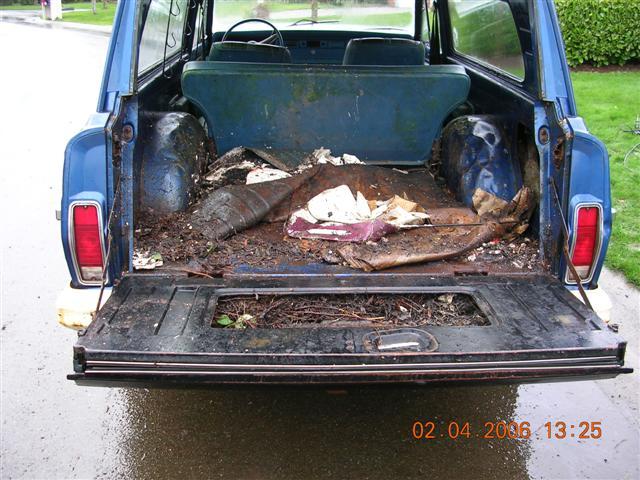

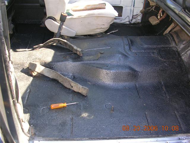

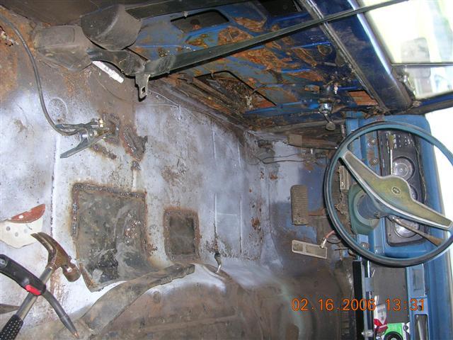

<blockquote data-quote="angelfly" data-source="post: 966685" data-attributes="member: 16949"><p>Its super easy i've done 4 rigs no i love the stuff. I roll it on just because i was told i can get a huge $fine$ for spraying with out a both or filtration system. According to a neighbor who sprayed his on he said he would never spray it again!</p><p></p><p></p><p>I guess over spray is a problem and everything else that goes alongh with painting with a gun. As far as prep goes, sand everything you want coated down to bare metal or atleast through a few layers. I used like a 36grit soft pad i believe after i sanded to go back and really scuff up the surface. I blew it out then why it all down with final klean(body shop product) and then taped and rolled on. I dont have the best pics but heres a few to give you an idea</p></blockquote><p></p>
[QUOTE="angelfly, post: 966685, member: 16949"] Its super easy i've done 4 rigs no i love the stuff. I roll it on just because i was told i can get a huge $fine$ for spraying with out a both or filtration system. According to a neighbor who sprayed his on he said he would never spray it again! I guess over spray is a problem and everything else that goes alongh with painting with a gun. As far as prep goes, sand everything you want coated down to bare metal or atleast through a few layers. I used like a 36grit soft pad i believe after i sanded to go back and really scuff up the surface. I blew it out then why it all down with final klean(body shop product) and then taped and rolled on. I dont have the best pics but heres a few to give you an idea [/QUOTE]
