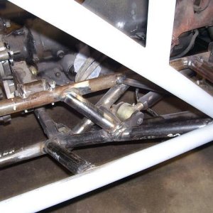

<blockquote data-quote="Eddyj" data-source="post: 484434" data-attributes="member: 3779"><p>I took out like 7/8 of an inch just because I prefer the ram to be the limiting factor not the stops. Because at full turn the ram is pushing on the tie rod and heims. Also I left my stops in the stock position I didn't try to turn the stops in for more turning. I probably could have gained a 1/4 inch each way if I had maxed out the axle shafts.</p></blockquote><p></p>
[QUOTE="Eddyj, post: 484434, member: 3779"] I took out like 7/8 of an inch just because I prefer the ram to be the limiting factor not the stops. Because at full turn the ram is pushing on the tie rod and heims. Also I left my stops in the stock position I didn't try to turn the stops in for more turning. I probably could have gained a 1/4 inch each way if I had maxed out the axle shafts. [/QUOTE]
