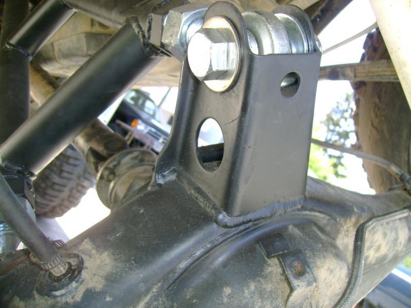

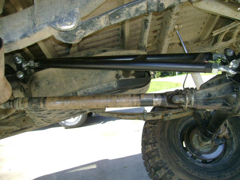

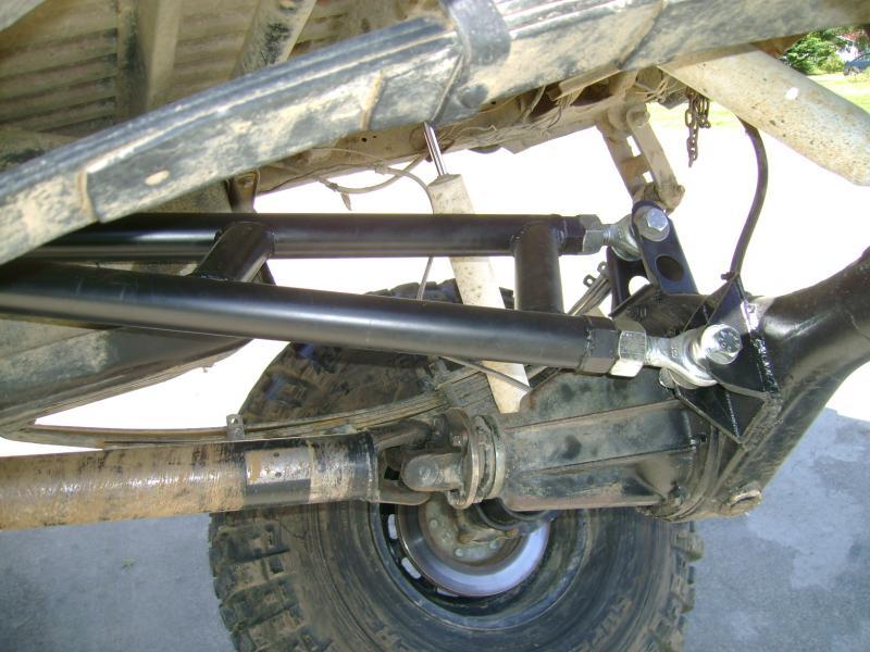

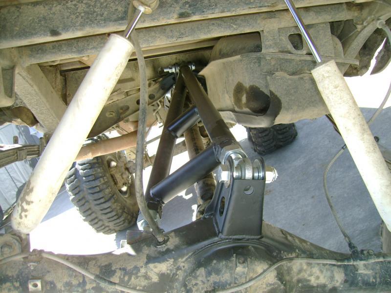

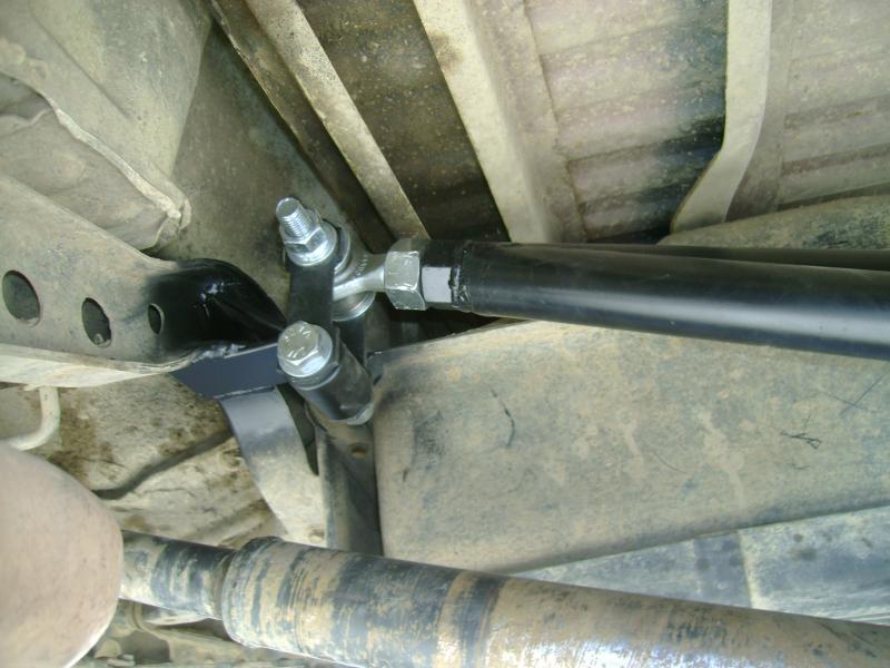

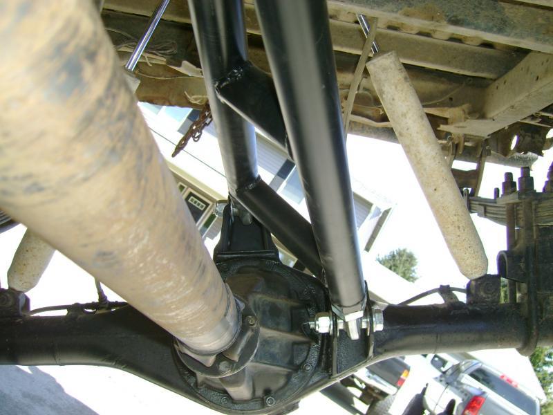

<blockquote data-quote="graysquirrel" data-source="post: 1365430" data-attributes="member: 18040"><p>Just an update....</p><p></p><p>This thing is AWESOME, totally strong enough just how i built it and is it just amazing the difference between having BAD axle wrap to none. Before i would dump the clutch or just even giving it throttle or just normal taking off, and it would be a second or two before i would move and it was just loose and unstable. Energy would just go to the springs and they would soak it all up and just twist. Kinda hard to explain. But now its like instant traction, power is directed right to the tires and all the energy is put right to the ground. Much more stable feeling wheeling and even on gravel roads and such. :cheer:</p></blockquote><p></p>
