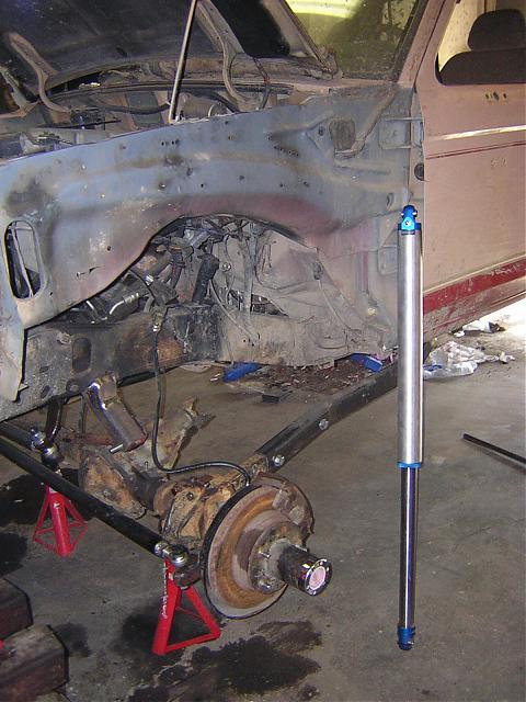

<blockquote data-quote="dkbstoy" data-source="post: 915173" data-attributes="member: 16731"><p>:beer: when your using it to hold up the front of your truck overkill is good be sure to plate the frame where your welding the hoops to to expand the surface area and gusset the piss out of them ive seen standard shock hoops tear off because of a lack of gussets... just my .02</p></blockquote><p></p>
