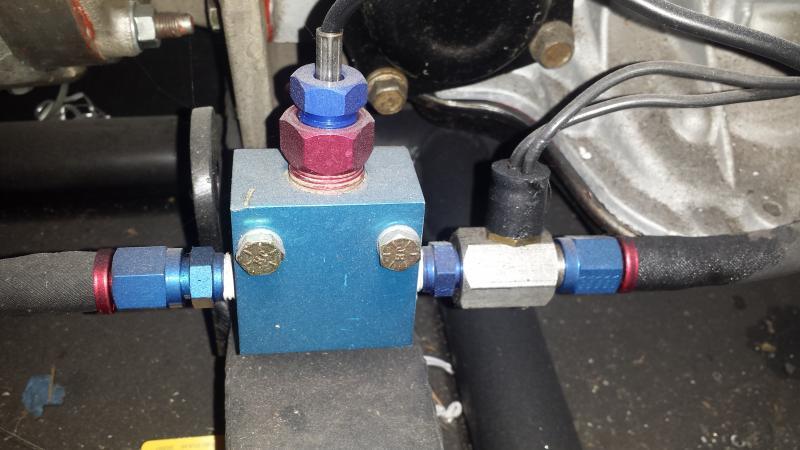

<blockquote data-quote="DHR Darren" data-source="post: 1559550" data-attributes="member: 20776"><p>The temp gauge sender is in the anodized block and the thermo switch is in the small, natural fitting. </p><p></p><p>I wire my thermoswitch into a dash light also so it signals when cooling fan is on.</p></blockquote><p></p>
