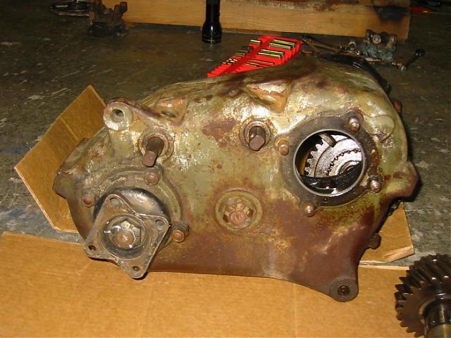

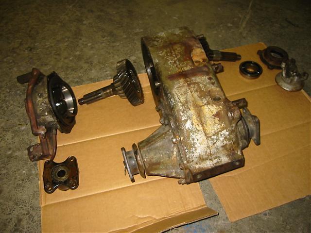

<blockquote data-quote="Binder" data-source="post: 979893" data-attributes="member: 16063"><p>Does that case even have a shifter interlock pill? Try shifting the rails independantly and see. If they move independant then nothing to do internally to make it twin stick. Now when you shift it see if one shifter is for high and low and the other for 2wd and 4wd. If yes you may not even want to bother twin sticking it. If this is the case I wouldn't even use it for a wheeler at all.</p></blockquote><p></p>
