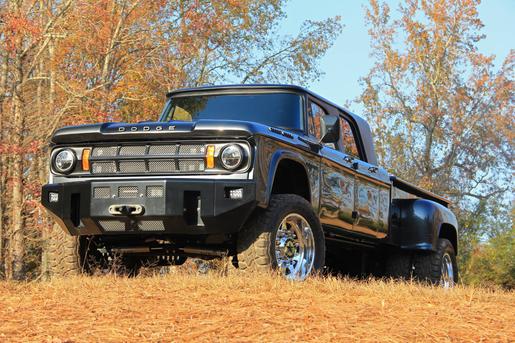

Check this one out.
built by Time Warp Customs on a 2014 Ram 3500 chassis.
Re: 1968 Dodge D200 Tow rig/Daily driver Project
Craig said:
Check this one out.
That one was finished up this past October. It's the only one I have been able to find that was a dually and step side bed. It's a beautiful truck
