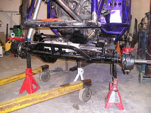

So, here is the front about ready to hang (if my damn ARB's would show up!)

And the ripped off upper steering box mount I discovered during tear down (gee wonder how that happened :rolleyes: )

But brian thats a sheet metal diff--I would not even wory about plating the housing brad.. Just try your best to have 4 locations where the mount goes into the diff with gussets on the 2 outised mounts at the diff... All the ones I have sen that rip off the housing had no gusseting at the outter mounts...

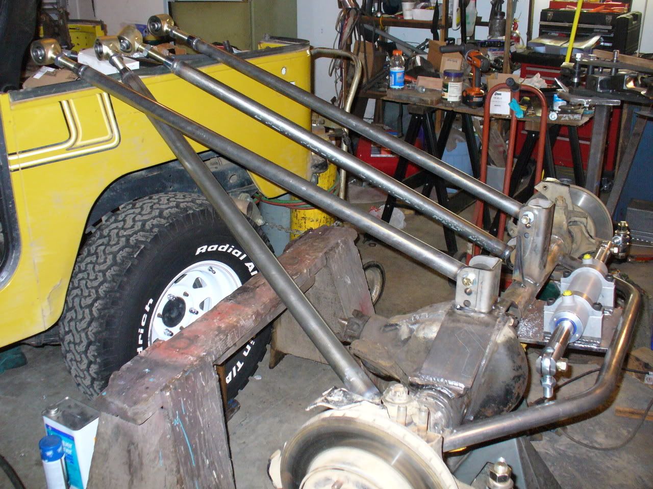

OK! I panicked just a little after building my x-member and discovering I only had about 20 degrees rotation before link bind! But decided to run with it and see if I couldn't widen the uppers somemore once it was under the rig.
I was ablle to move the uppers out about 3/4" on each side which netted me this :
Notice that is a yardstick under the driverside and the pass is on the floor!
I now have more travel available then my shox can use so :cheer: No link bind, no worries!
Everything works exactly right! :clappy:
