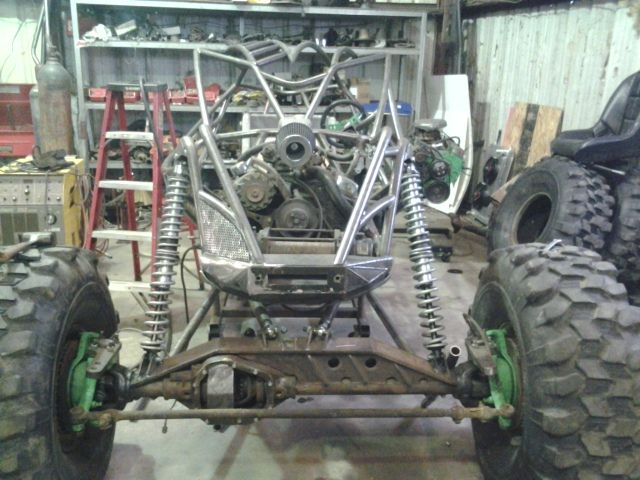

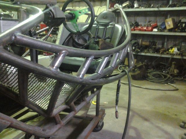

I'm building a little buggy that is as simple as it gets plans are to see if it holds up . It will be built out of .130 hrew an a lot of it .has an old .30 over 350 on pain, 60 /14 bolt , 5.13. Gears th400 2wd .clocked 205 twin stick every part of this buggy I've either built or traded for traded out work on . When its finished I will beat it to death an then we will see exactly what will happen if u build a buggy out of aneything but dom .I'm going with 7/8himes on the lowers 3/4 uppers . I've got 11/4 himes on the shelf I just want to see what happens
Reasons! Not to prove aneything but I have gotten hundreds of people asking will this hold up or will that . I try to answer the best I can .so sense I'm not to where I can build the buggy that is in my head yet I decided to use what was around here . I will post every ride anthe out come on this thread Iif there is enough interest . If it holds up good enough for me to deside if it will do good I will sale it if not I will take every thing out scrap it an go another direction .no big deal either way .

Sure .but I have to tell ya I'm even going to cut some of the bars short an fill the gap up with weld an grind them down just to see if they hold up , I'm going to do a tube splice an weld itup with no sleeve . All the questions I've been ask sence I started I will be able to answer when this is done :****:

Awesome, find the weakest link of the whole rig by breaking it... then fix only that one part, and see what's next :woot:
This buggy is well braced I don't even know if u will scratch the paint on that chassis lol ... U do a lot of work for a one man operation

looks great dom or not you are one of the top chassis guys i see right now and you keep pumping them out i envy you
