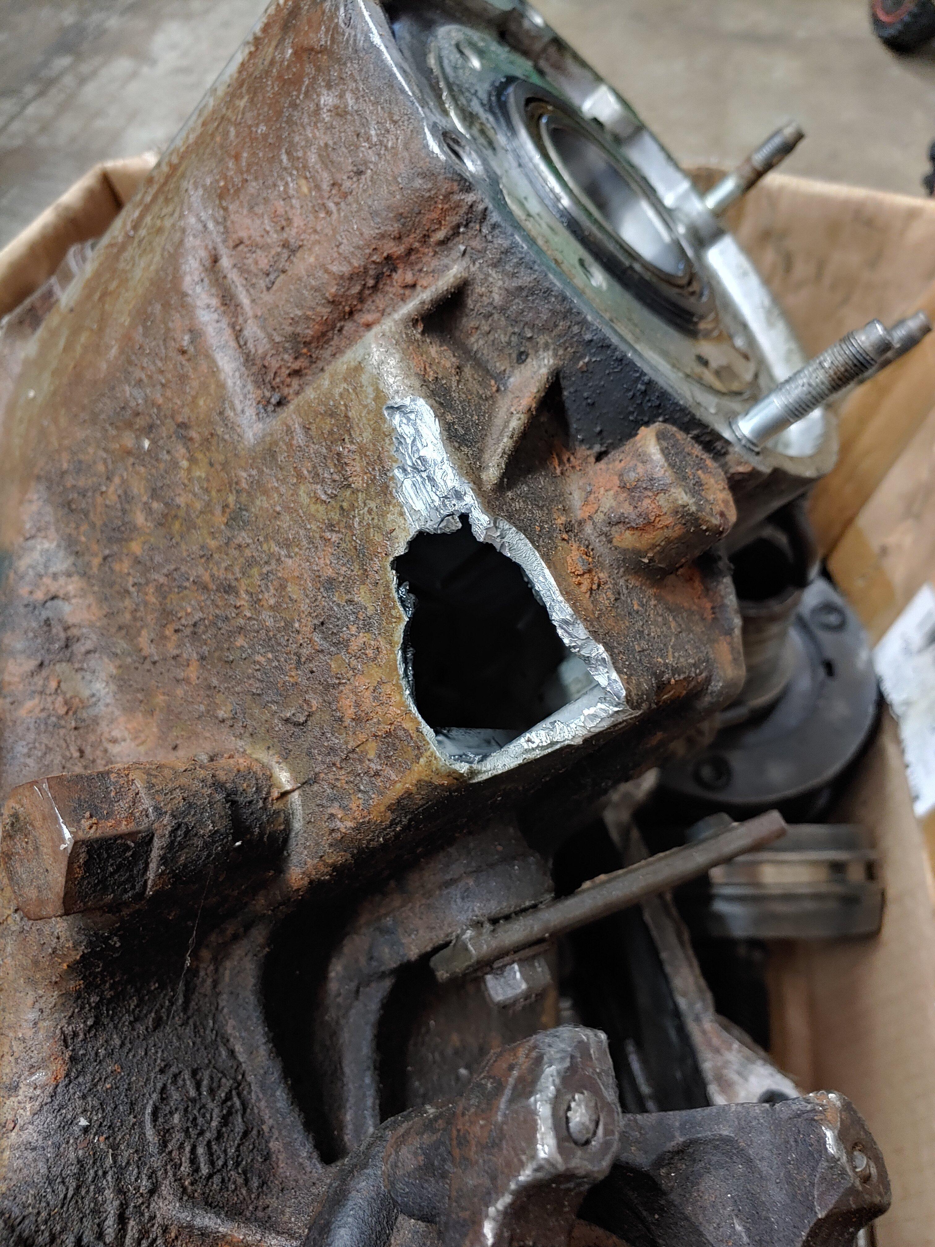

I'm looking for a whole complete NP231J from a YJ. One from a TJ might work work too. My YJ is a 4 cyl 5-speed. After my front driveshaft come out a while back and knocked a hole in mine, I got a 231 from an AMC and it's not working out.
Or does anybody know someone thst could weld up the hole in my original case?

Do you have any pics of the damage?

Yes, the damage is in the front half. And yes, mine is a 23 spline input. I'm pretty sure my planetary gear is still good. Would it work with the parts you've got?

The housing won't work, the half you need anyway. Everything else would work. I've repaired some aluminum oil pans that had holes knocked in them and they turned out ok. I could try to fix that one if you want me to.
Ok, sounds good. Send me a pm with a phone number and good time to call or text you. Thanks
