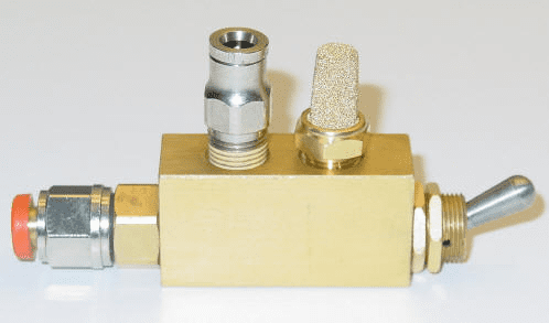

Anyone using the ARB-2080 toggle switch? I'm wanting to get away from the solenoids and use air switches and probably a jet pack.
Also, I'm ditching the plastic line in favor of braided hose and -3 fittings. Does anyone have a cheaper alternative to suggest?

I've used air toggle switches in the past with push lock fittings and plastic tube before. No complaints here. The ones I had just had an input, output and purge. Always wanted to put the end of a whoopie cushion on the purge but never got around to it.

I ran a 1/4" push lock adapter off the ARB bulkhead fitting on the diff and common 1/4" air line (think I used HD black air brake hose). I liked being able to use any 1/4 plastic line as a spare instead of specialty line. Then installed a basic pneumatic switch, CO2 paintball tank , and 120psi regulator to keep it all mechanical with no electronics to fail.
