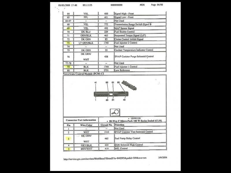

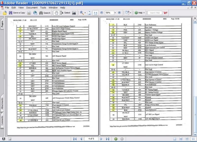

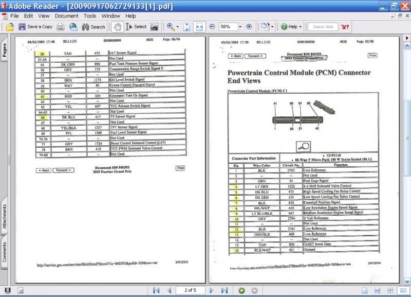

Re: 3.8 supercharged buggy build
OK here's the best I can do right now. This is what seems to be the general cut down. Pulled these from 3800 series ii help on pirate...its a very good thread to check. Hope this helps.
