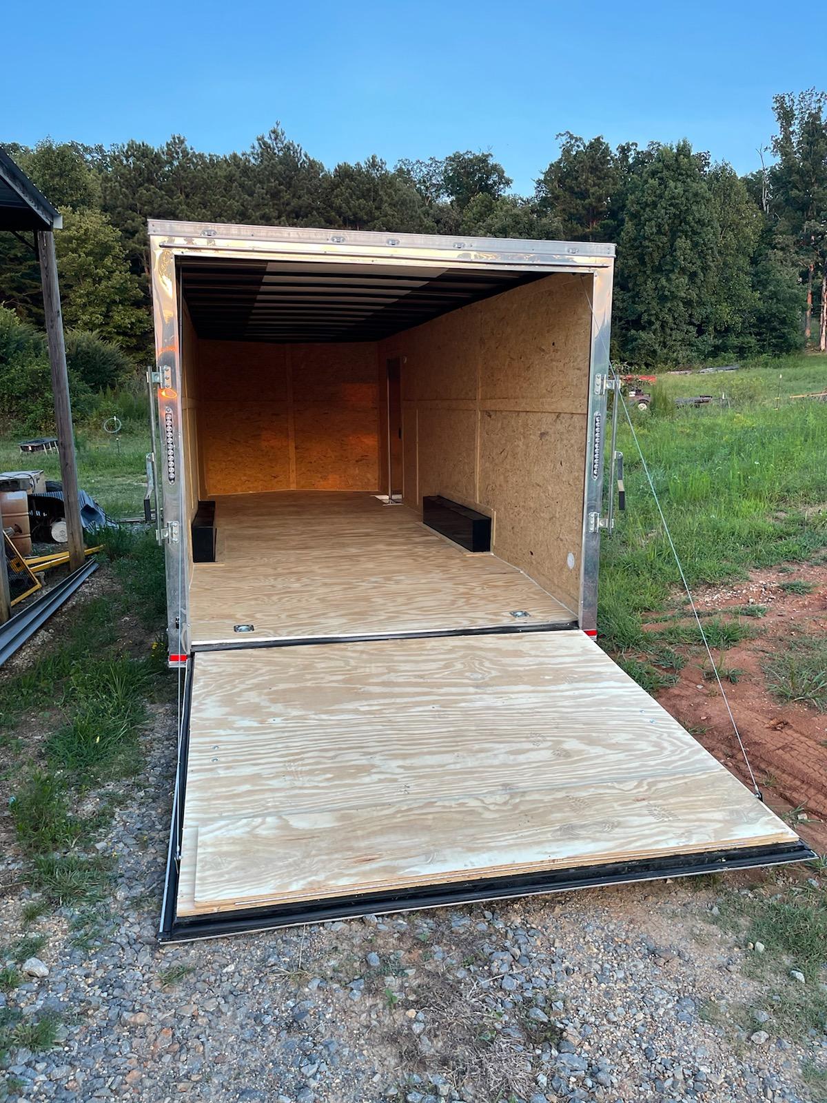

Finally got an enclosed trailer always wanted one. After all the drama ( see this thread for some information on the drame https://www.hardlinecrawlers.com/threads/enclosed-trailer-drama-what-to-do.62829/ ) i found one very close to what I waned.
24'
5200 lb axles with springs
7'6" interior height
went and got it and brought it home

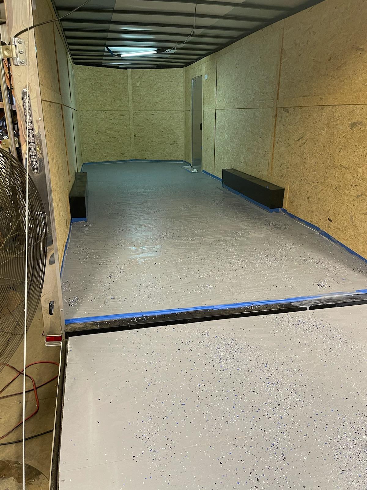

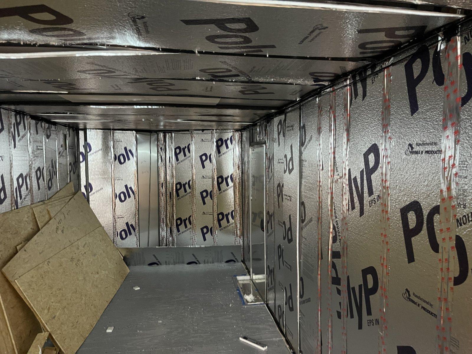

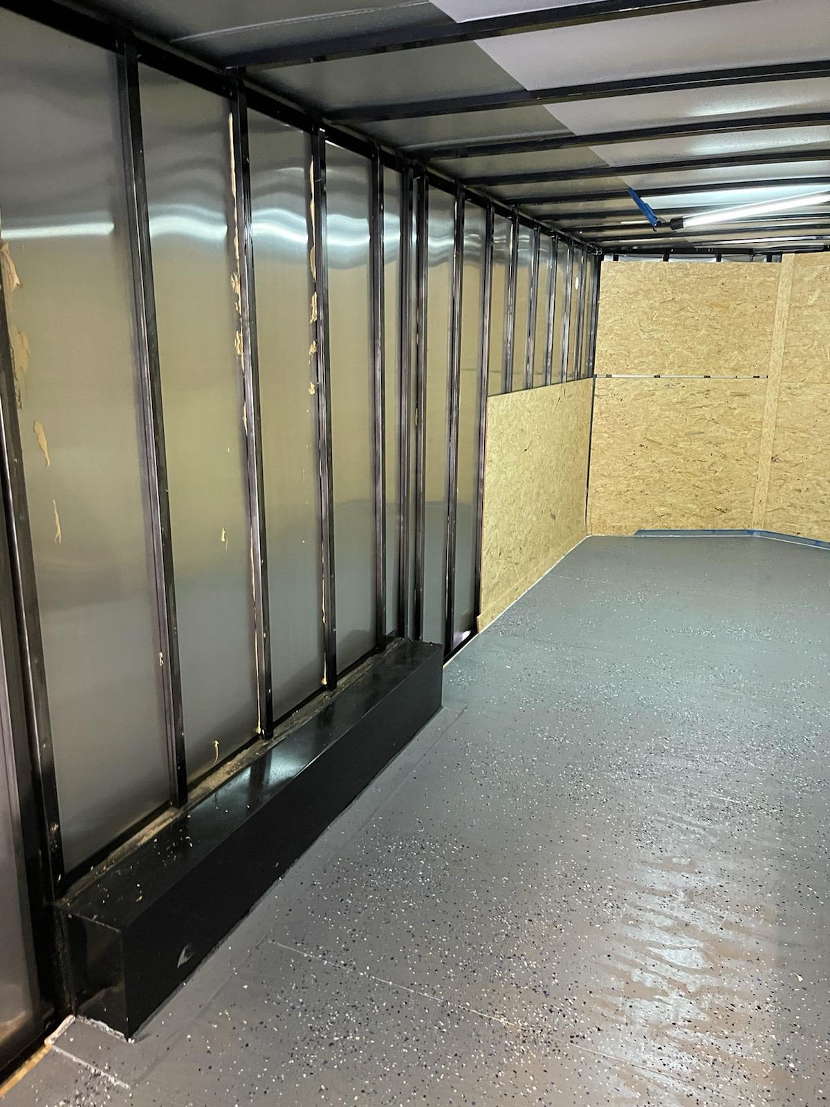

first thing I did was coat the floor with a garage floor epoxy from Rustoleum. My buggy leaks to much for it to be bare wood. After that pulled one of the walls down and started insulating. Should get that one finished up tonight and put back together and start the other side.
That's all i've had time to get done, but hopefully get it done before labor day.

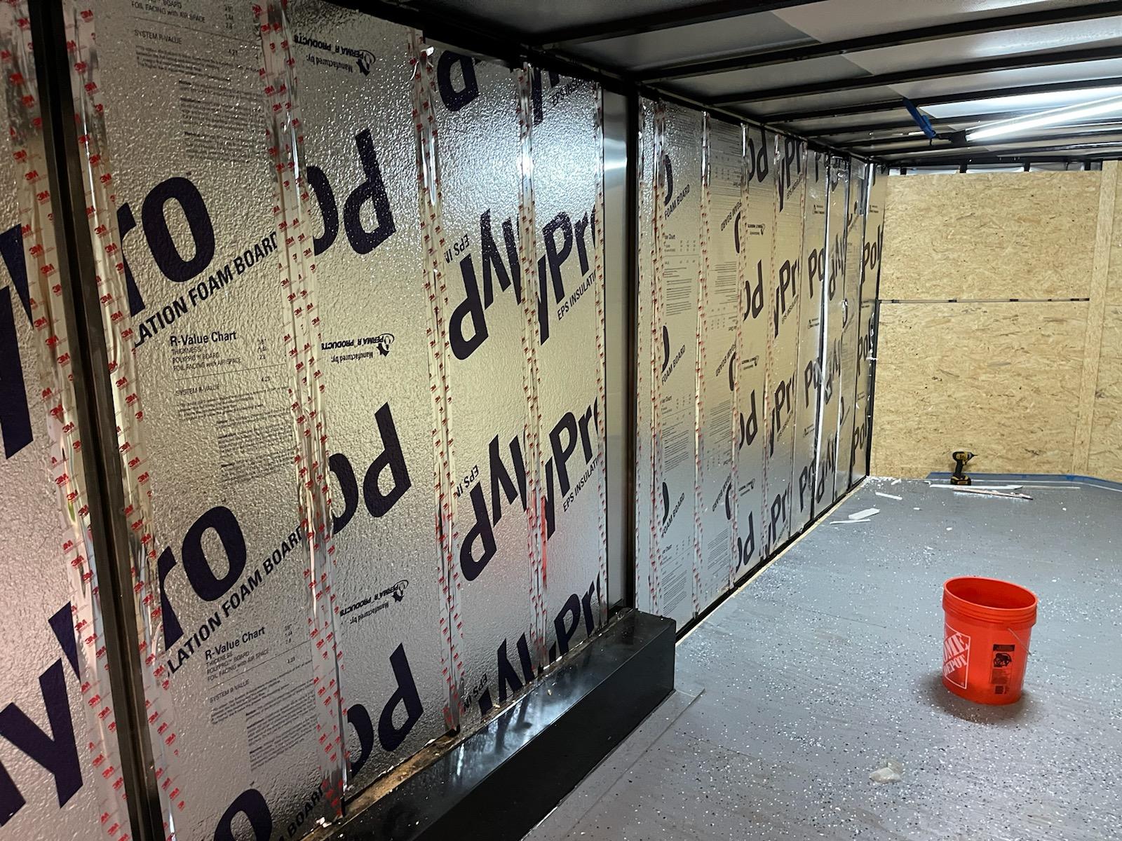

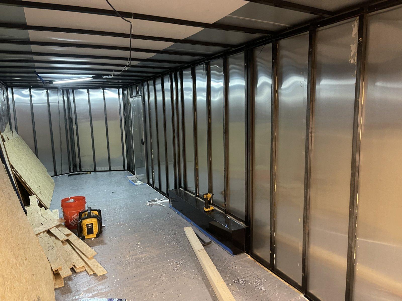

Got the other side stripped down to studs tonight. Also after doing some of the finest googling I went and bought a dometic roof top unit after work. Camping world had them on sale. Ordered a vent and more tie downs and lights. Those should be here Saturday or Monday. I am going to add a window or two just might be a few weeks down the road. Trying to make Labor Day with at least ac and insulated walls.
Looking good. Make sure you weld in a frame for your roof mount. Basically just want to box in a rough opening out of square tube. If you don’t, it won’t have anything on the sides to “pinch” to make a seal. It also helps brace the ceiling for the weight. Probably not the best explanation but maybe you get what I’m saying.
