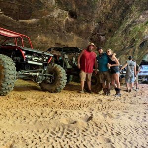

For those of you that have a buggy. What are you using for head lights and how do you have them mounted?
This is what I have

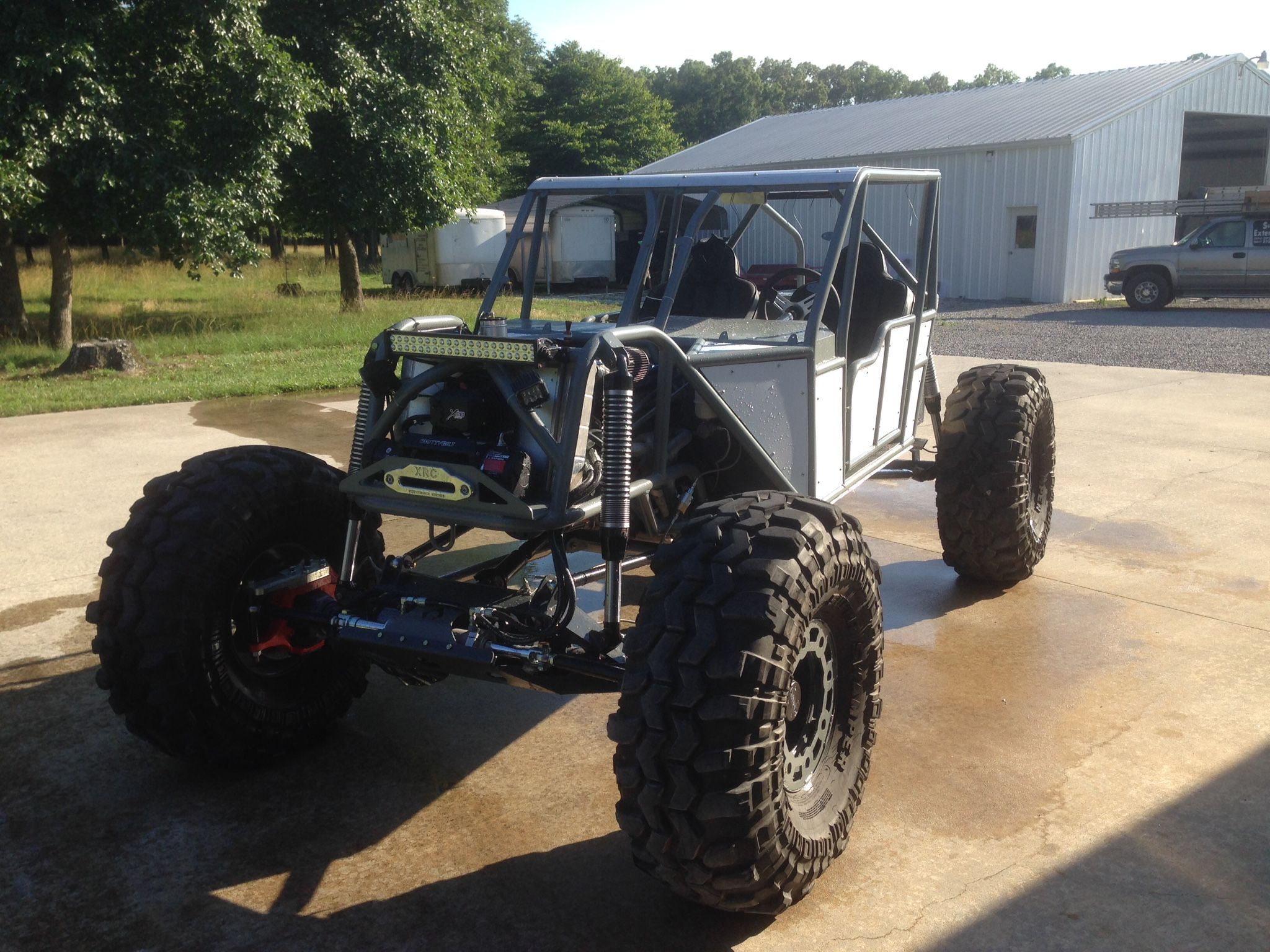

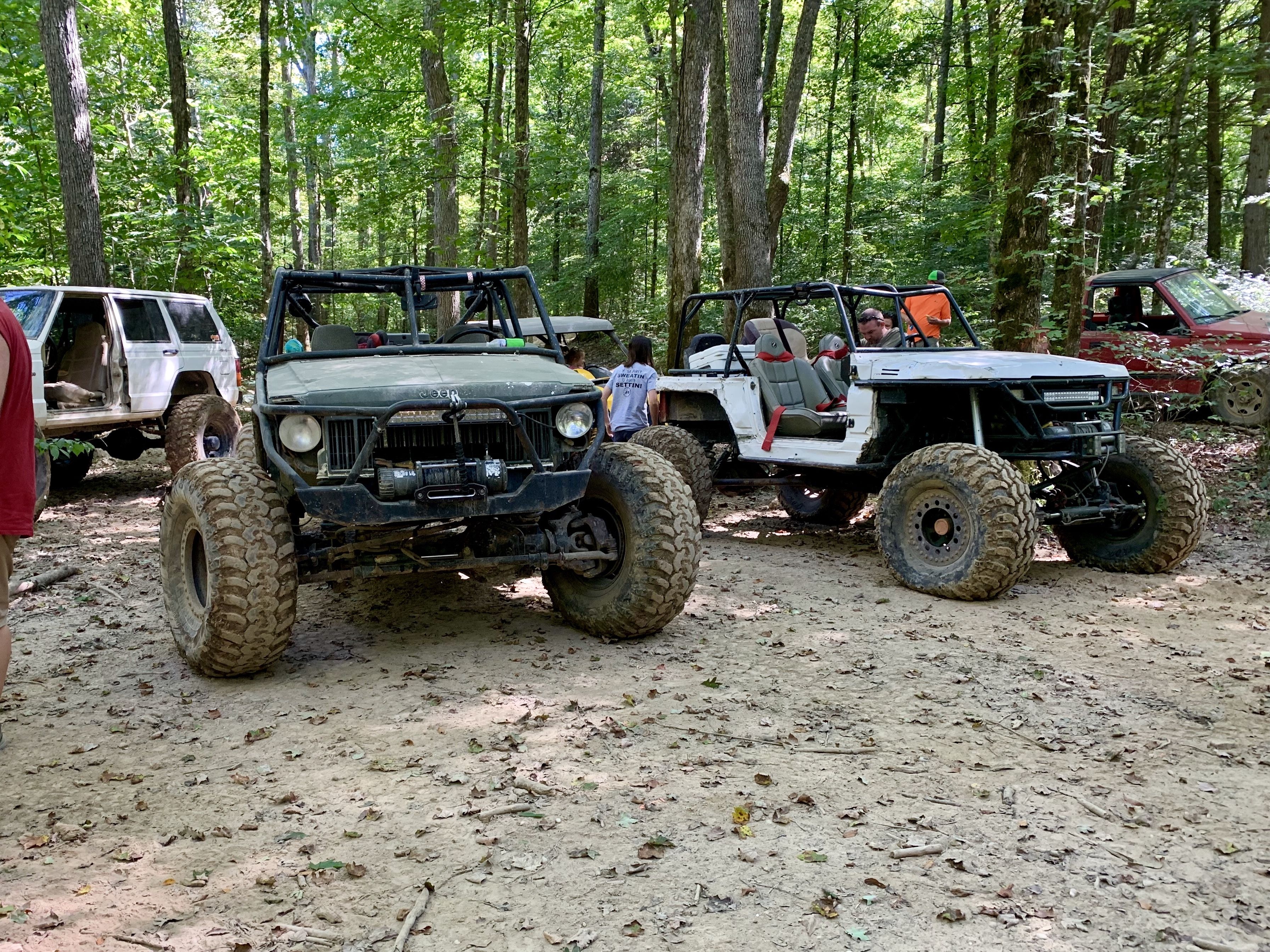

I'm not exactly a buggy. But it's 50/50. 20" lightbar. 2 piaa halogens as the actual headlights. All of which were yard sale finds. Lol

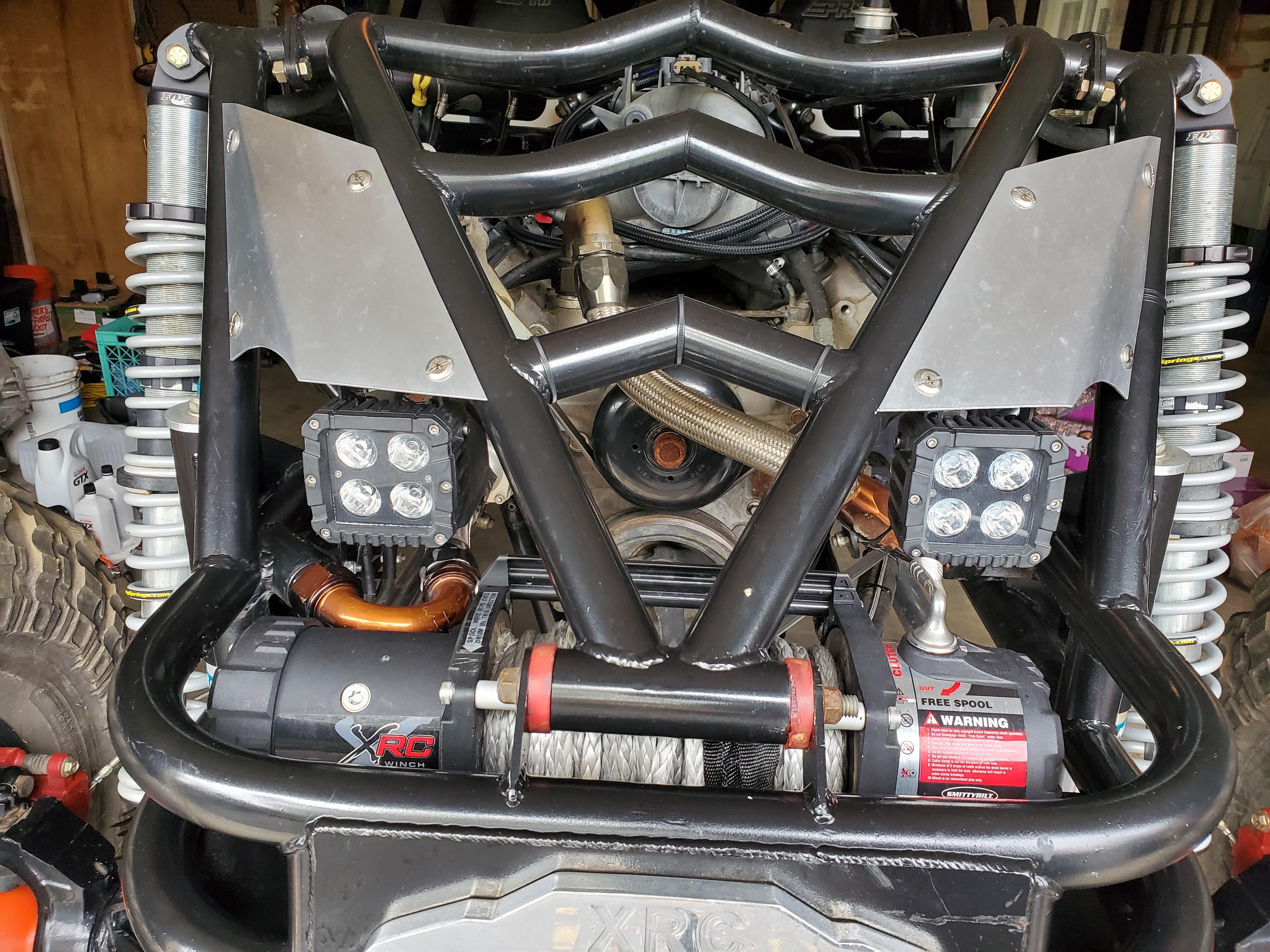

I run a couple of cube led's for headlights but they're not the least bit friendly to oncoming traffic. I find that my rock lights are still plenty to be able to see until can switch the brights back on.

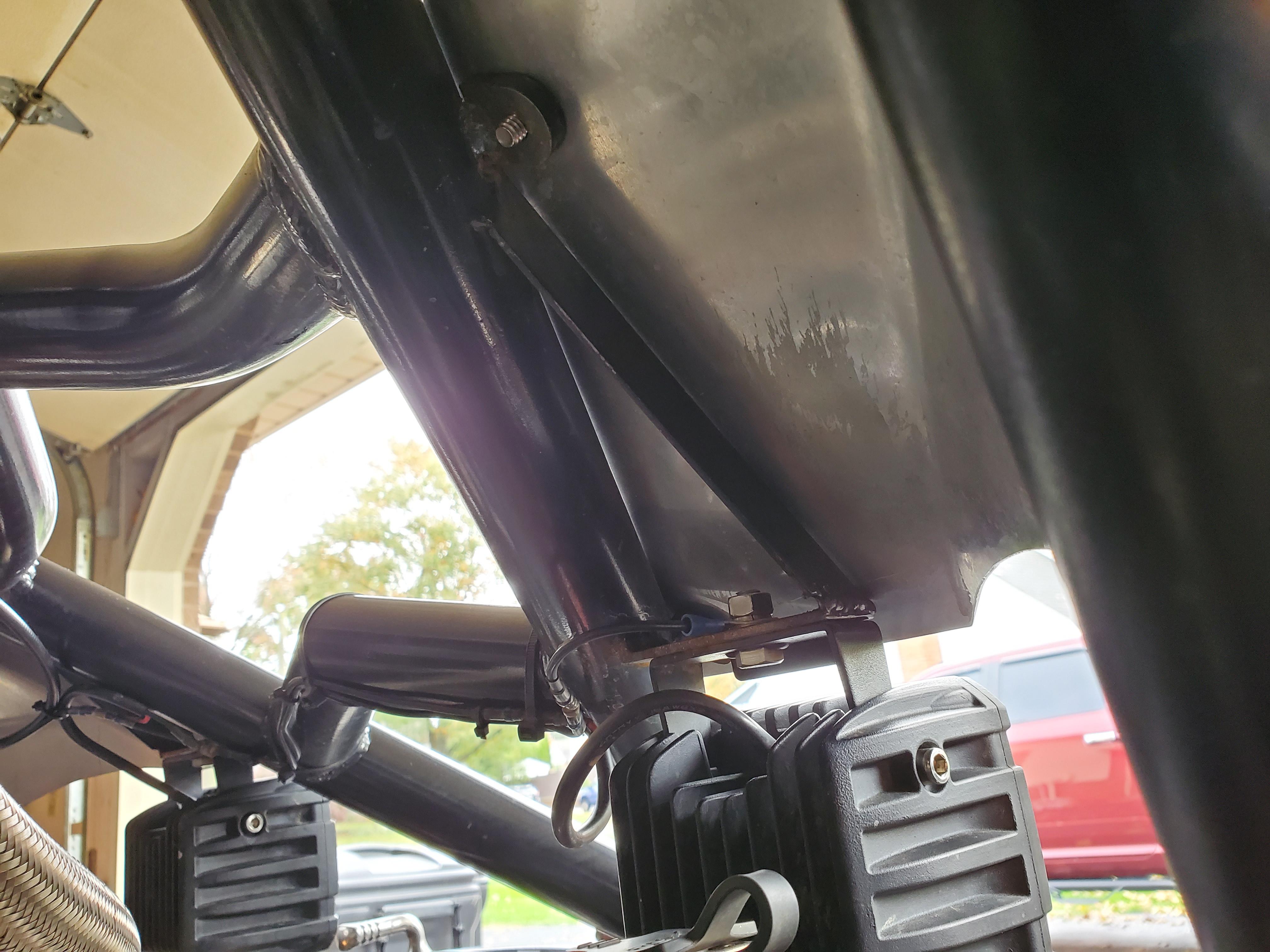

I have a $13 pair of Ebay headlights (mounted similarly to @Beerj) and a $free.99 light bar up top. The headlights are great for driving on the road, but are not bright enough for night wheeling. The light bar is bright, but on my rig, the light reflects off the aluminum hood, and causes minor visibility issues through the scratched up plexiglass. I am happy with them for the minimal amount of money I have into them.

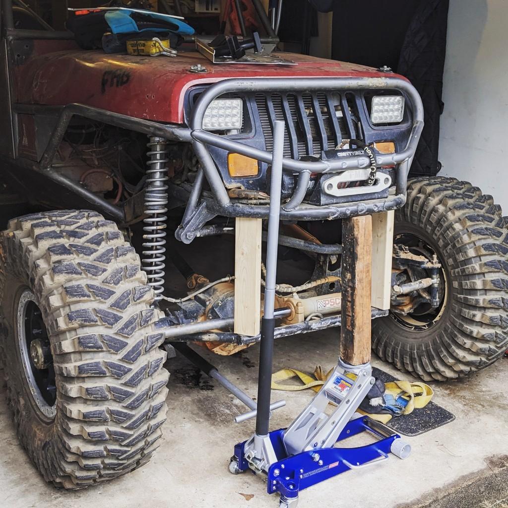

I found some rectangle 4x6 lights for my yj when I cut up the front. Either Amazon or eBay. They have a T pattern low beam and full high beam. Plugged into my existing headlight plug but would be easy enough to custom wire to a switch, I just left the headlight harness in place. Mounted on a tab on the shock towers.
