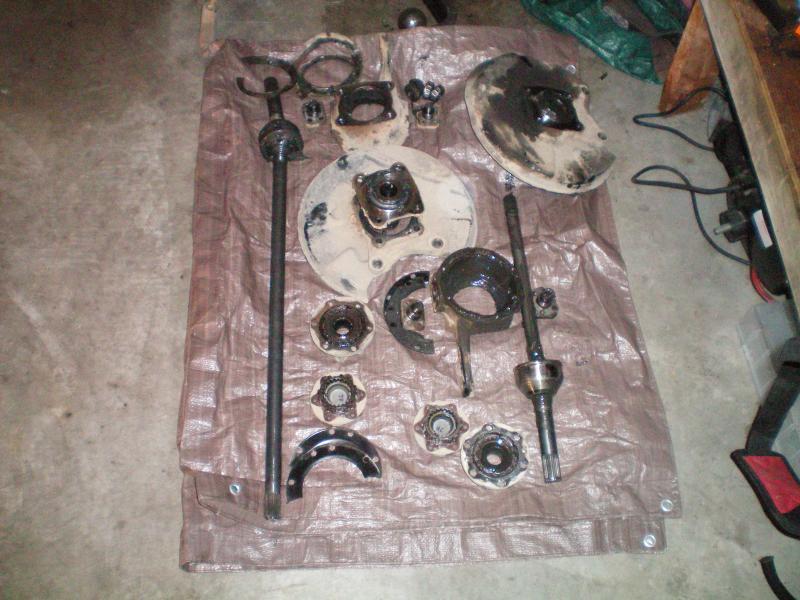

So I bought it with a bent front housing. Fordzuki stepped in and Gave! me a front housing, Derick I owe you one:awesomework:
So the gf was watching American Idol this evening and that was all the motivation I needed to go out to the garage and tear the front end out. Gonna take the pieces to work and put them in the parts washer to make them nice and purdy for reassembly. Its funny how small stuff is compared to Toyota.

why tear the front axle apart? it wasnt broke was it?
You will be in there soon/often enough as soon as ya start wheeling it.
Derek's a great guy :awesomework:. Hopefully I can get some time off this summer and join you out on the trail and see how well those things do with little work.
