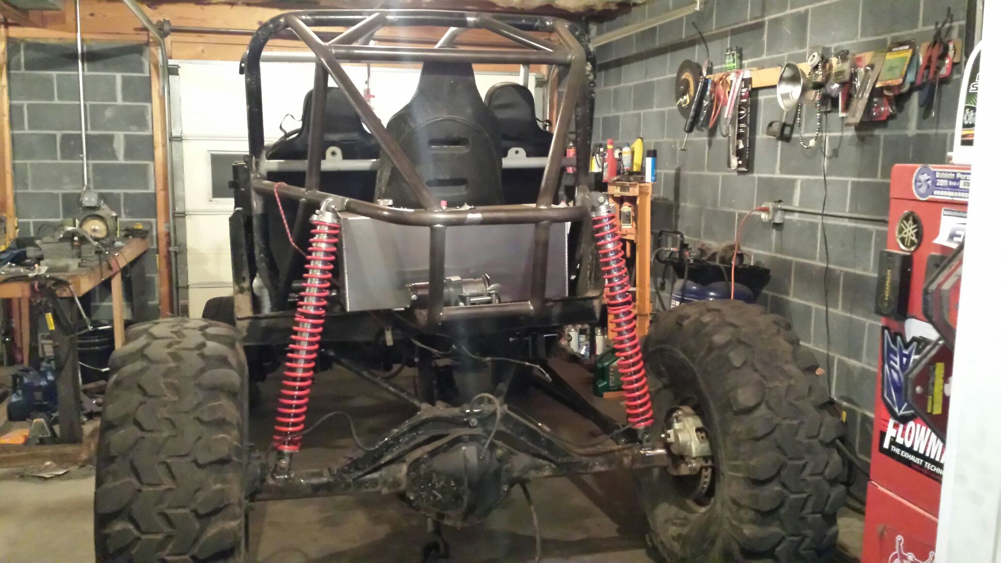

I am in the process of building another juggy. Last one had air shocks in the rear so ride height was easily adjusted but now I set this one up with 16" coilovers. they are 2.0s with 16" 200lb lower springs and 14" 150lb upper springs. It sits about 4"s higher than I wanted and its adjusted all the way out. I was shooting for about 4-5" uptravel. The suspension is pretty stiff also. what should I change? upper or lower spring and what rate should I switch to?
