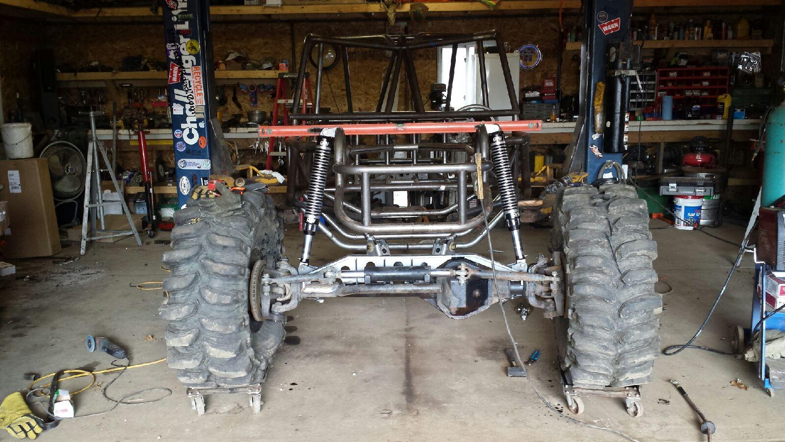

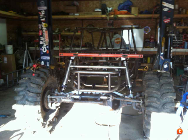

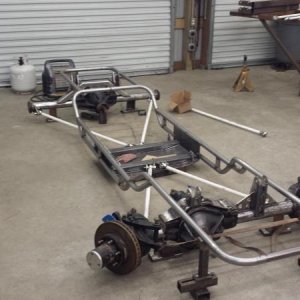

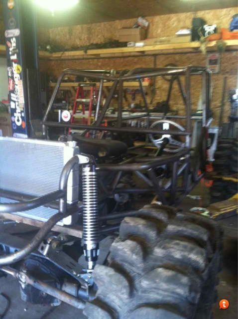

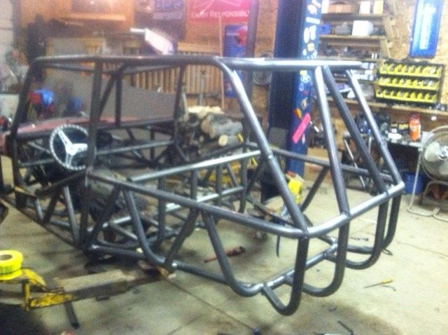

ok so I will start with this I picked up a chassis from the other side of the state (Michigan) it was built a few years ago as a 2 seater and had been passed around like a whore with everyone changing a little bit about it but it never got finished.
well I picked it up for really cheap and wanted to make it my own so I cut it all apart to make it a four seater.

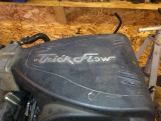

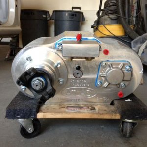

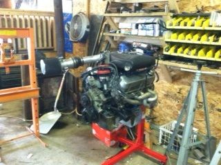

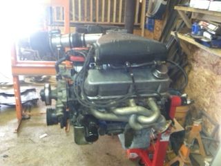

I have a 92 mustang motor that I picked up from a friend he had over $9000 in to it and I picked it up for $1000 and a running stock motor. so I went and got the 347 stroker kit for it and will be having that built by one of my good friends in the next few week. behind the 347 will be a built c-6 with a behemoth drive line doubler and a twin sticked 205 . all will shift by billet aluminum cable shifters. should have a 5.7-1 low low range :driving:

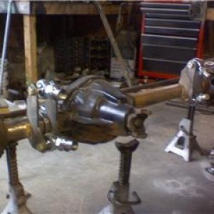

I will be running a built ford 60 front with 5.13 gears chromolly shafts and full hydro with a shaved 14bolt rear . both will have artec trusses and four linked.
im running 16 ori sruts in the front and 18s in the rear with all my links being 7075 aluminum 2.5 inch. it will have 1.25 hiems and a belly pan made of 1/4 inch aluminum and cutting board material

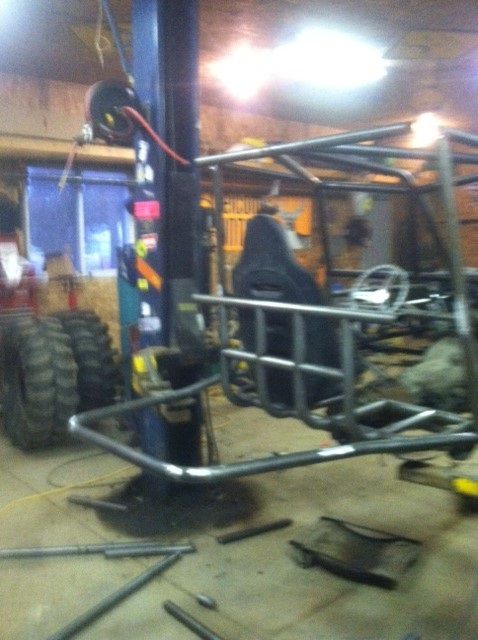

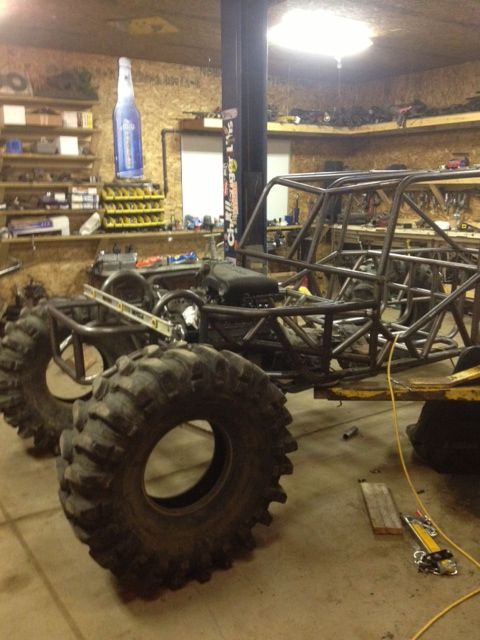

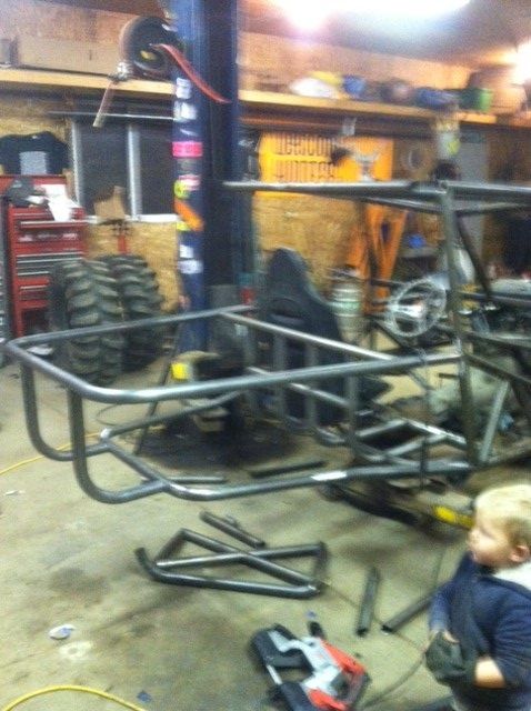

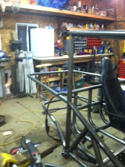

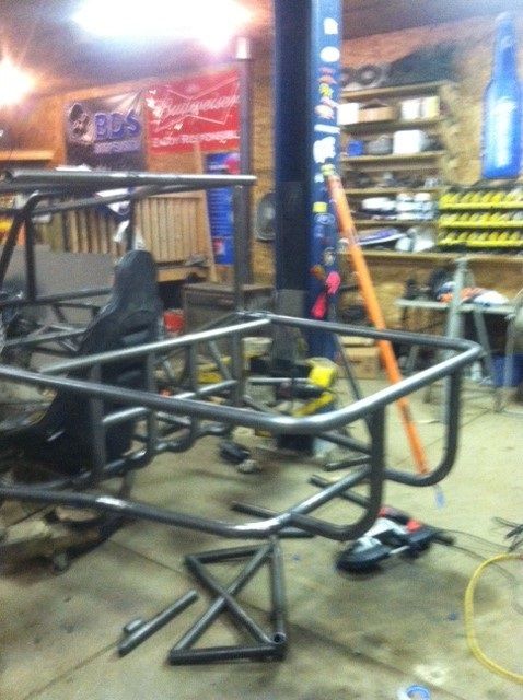

ok so one of the first things I did was cut all the tube of the rear of the chassis .

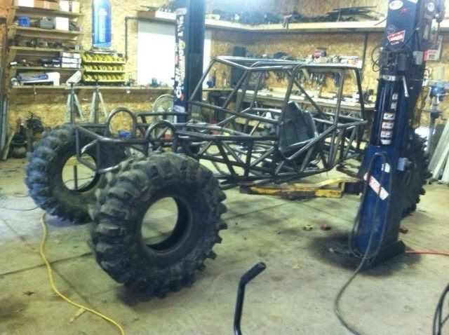

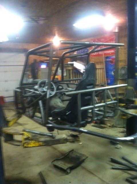

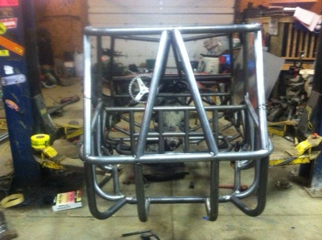

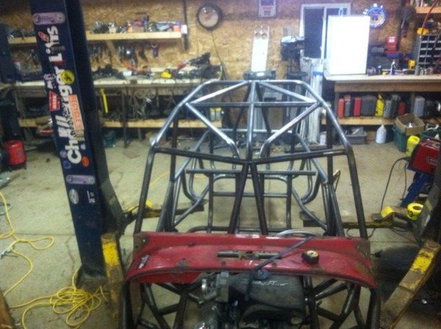

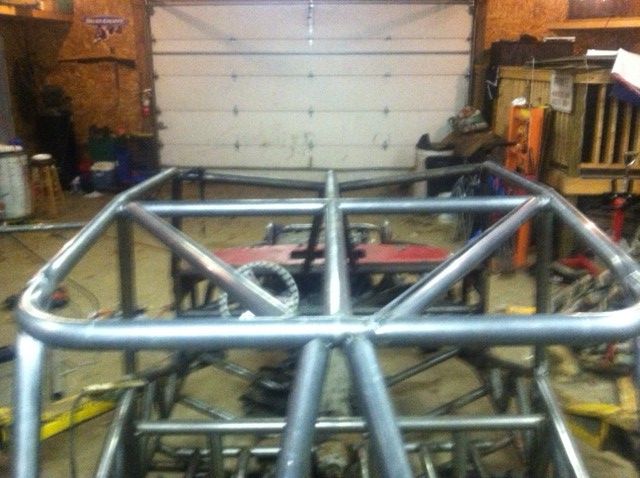

on with the progress picks!

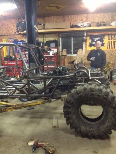

and more

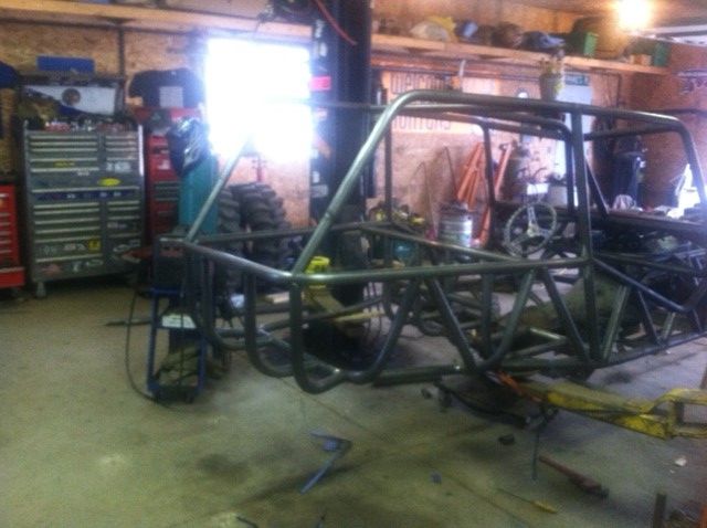

ok im trying to get up to dat then ill post as things get done but here are some from last weekend. keep in mind this is my first time trying to build a true buggy lol

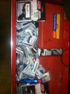

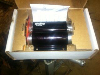

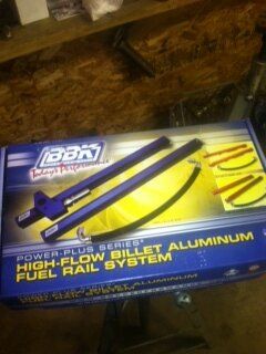

igot some more cool stuff!
