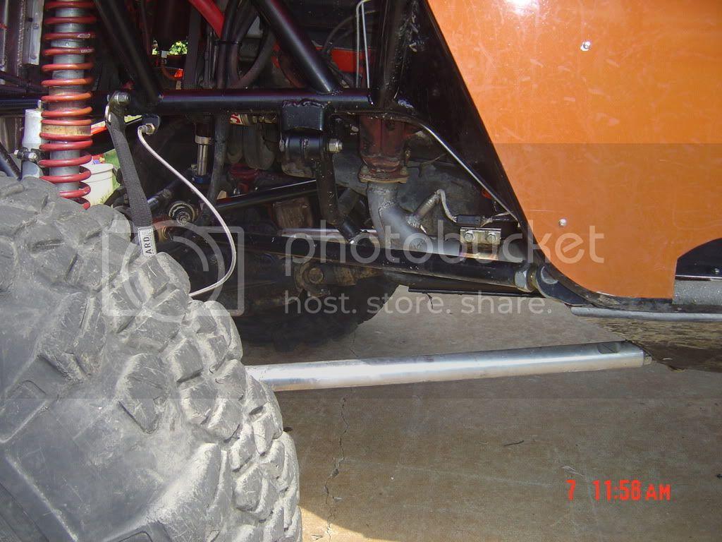

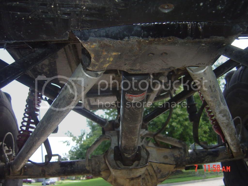

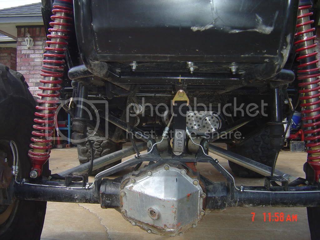

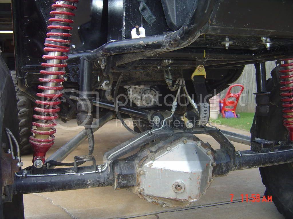

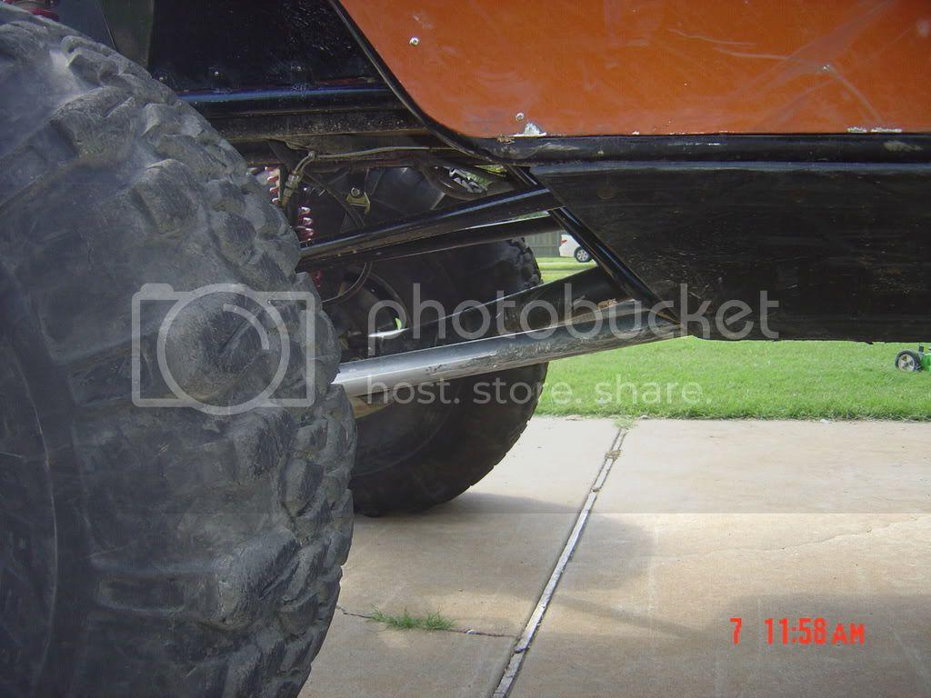

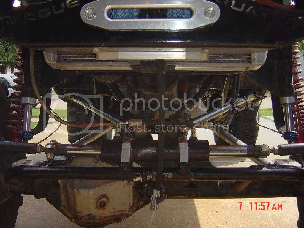

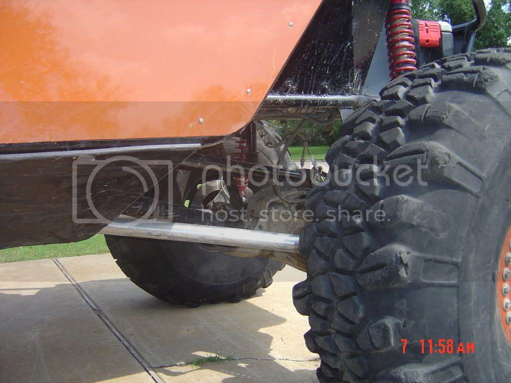

Sometimes when I am getting on it to climb a hill with a ledge that I have to bump/bounce over, it starts a chain reaction of bouncing that SUCKS! I will post a few videos of what I am talking about and pics of my 4-link. I run SAW coilovers with stock valving. I run about 5 psi in the rear tires and 6 in the front.
I watch videos of the southern boys and alot of them take the initial hit and then the rear tires plant and either dig or hook up, but don't bounce like they are on leaf springs.
Do I need new valving in the shocks to slow down the rebound and/or compression?
Do I need to change my 4-link?
Do I need to get a tire with less sidewall flex?

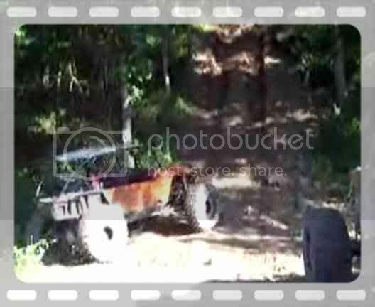

Video of Rollover Hill at Disney. The beginning shows it very clearly, but worse than normal:
http://www.youtube.com/watch?v=3uOkmXul0LY
Video of 6A at Falt Nasty (T.C. popped out of gear 4 times):
Pics of the rear Suspension...

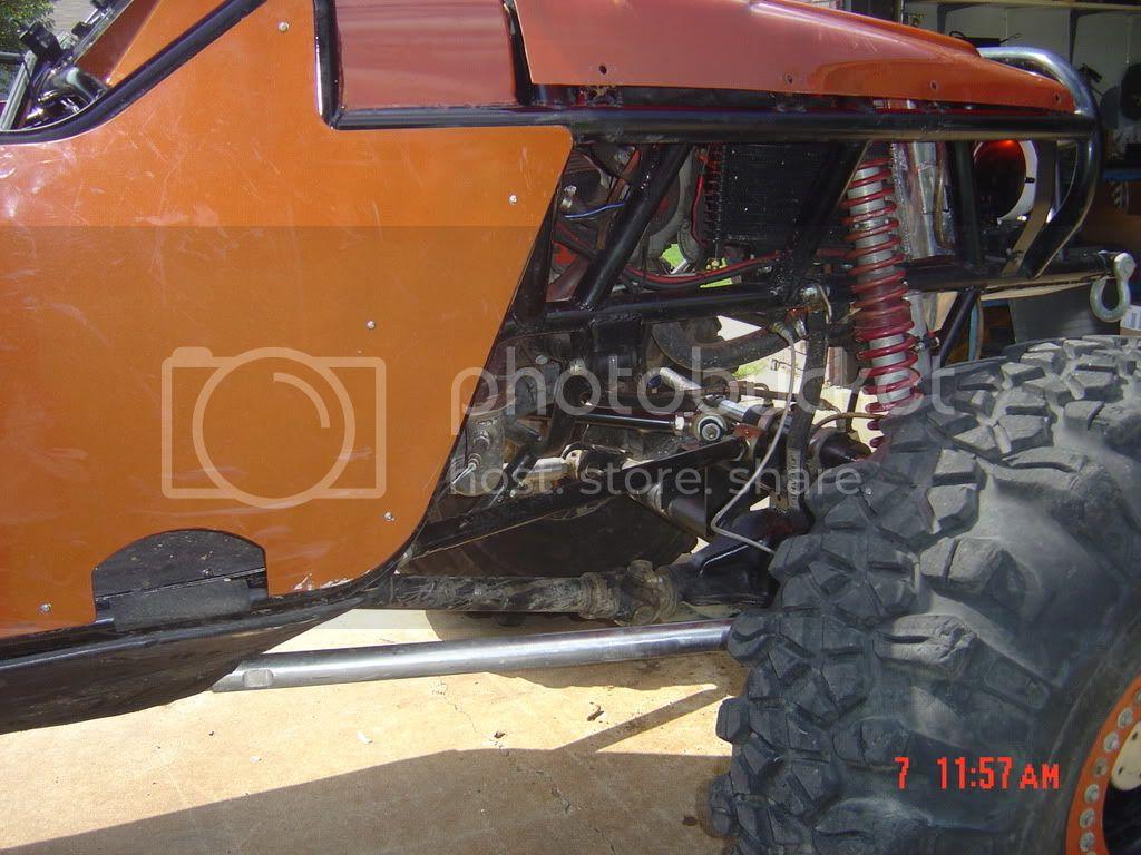

Front (if it matters?)....
