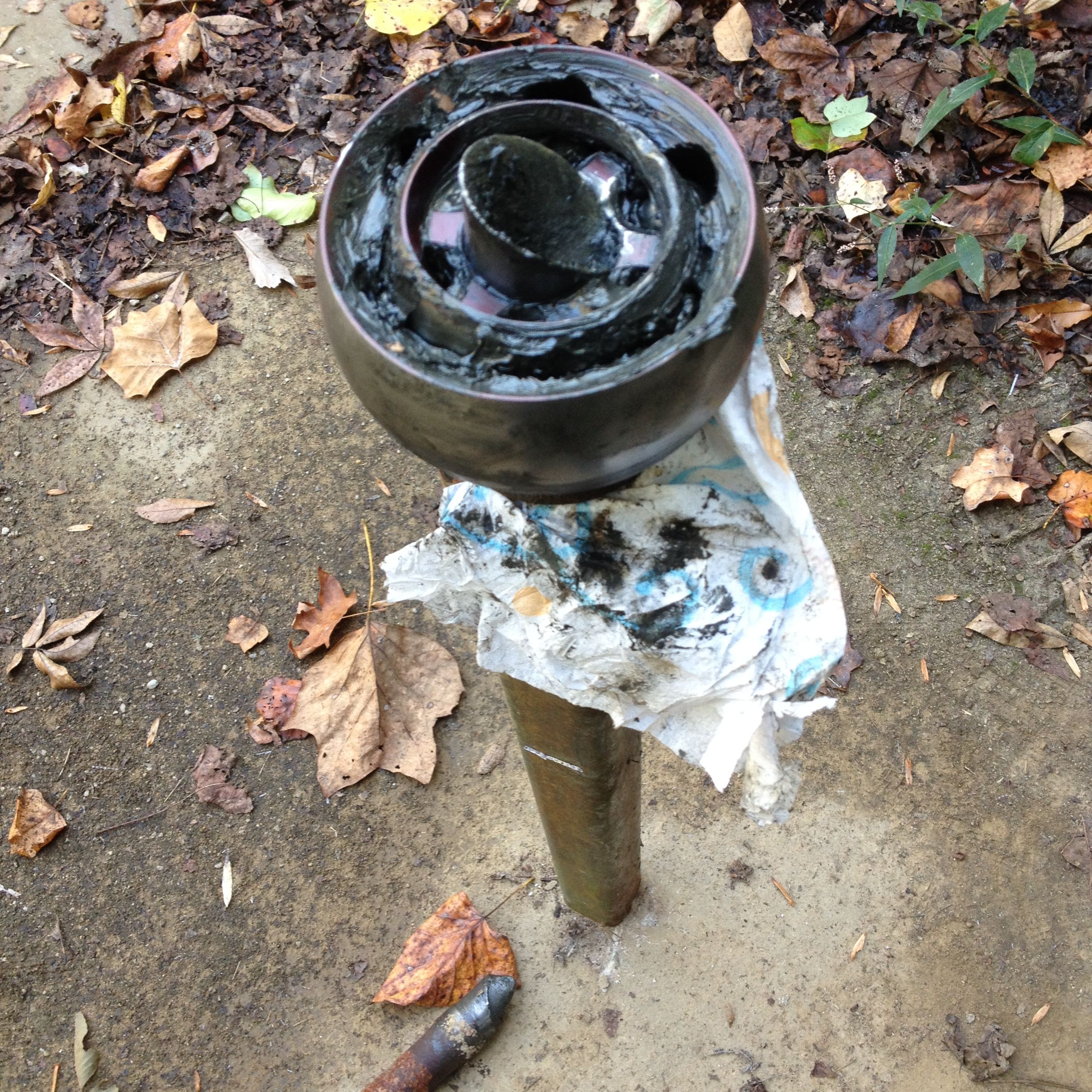

I need some advice on how to remove the broken shaft. It is the inner and i cant get the stub out to tap it out.
Maybe, I just figured there must be a trick i am missing.Can you weld something to it that'll let ya get a hold of it easier?
I will try that,if that want work i will attempt to weld something to it.I open the jaws of a vice enough for the stub to slide through but not the bell. Grab the stub with both hands and snatch as hard as you can from as far as you can and knock the bell off the stub. You can be pretty rough with them.
Ooooooorrrr, weld it to the vice!I
It has a snap ring inside the bell like a front wheel drive cv axle where it goes in the trans. I think you would have to get the broken piece out and get it from the inside. The vice trick has worked on mine every time.I could not get it using the vise. I dont know what snap ring Greg is taking about.
Still have not got it out yet. I have to go out of town for a few days but this weekend it is on.did you get it?
