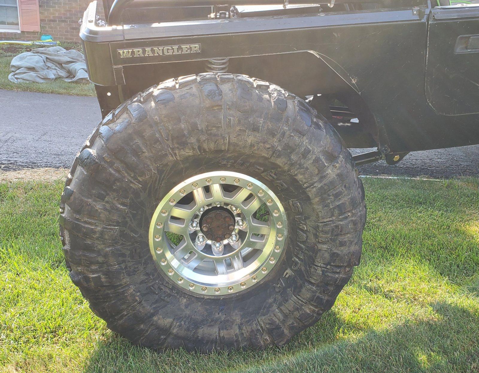

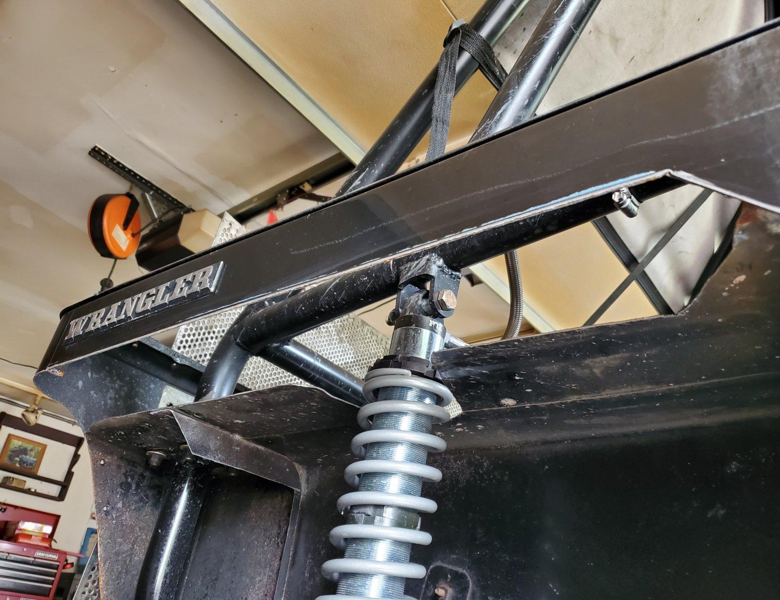

Nice build, how much uptravel did you end up with in the front?
Were you happy with Accutune's tune/spring rate? If you let them help you with that
Also, curious on the rear wheel tubs, did you end up raising them up? i cut mine up to the seam and they still cut my 43s but im pretty low
Beerj
Sonzabitches!
Dec 7, 2014
3,853
Amish Country
It's sitting at 6" uptravel right now. That's with the minimum ½" preload on the springs. Their rates were a little off the first time. Better after the swap but I still feel like the front uppers are a touch light. They were very much against me running a 150/150 on the front for some reason and by then, it was too late to swap since it was already wheeled. Valving seems fine though but to be honest, I've barely driven it. It's the wifes rig. Fwiw, accutune set up the shocks on my buggy and rates were spot on, even without weighing it. Just went off of similar buggies they've done in the past.
As far as the wheel wells, I cut them really high. Had to go above the top of the wheel well and that gave me a little more than an inch of clearance but I wanted to account for new tires without needing to redo them.

Nice, im hoping for 6 too. But did you have to raise the wheel tub higher to meet your cut line on the body? or just cut out the horizontal piece all together?
Beerj
Sonzabitches!
Dec 7, 2014
3,853
Amish Country
I cut out the half closest to the outer body. The plan is to just cover that with an angled sheet of aluminum but that hasn't happened just yet. Doesn't hurt anything being open like that, but would just give it a finished look.

Right on, thanks. kind of what i was picturing i didnt really want to get into dove tailing my junk
Beerj
Sonzabitches!
Dec 7, 2014
3,853
Amish Country
Yeah, I considered dove tailing it but this way clears and also would allow to still run the factory soft-top if it had a windshield. Could probably add a channel to the cage and run it that way too
