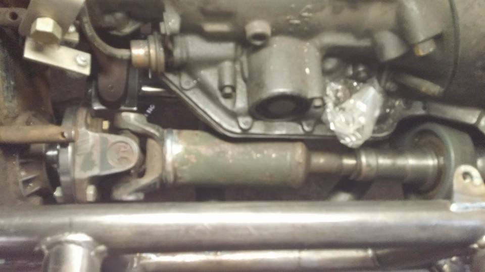

I used the pinion shaft out of a rockwell third for my front mid shaft. Turned it down to slip in two 1 5/8" pillow blocks. Used spacers between the blocks and the flanges. Bolts up to stock style rockwell driveshafts.
I thought about doing that on the buggy I'm building as opposed to buying one of the double yoke carrier bearings. I just didn't have enough room to make it work.
And the whole time I thought I had this brilliant, completely original idea in my head. Lol. Good job though, glad to see it actually done.
I like that idea but not sure if I will have the space either. Thanks for the picture gets me on the right track to start thinking on this.
Where did you get the double yoke carrier bearing? Thanks for your help.

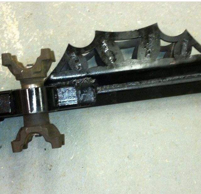

I stole this picture from a friends FB page, but mine is set up the same and I actually gave him the pillow block. Not sure where they came from but I had 2 pillow blocks that were just a little bigger than the O.D. of the female slip on a Rockwell drive shaft so I made a spacer/shim to make them a press fit.
A1-15/16 pillar block or 4 bolt flange bearing will fit a stock 2.5 ton yoke once you polish the paint of!
