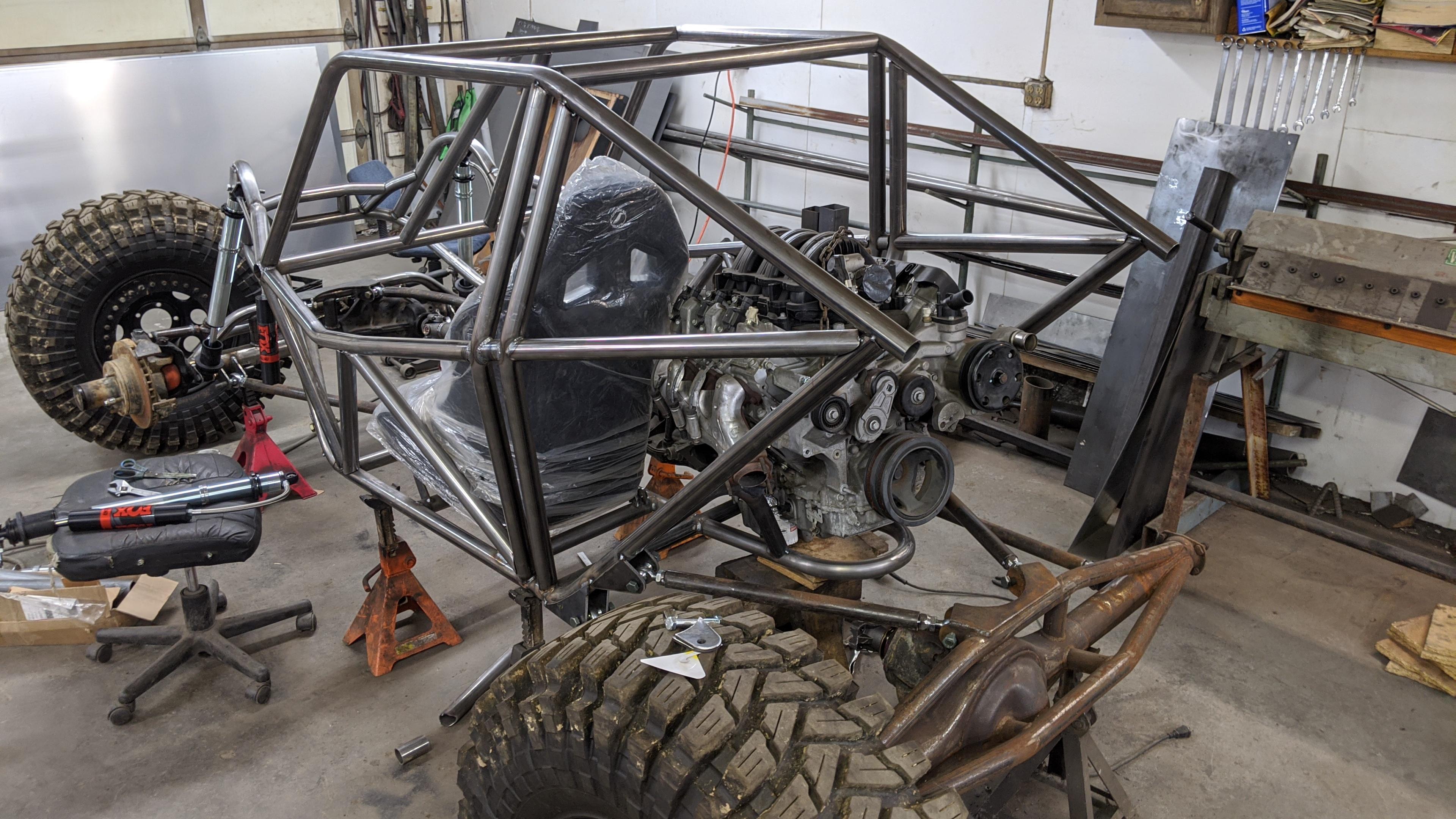

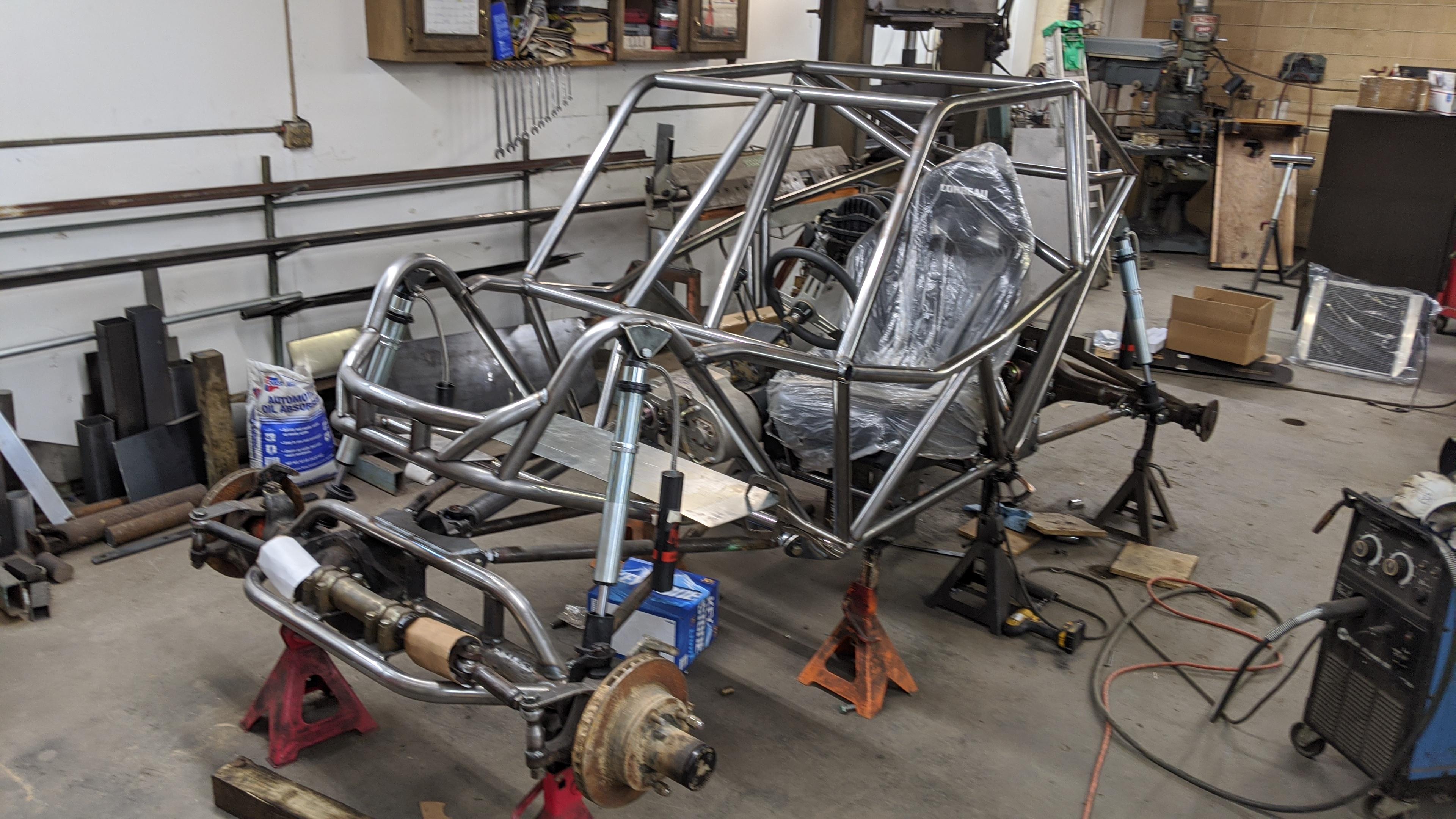

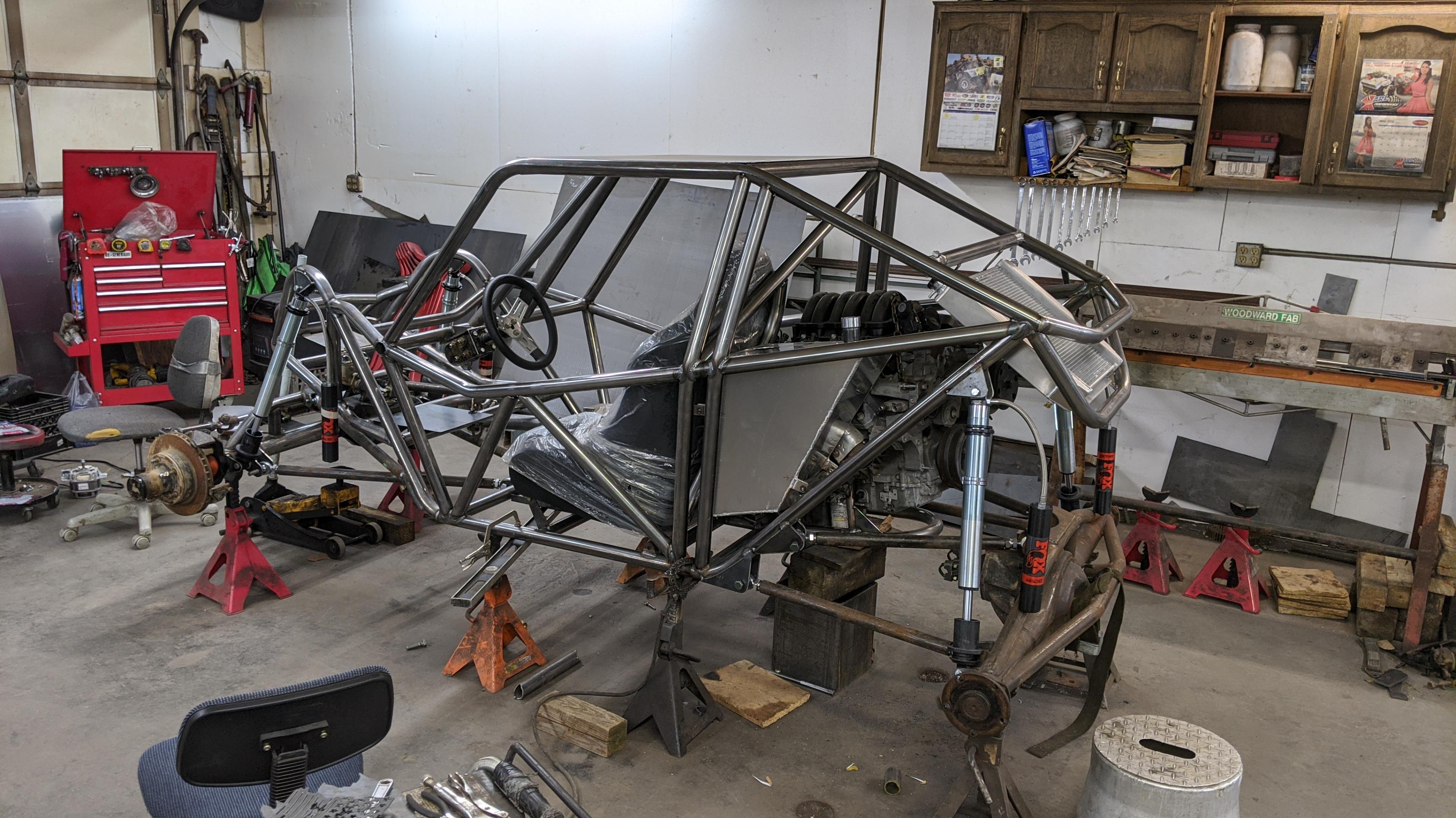

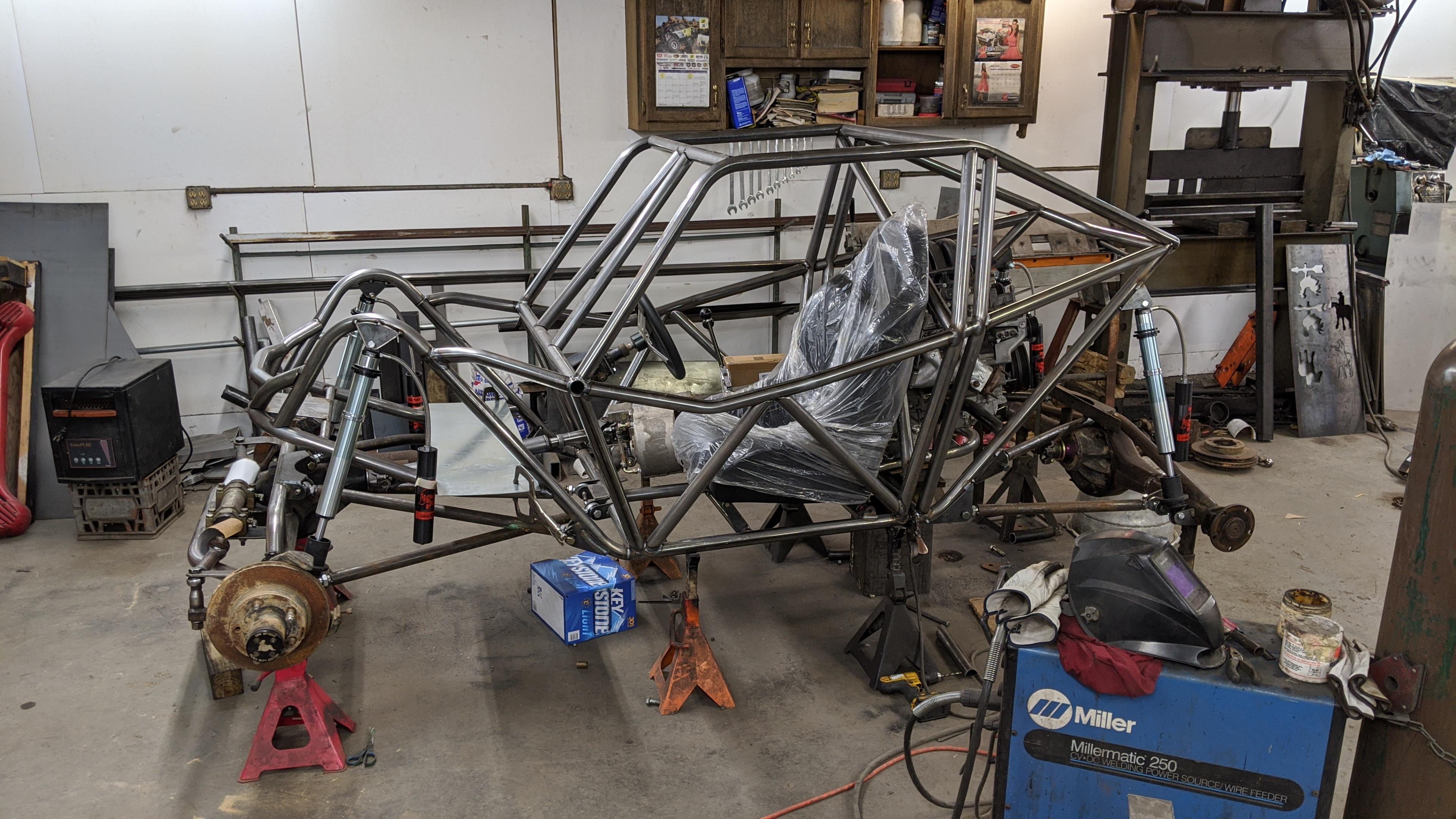

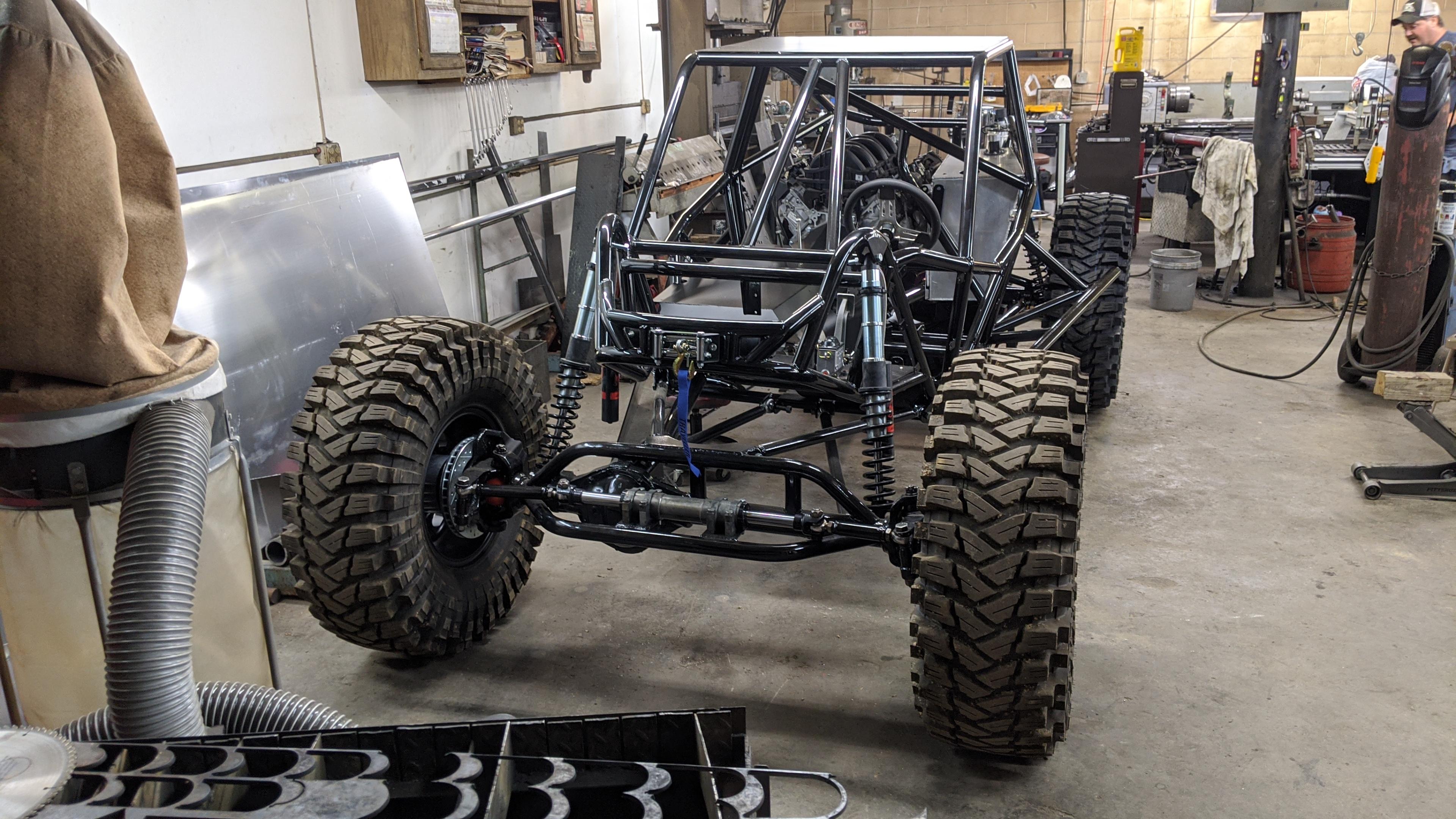

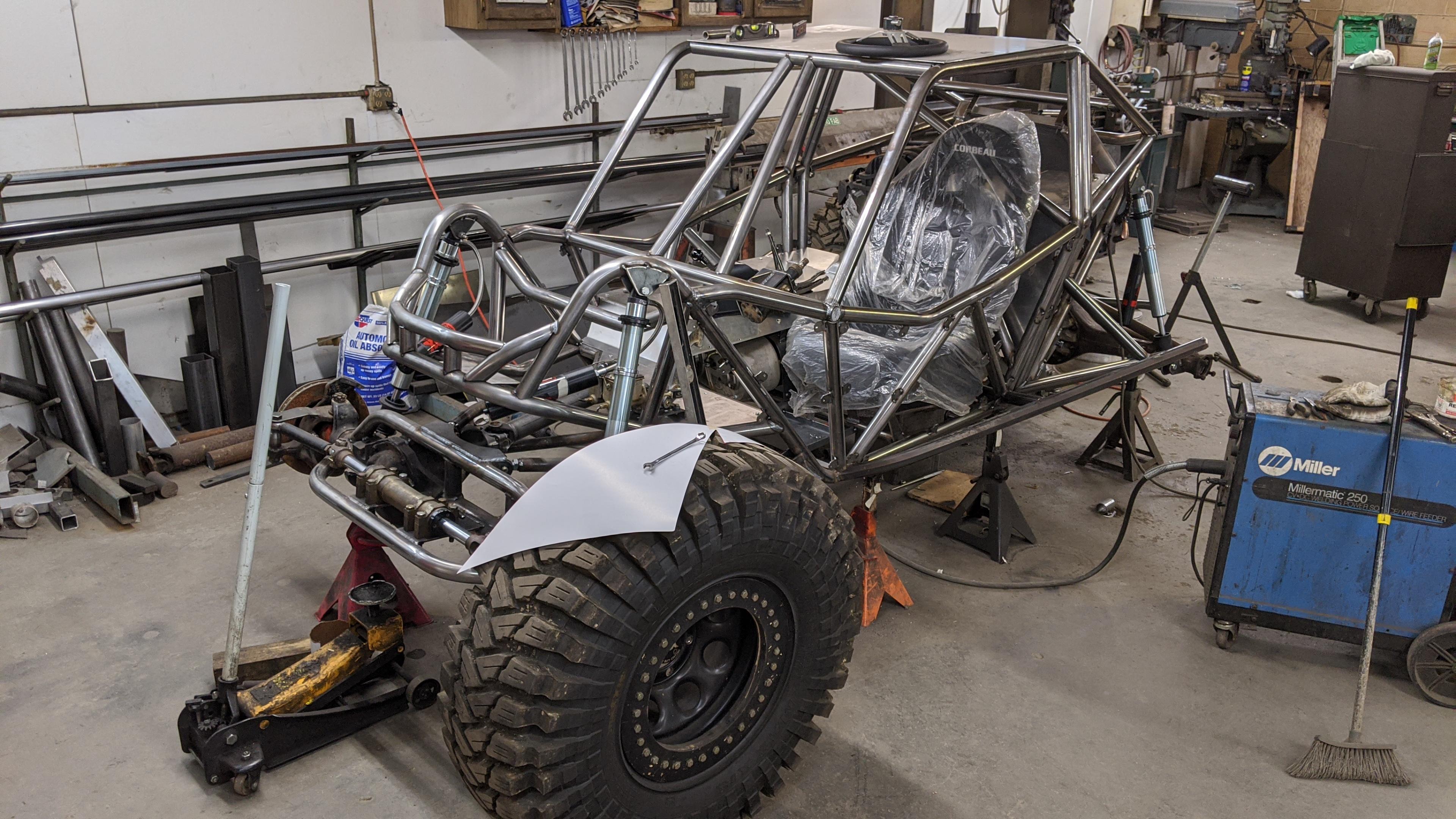

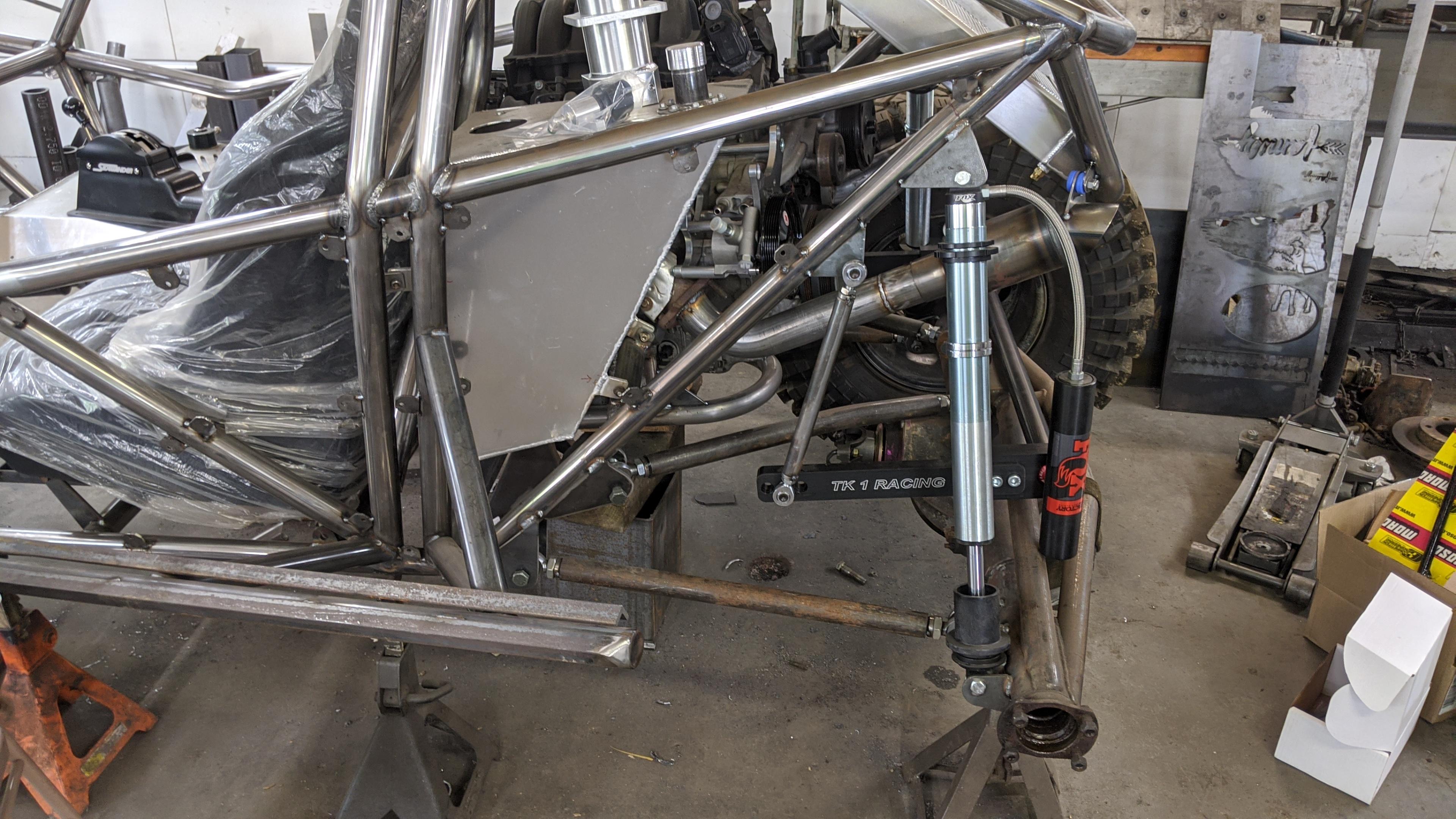

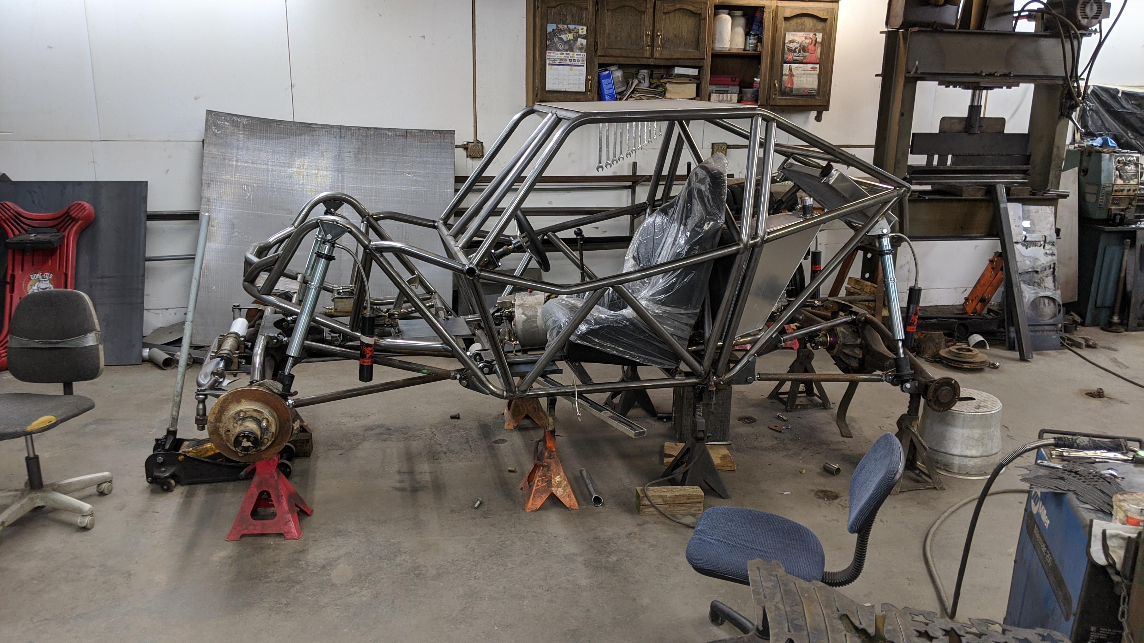

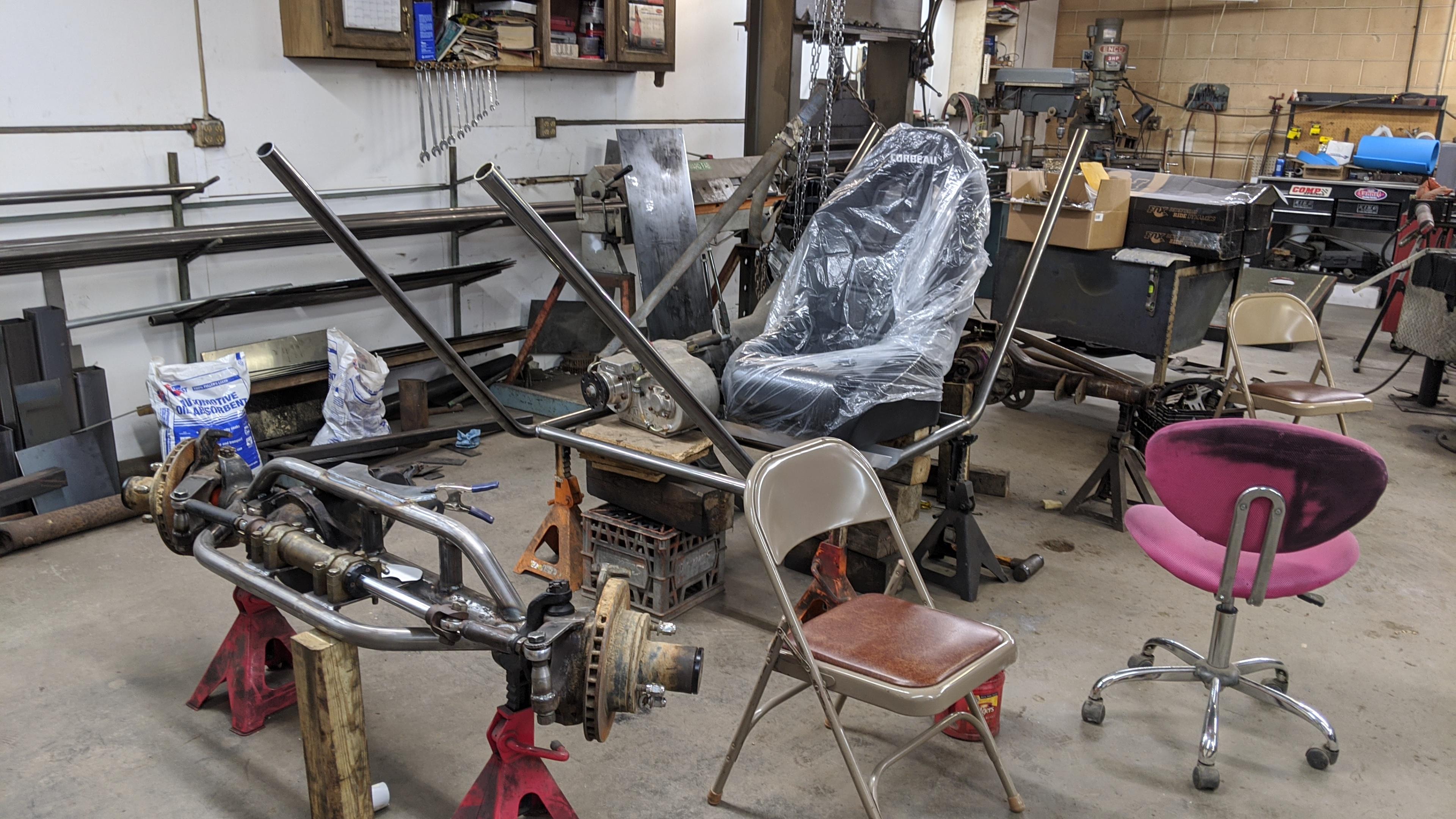

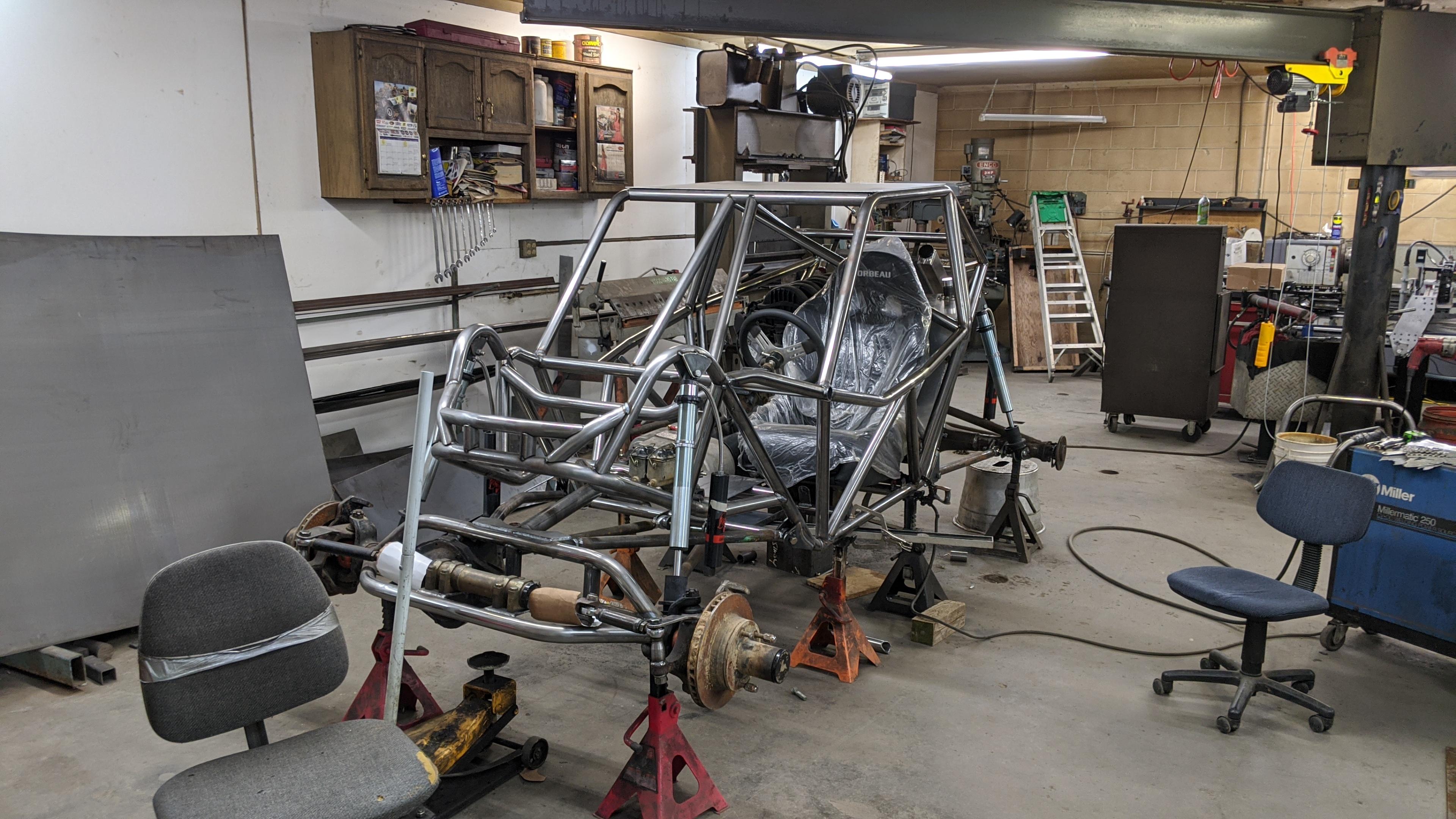

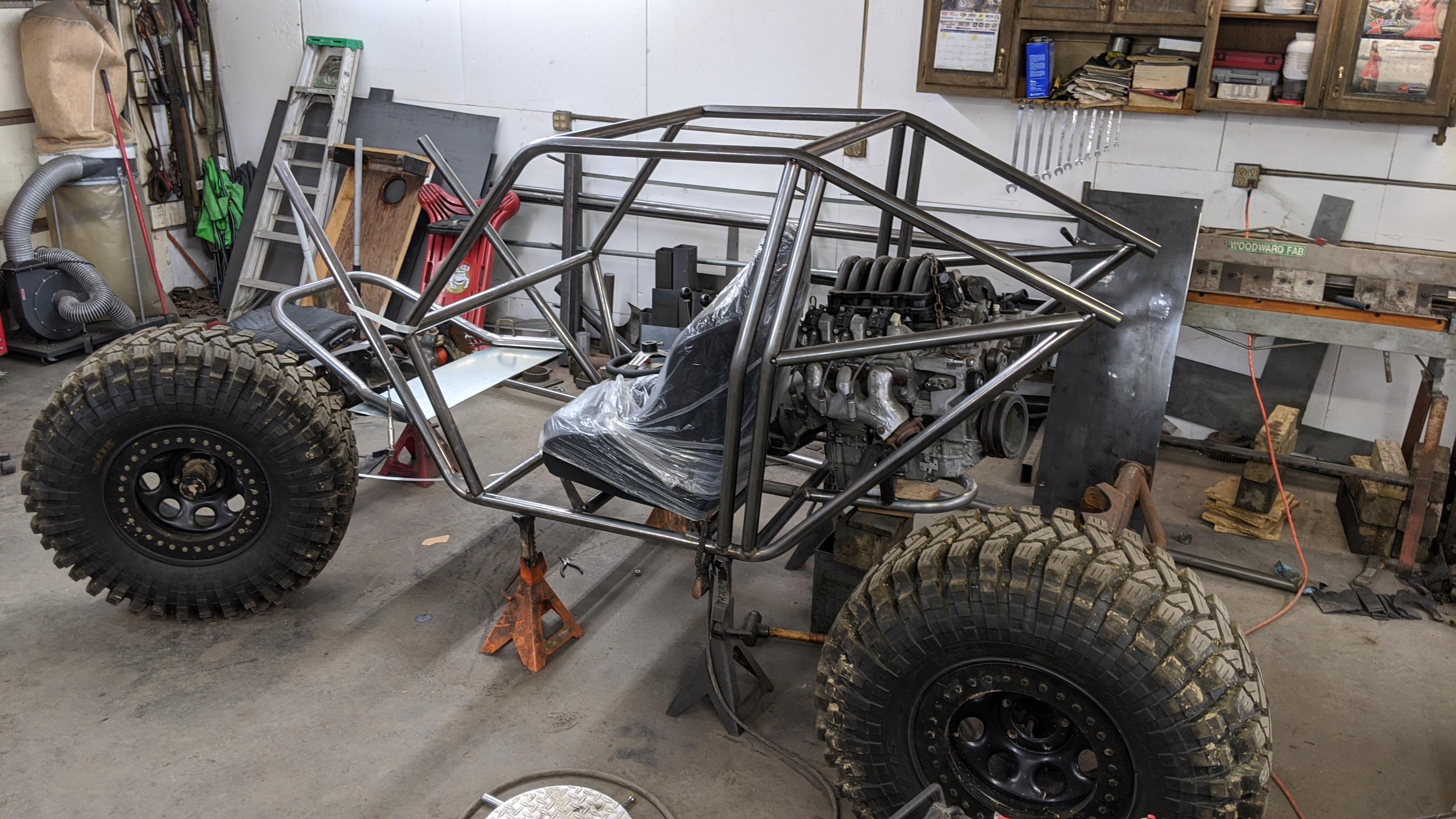

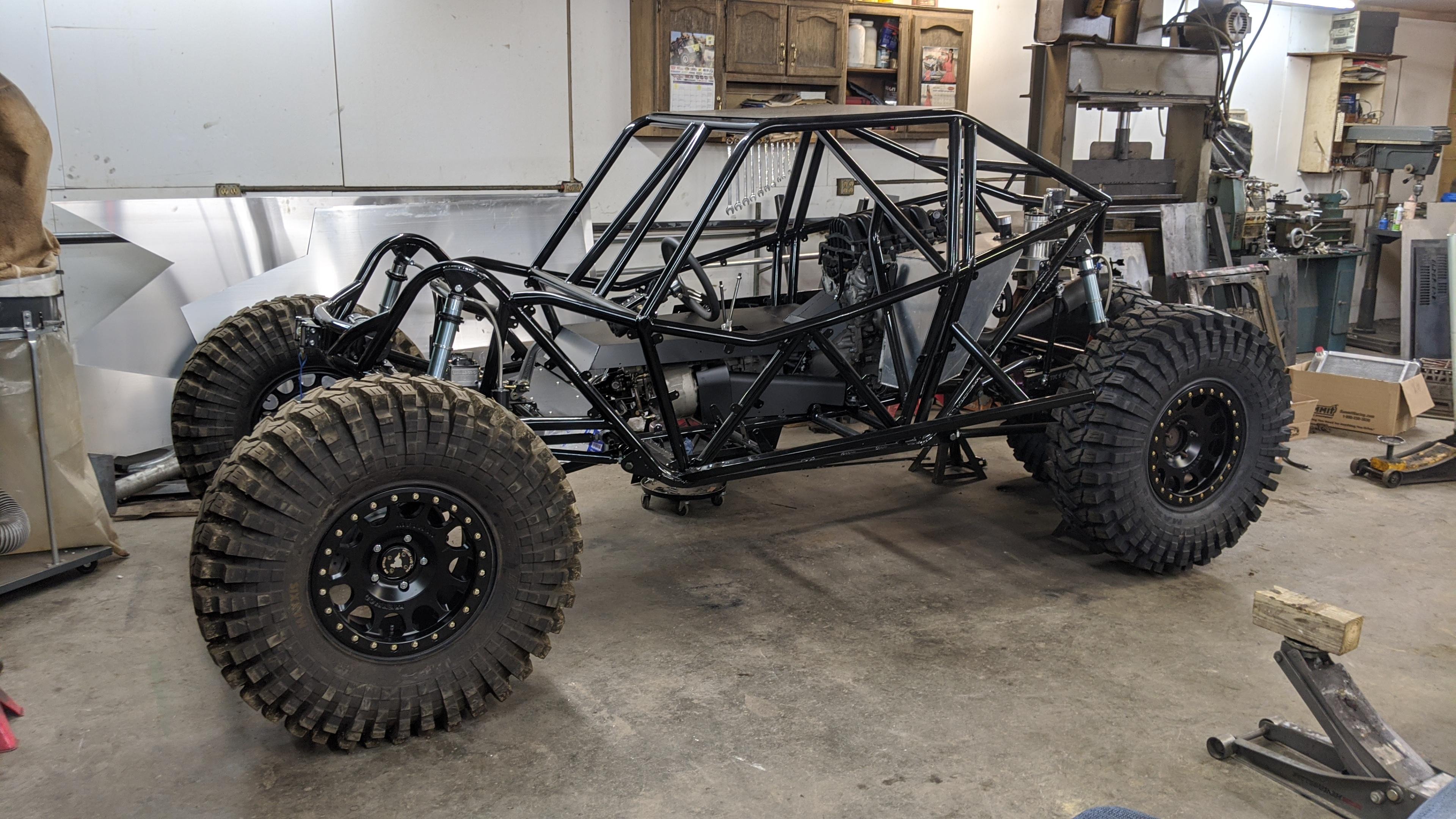

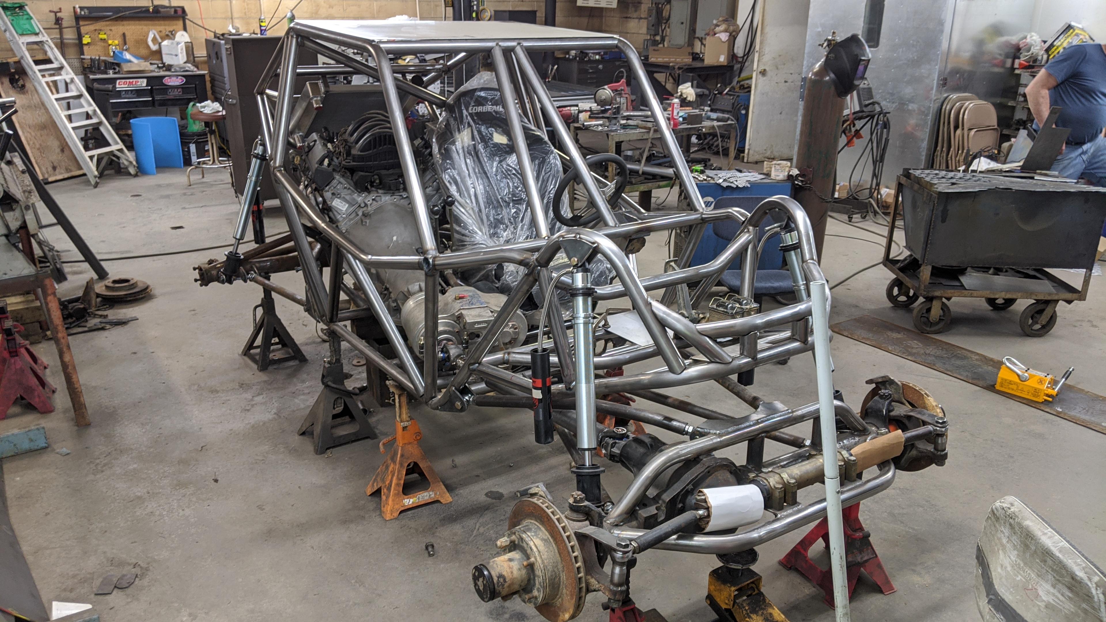

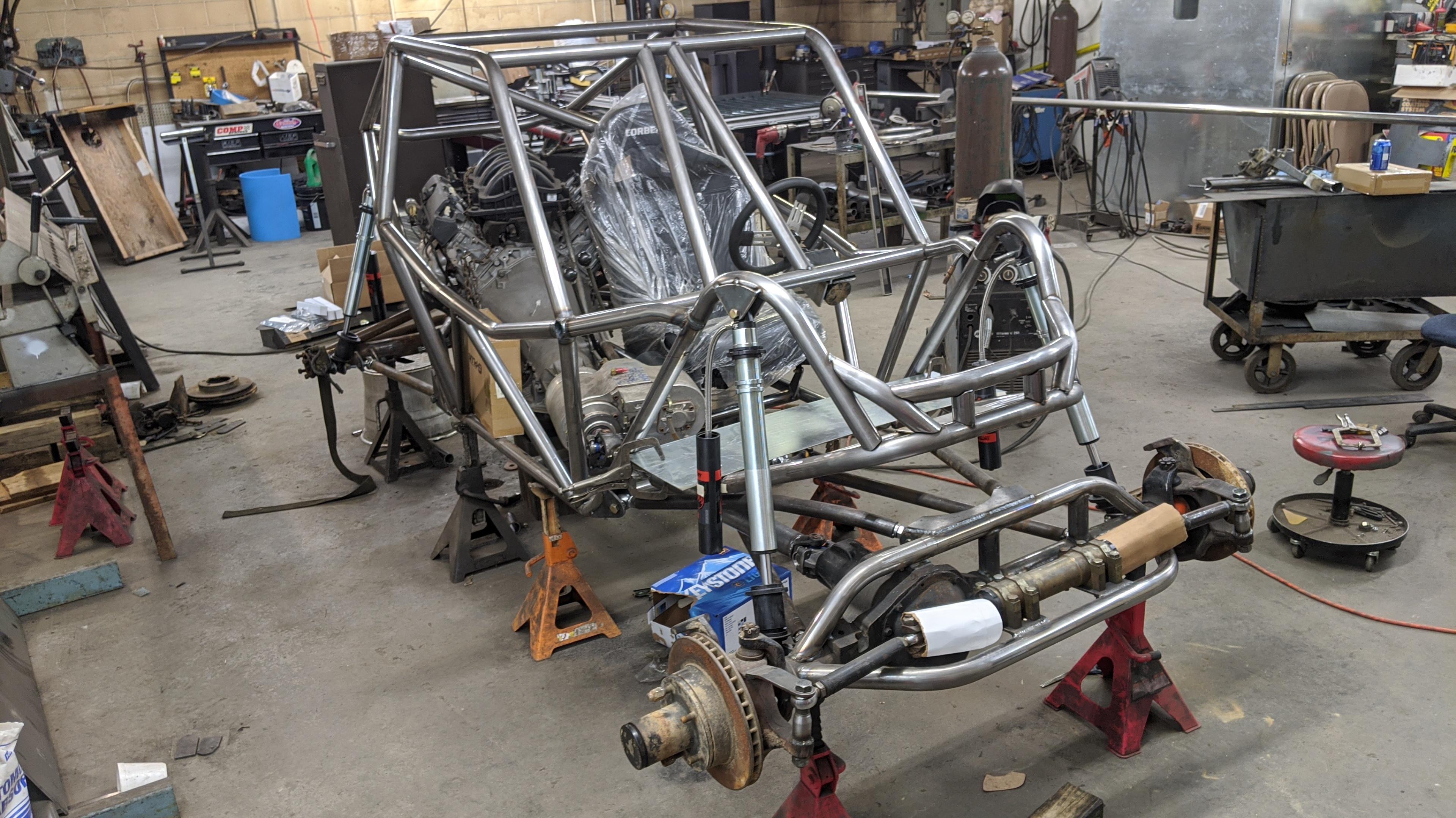

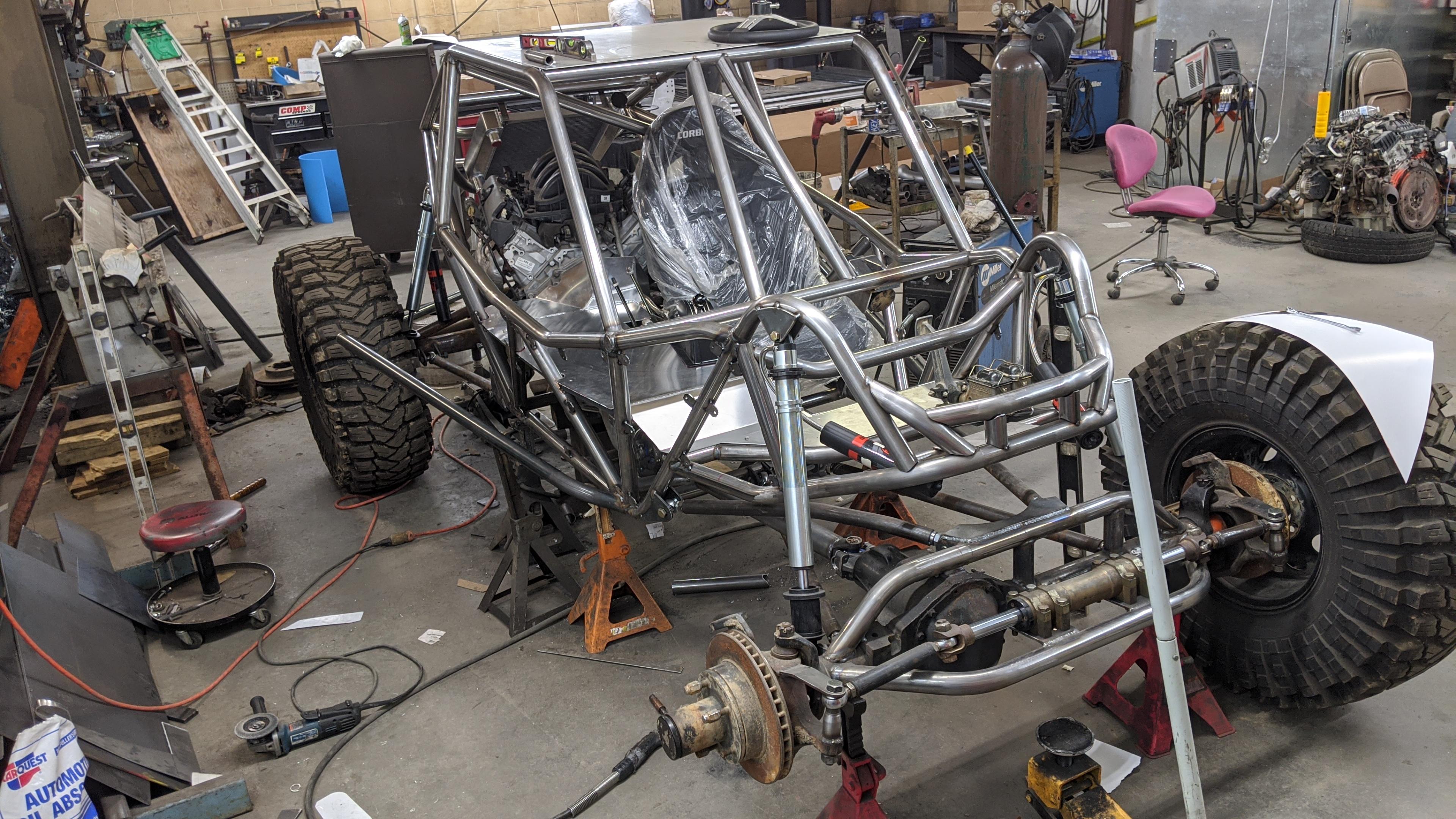

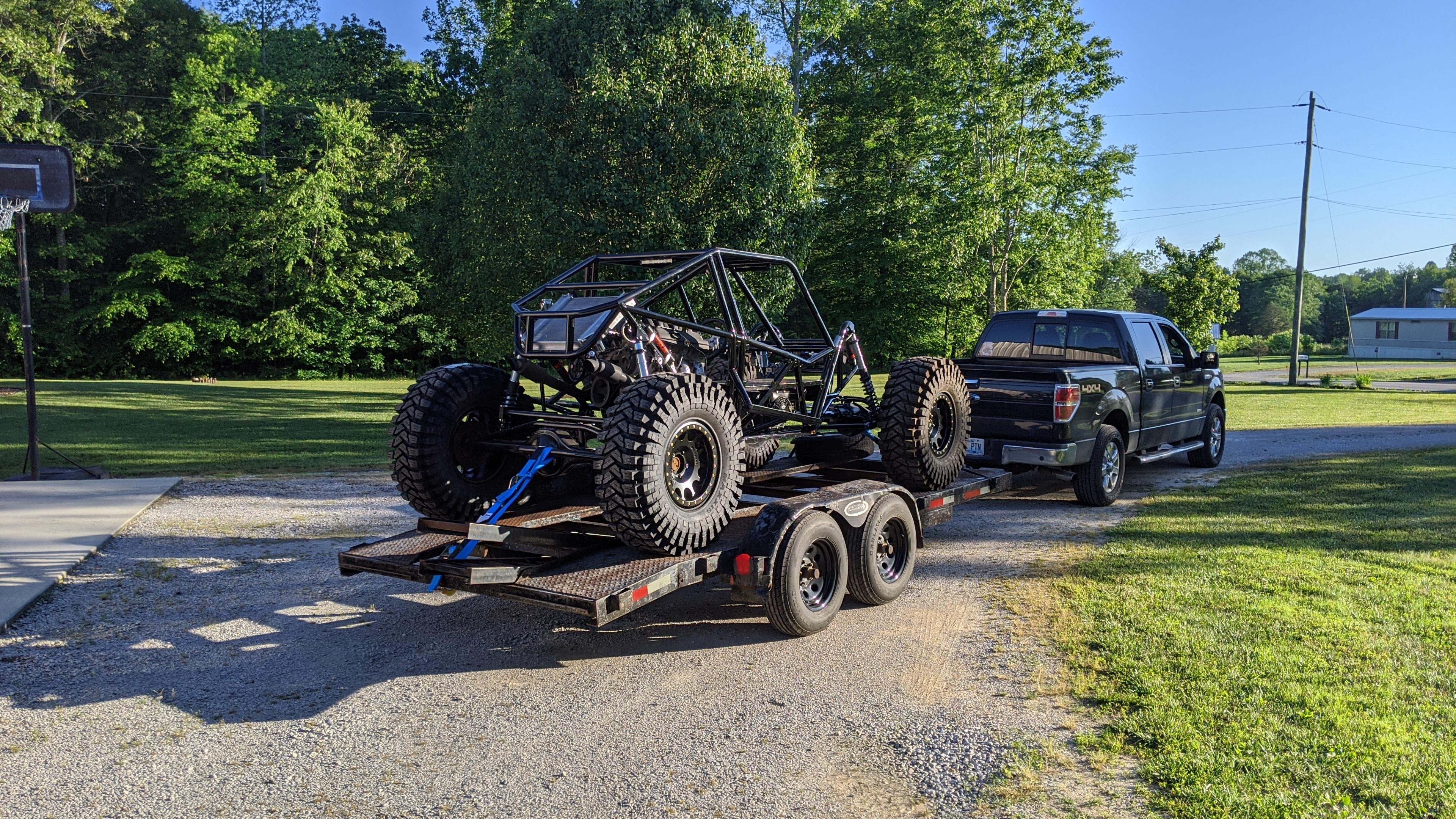

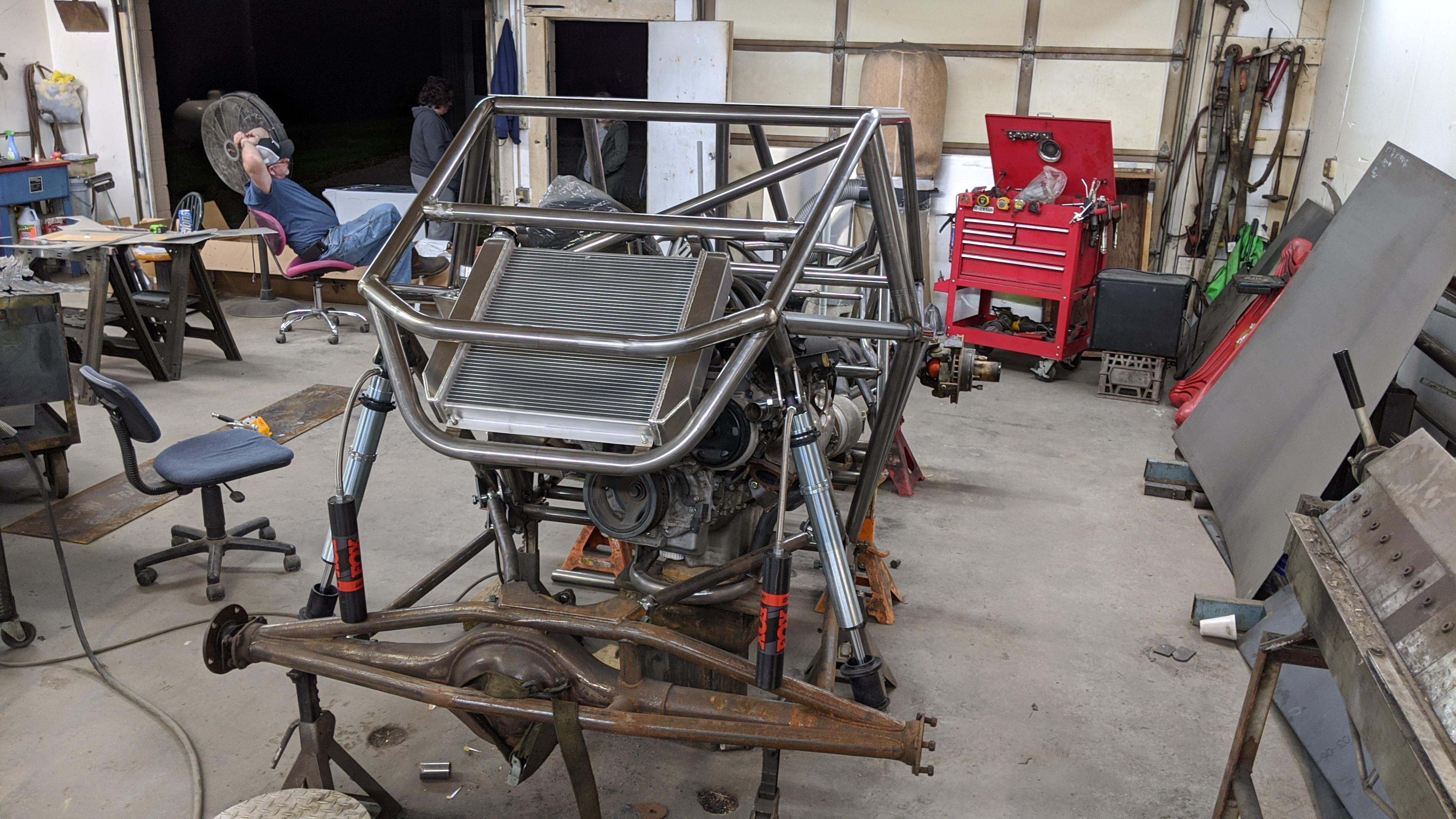

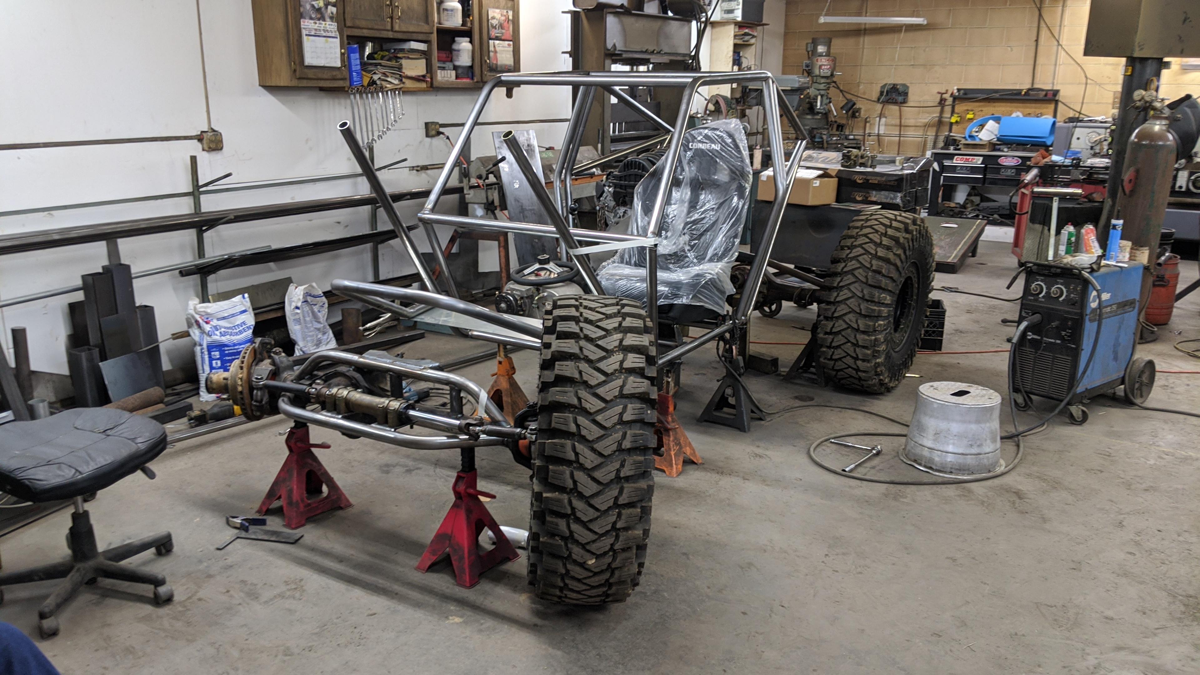

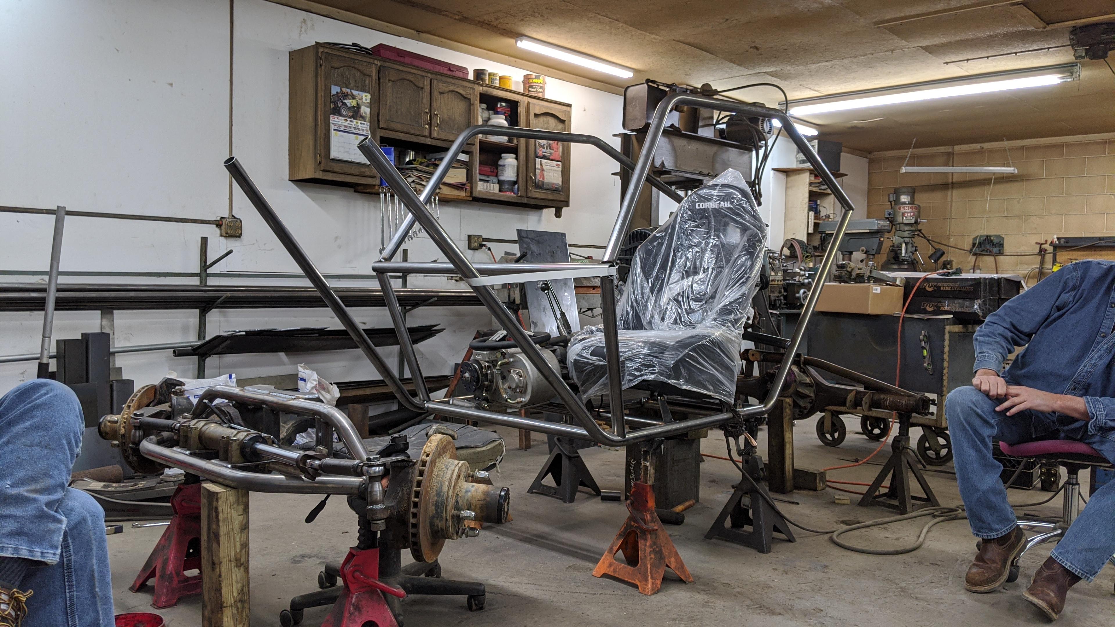

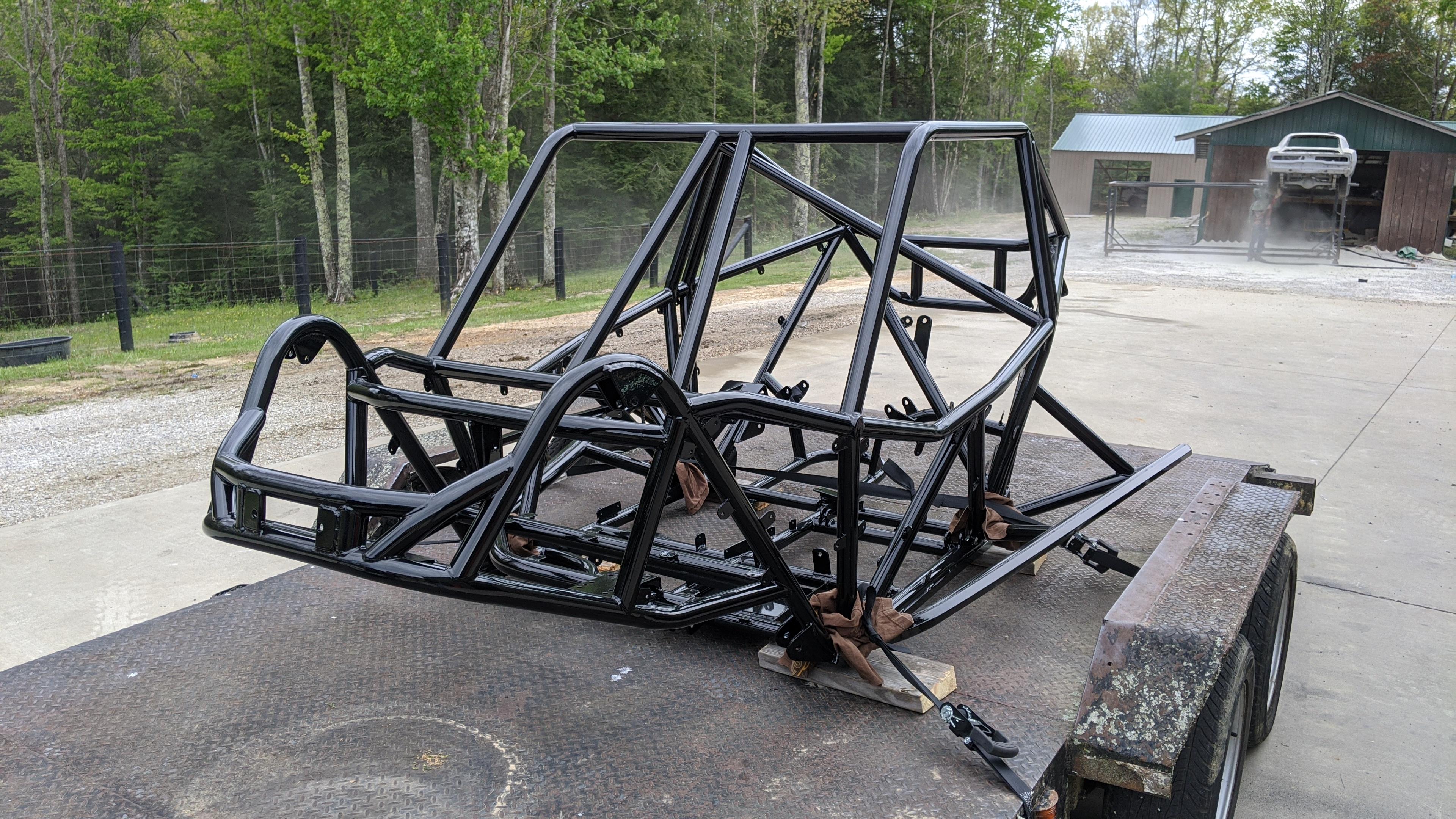

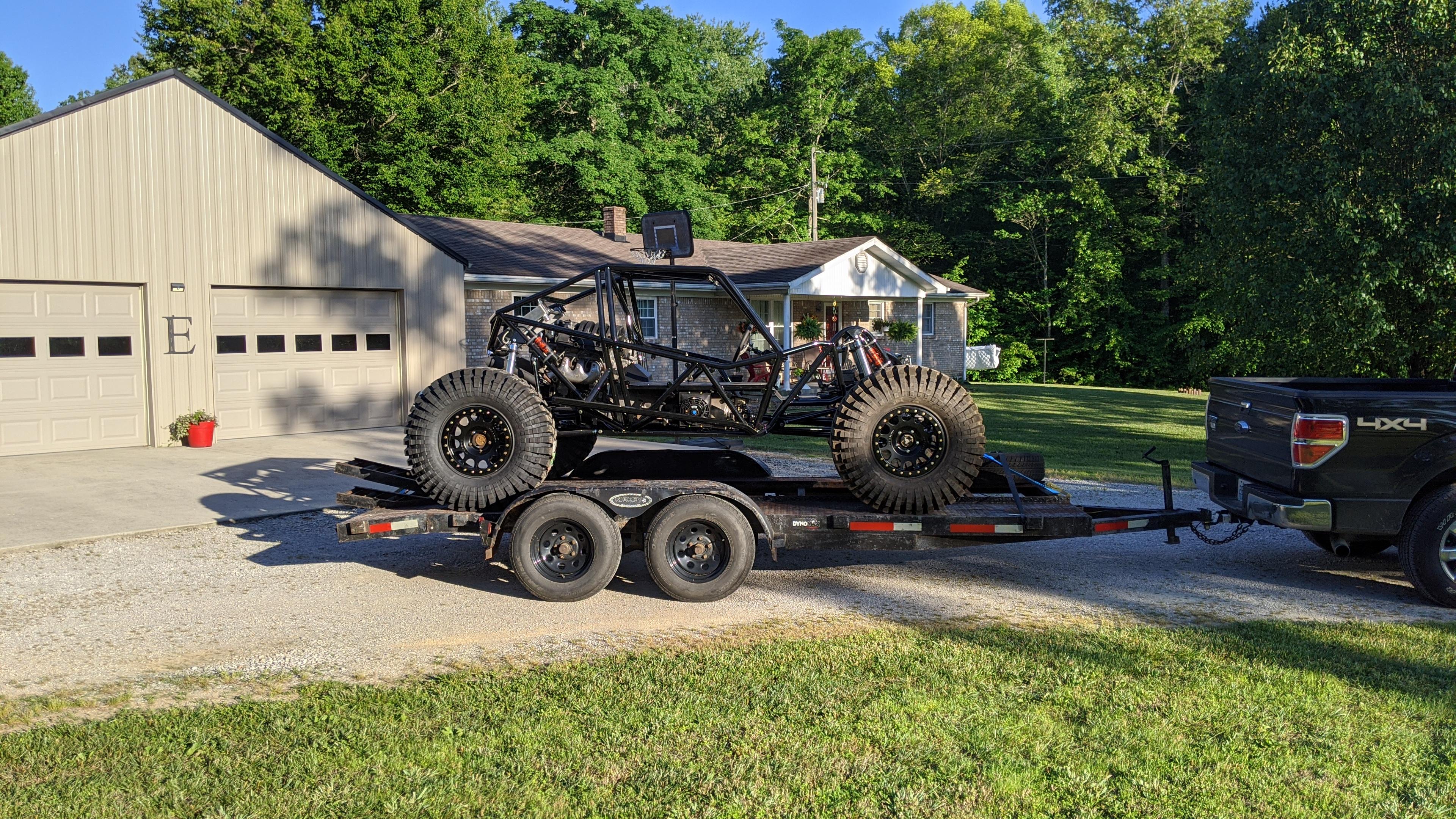

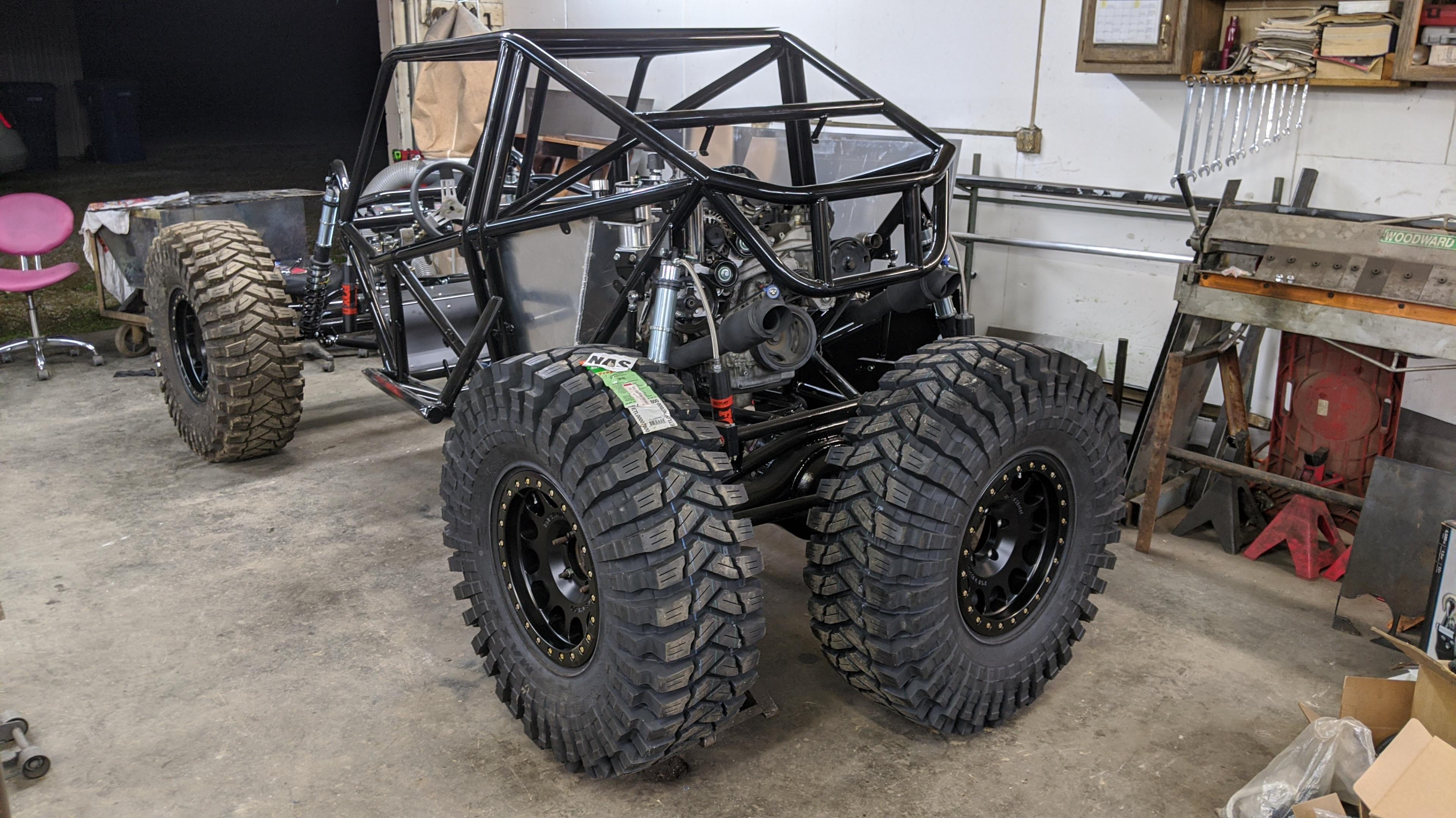

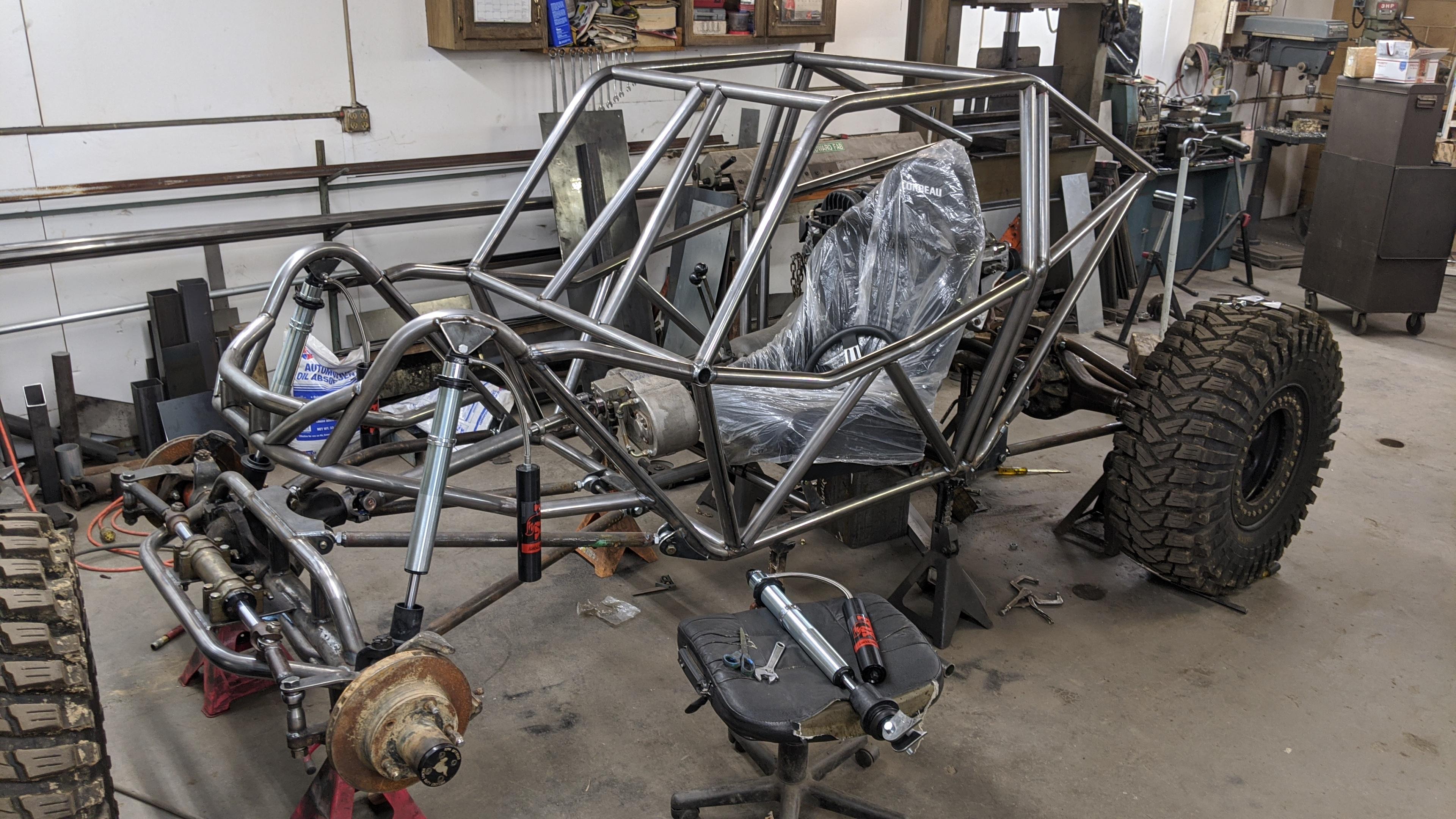

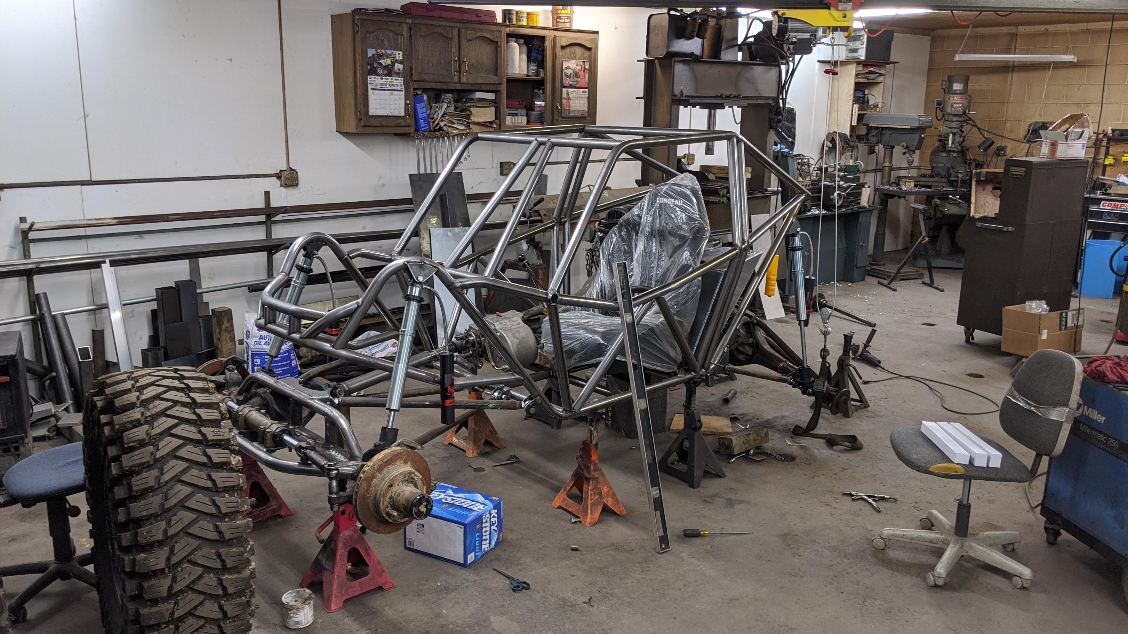

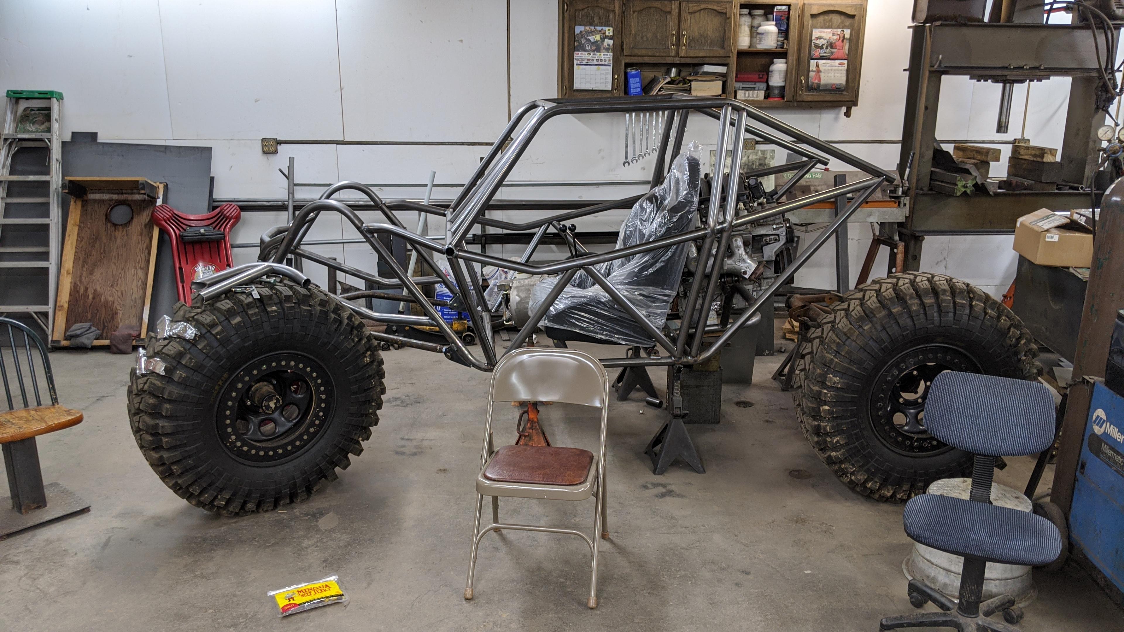

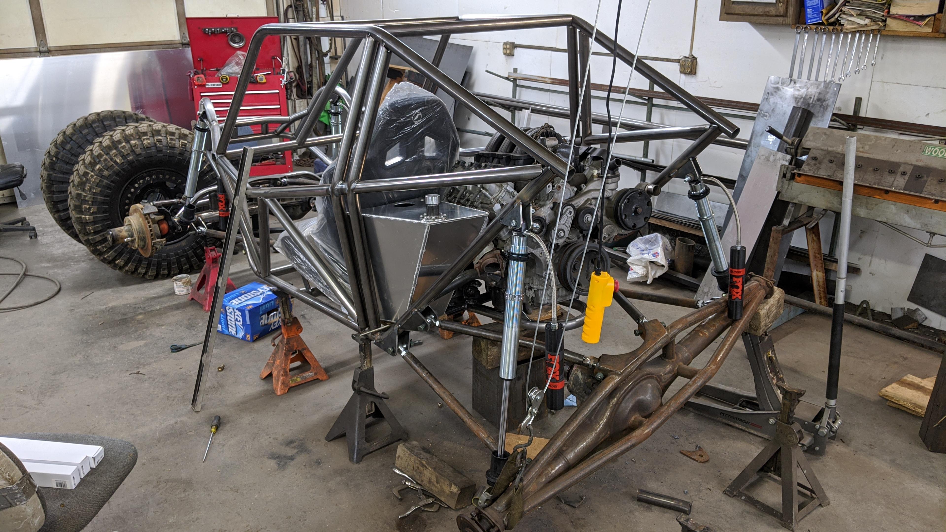

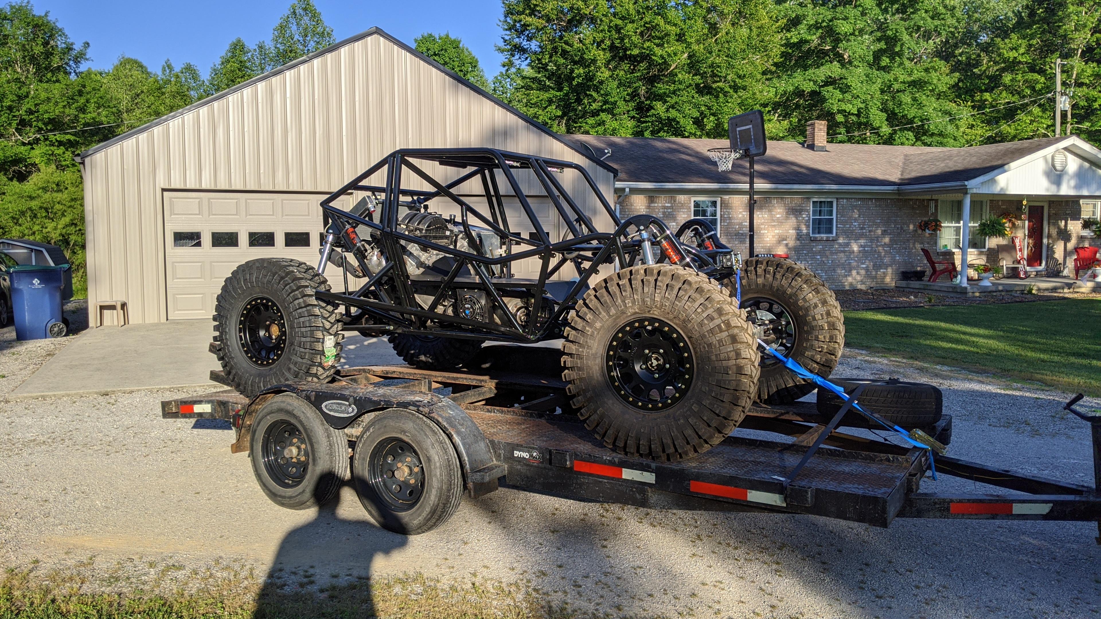

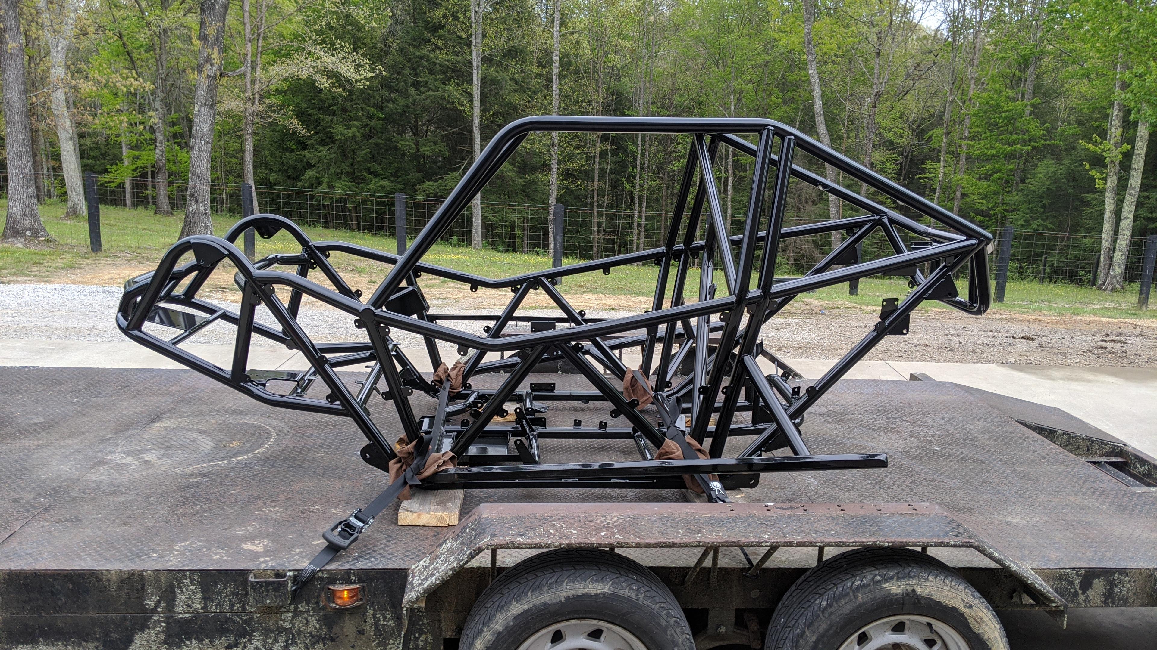

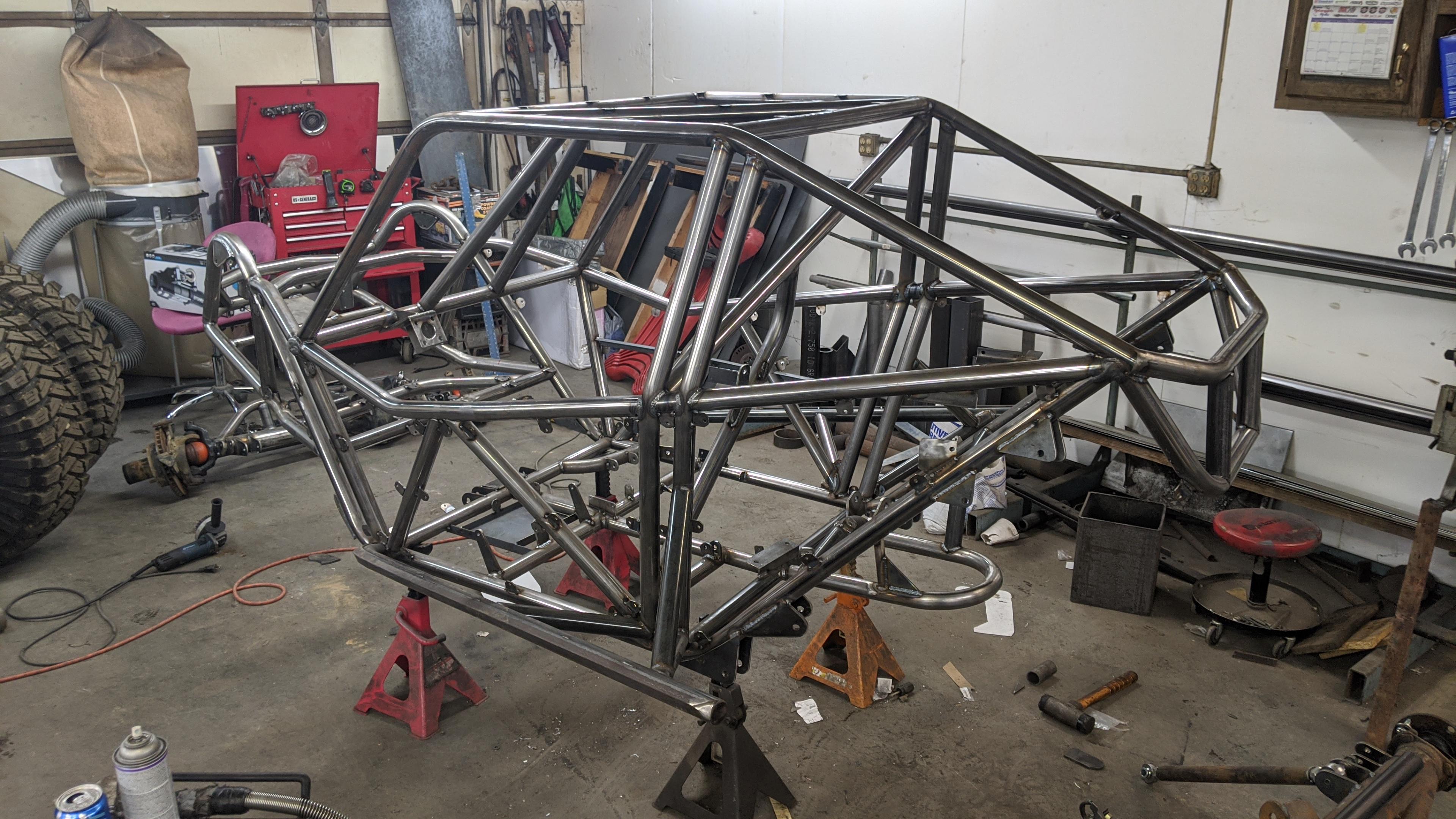

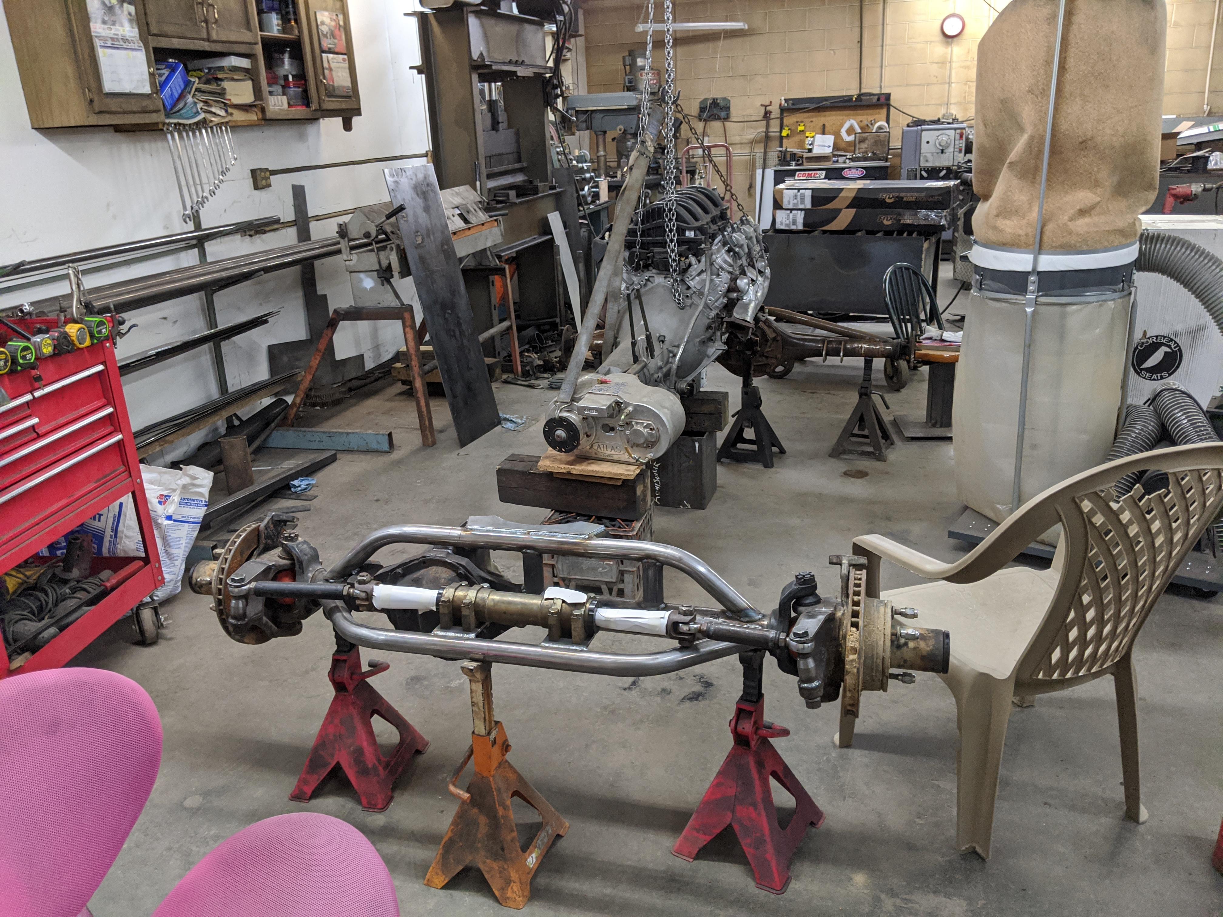

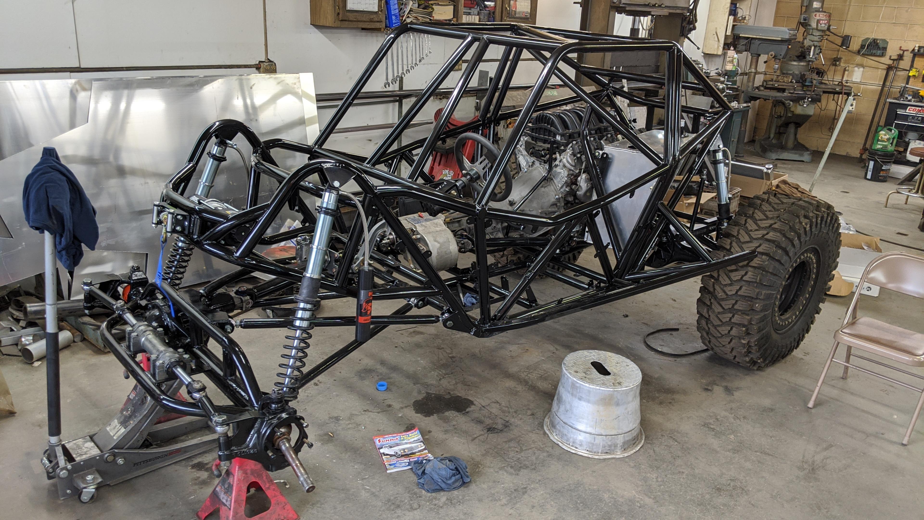

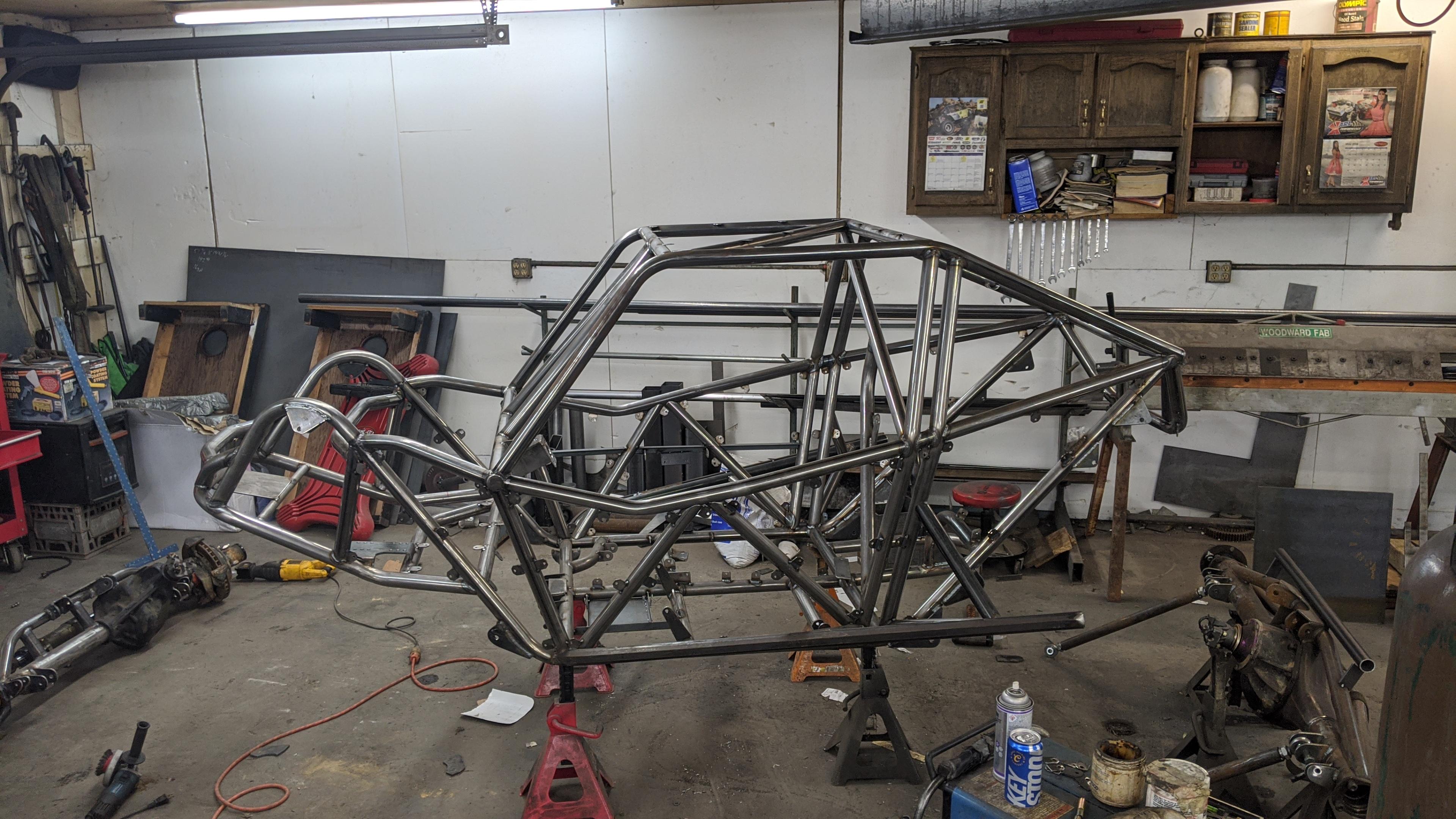

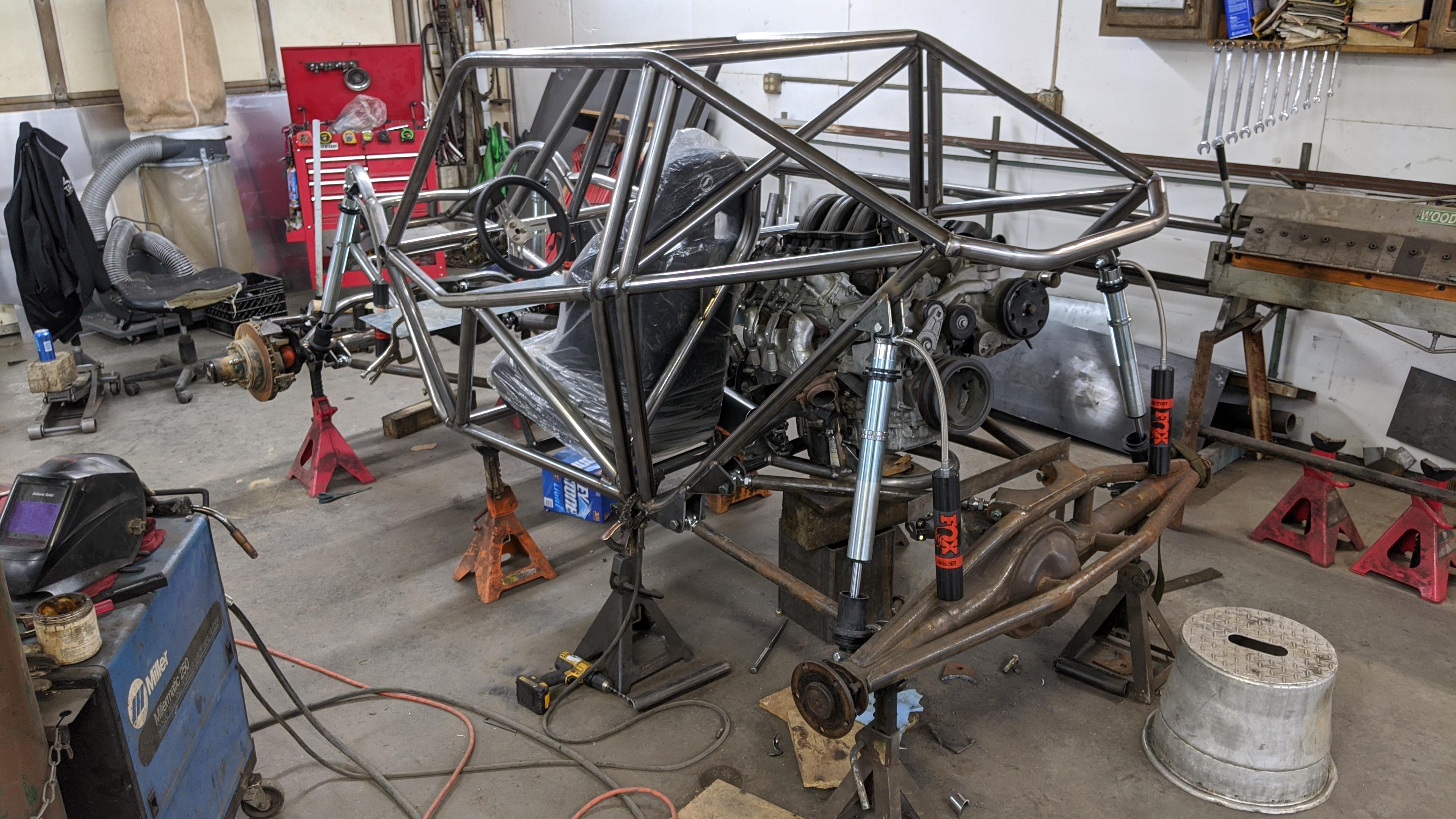

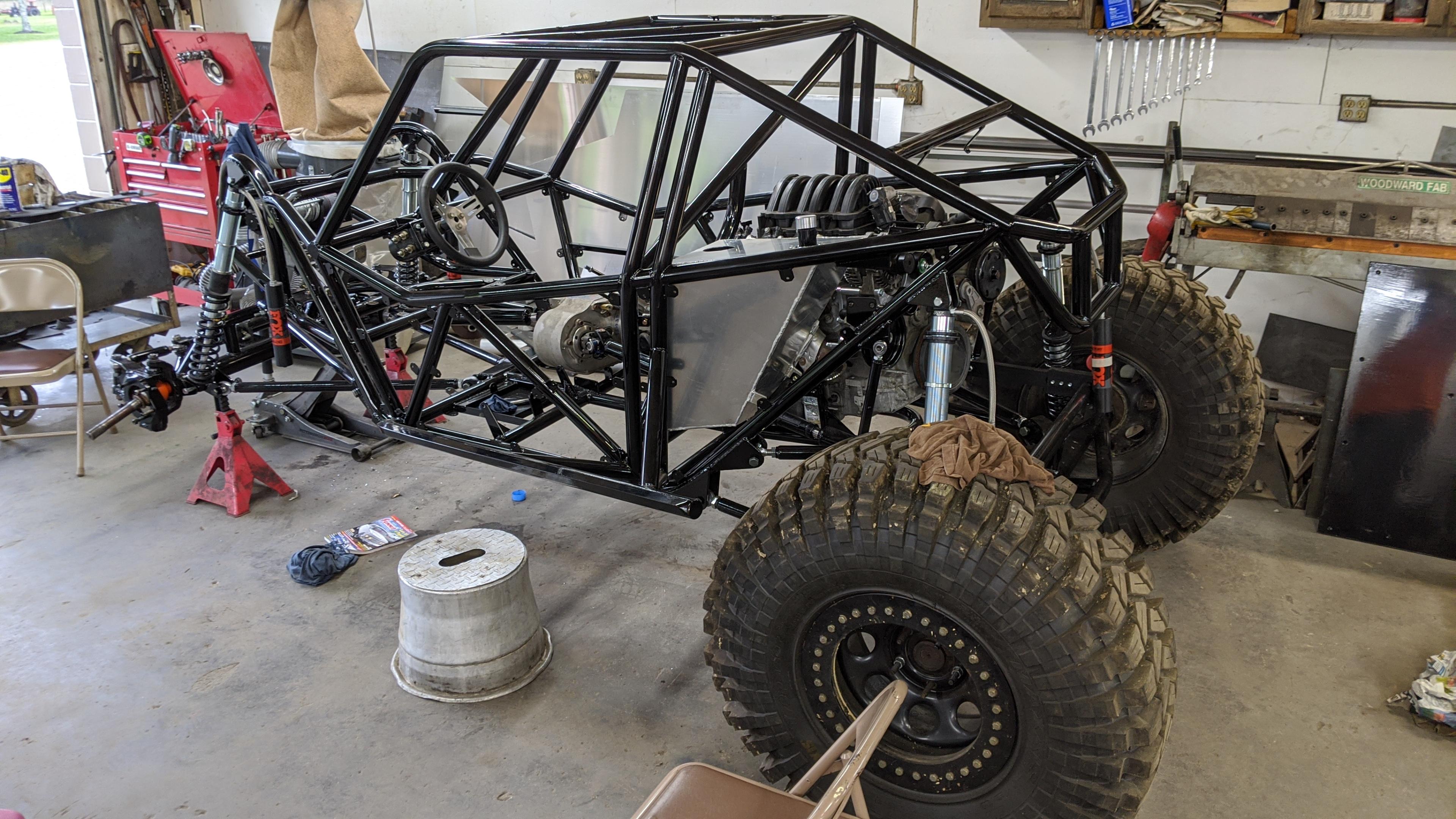

I've been in the process of having my new buggy built since January and I'm starting to get some where on it so I thought I'd share a few pics of the progress.
2016 LV3 4.3 engine
Th400 transmission
3.8 Atlas
D44 front axle with a spool and RCV's
9" rear with a spool and 35 spline axles
Elderfab chassis
40" treps
113" wheelbase

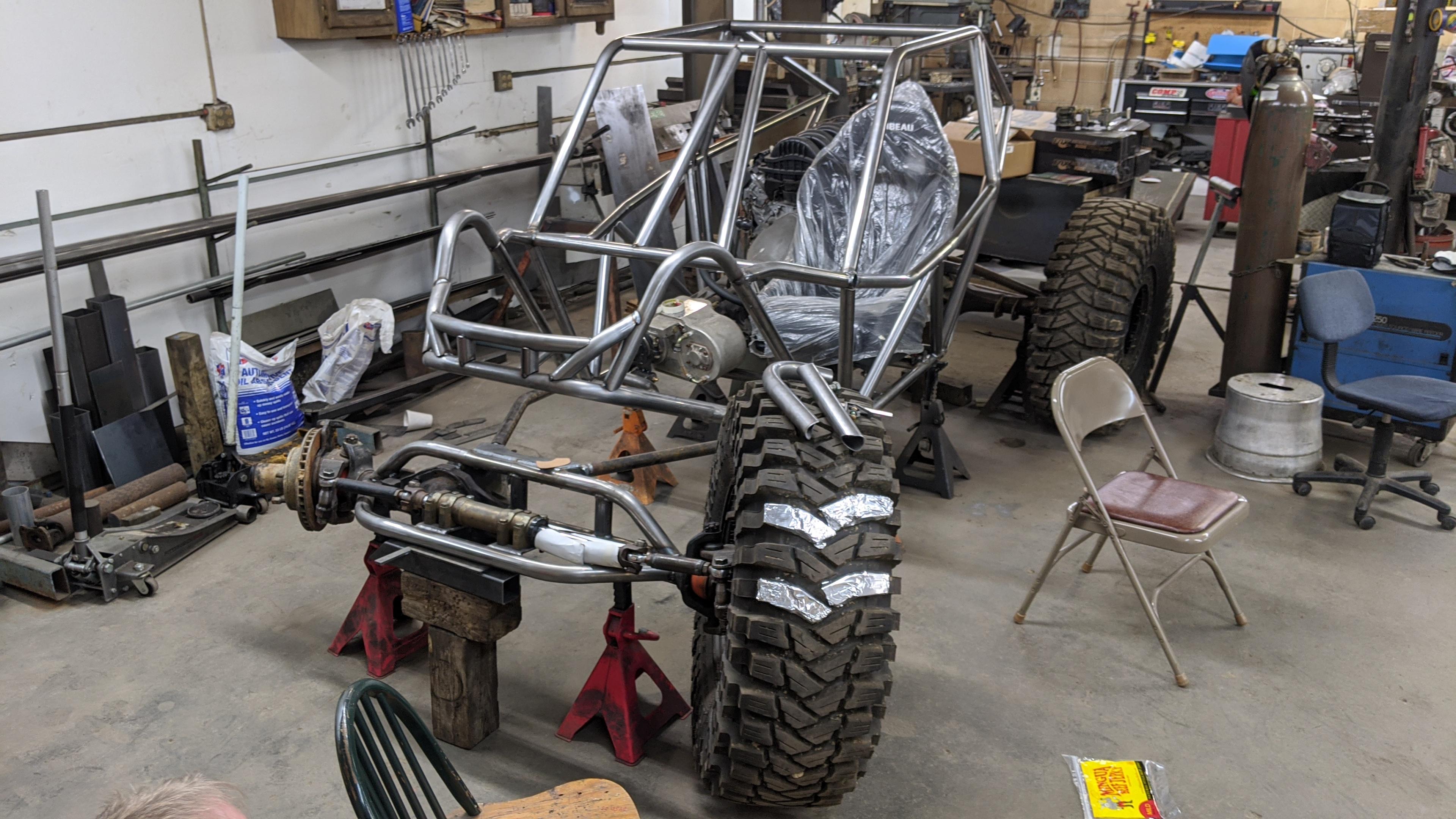

the build looks like good quality work. did you do anything in the axles to deal with oiling the pinion bearings since your running them upside down?
No I plan on trying to run extra gear oil to help with that. I don't do any high speed stuff or road riding usually only ride tight technical trails slow stuff ya know. But it could be an issue.
