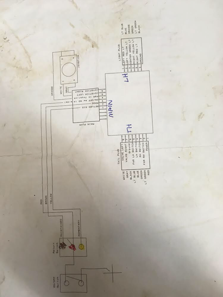

Does anyone have the wiring diagram for the older Stazworks rear steer setup? Bought a kit on here but it doesn't have the diagram.

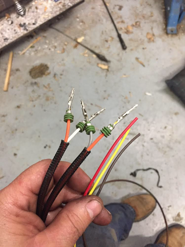

I have the diagram for the 4 sensor plug system . I think it has the same yellow,brown,red wires. They all go to the toggle switch that either self centers or lets you stay turned. I'll dig up the directions those other wires with the terminals on them already go to your sensors
A buddy of mine saved the day!
