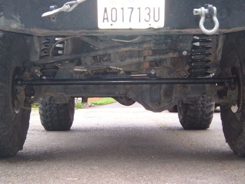

1.5" 1/4" wall dom, weld in inserts(7/8"x18) moog es2010L,es2010R and jam nuts(those can be tricky to find)Sound like you are on the right track! Good luck. Here's mine- before
after-

The only issue I see is that the 2026 is 8.75" long and the 2027l is 6.5" long, so you have a much long tie rod- I'd rather have more dom than all that tie rod end.
After doing all the research and making mistakes, I would call one of the places up tell them what you want and have tapped heavy wall versions sent to the house. Yes, it will cost a bit but all the parts will be there. I figured out after getting done that it was about the same price. If you have to do it, wouldn't recommend inserts, find someone (or business) with the correct taps.
I also ran into a problem with the Sky arms and the draglink hole needed to be reamed out more for the high mis-TRE, believe the waggy steering arm did too. If your going to do this by hand, be ready for sore blistered hands the next day.
Here is a couple of pictures, don't like how they came out, wrong parts too, but work for pushing around the shop right now.
