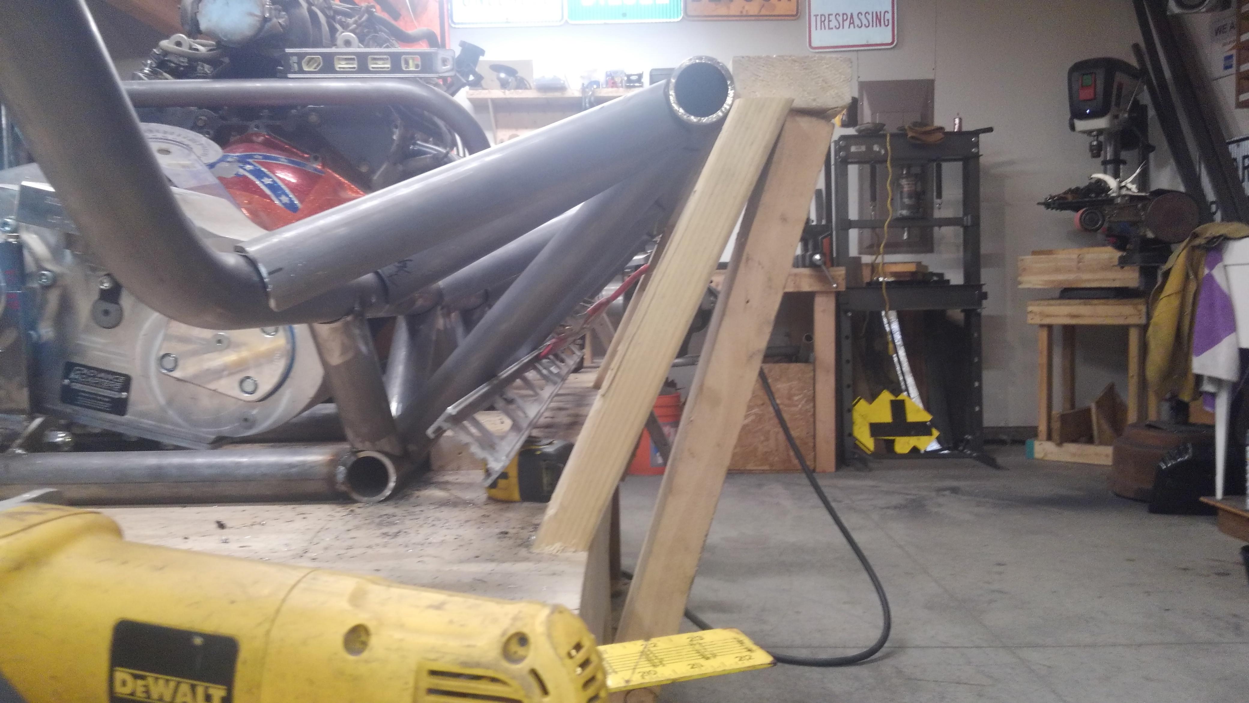

So it begins, frame table up, level, 51 degrees maybe...

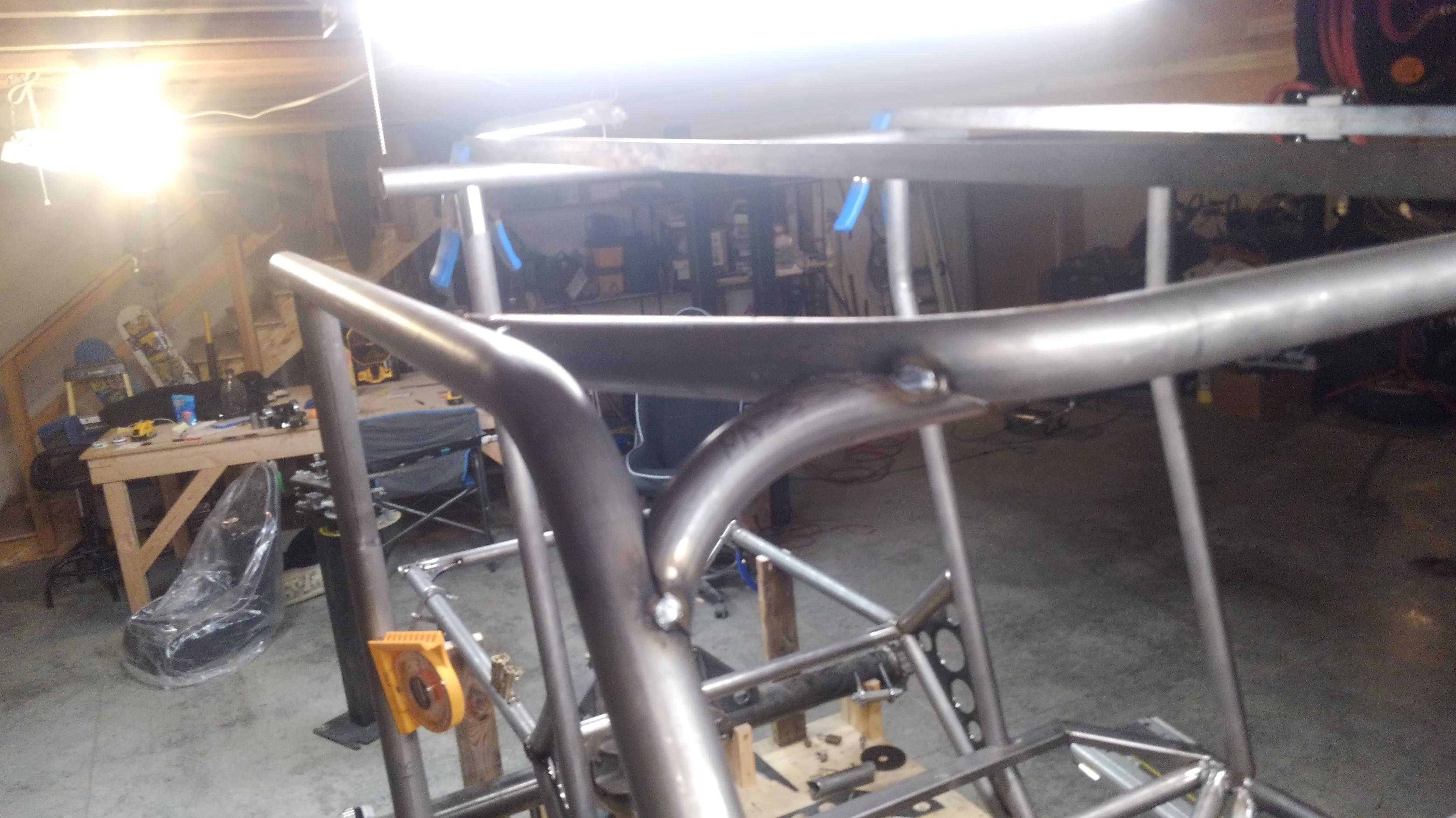

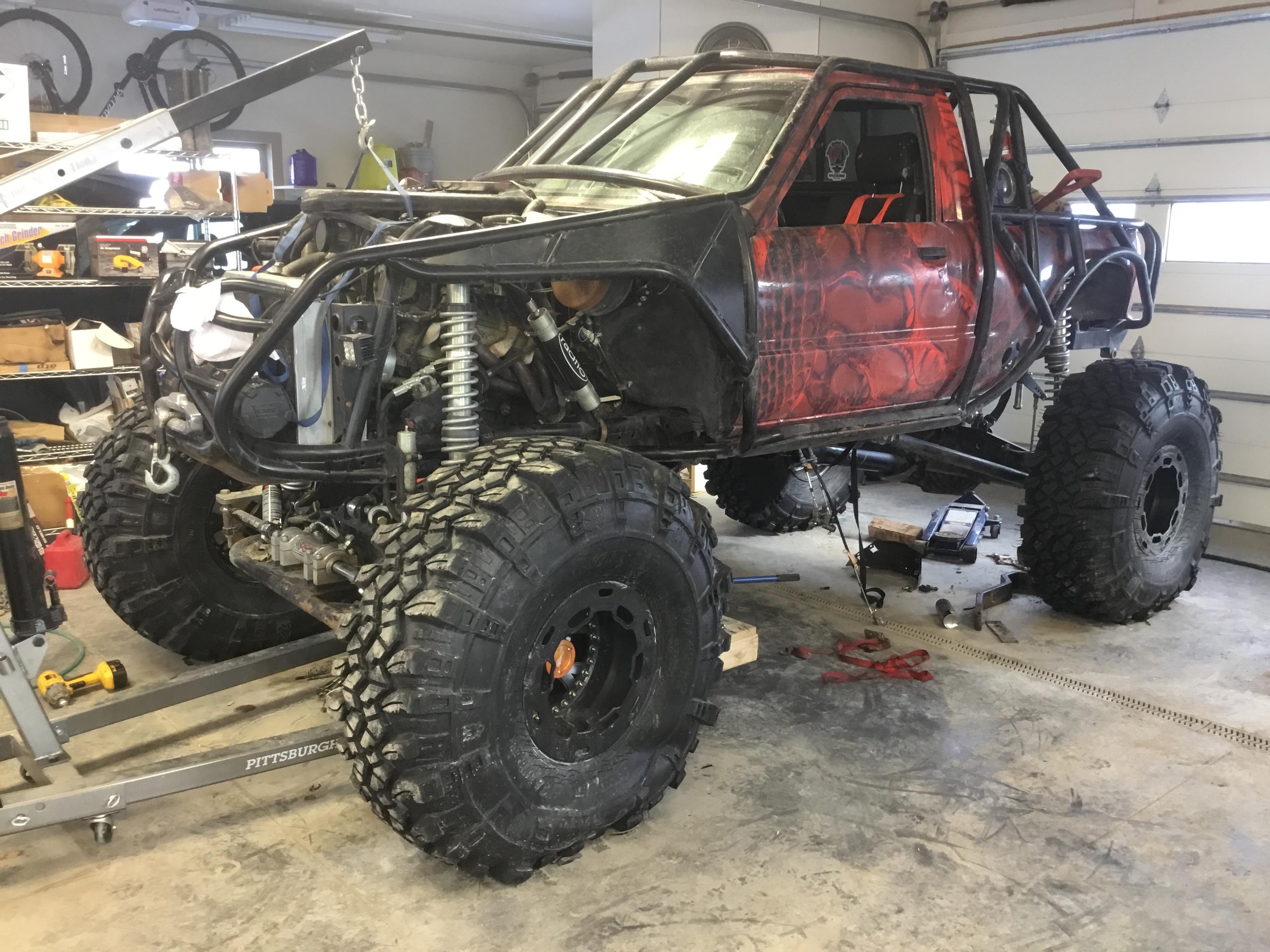

Got a bunch of tubes in, reworked the roof to get some more head room, beadlocks showed up yesterday, got those mounted up. Rear tubes went in today

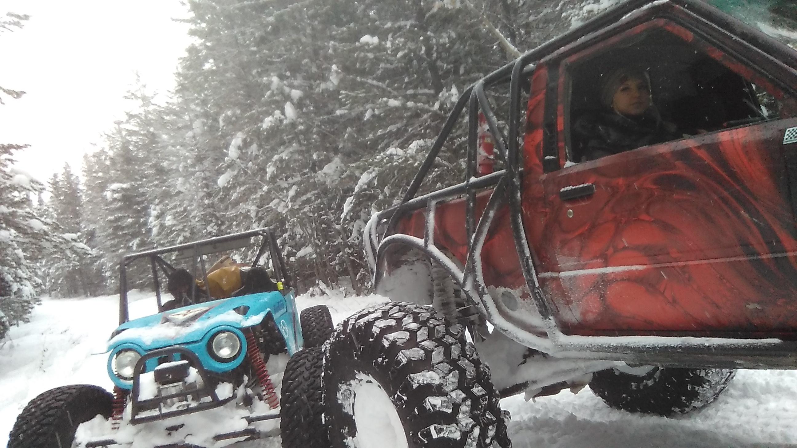

Build looking good. Any pics of the front of the red truck in the snow wheeling photo.
