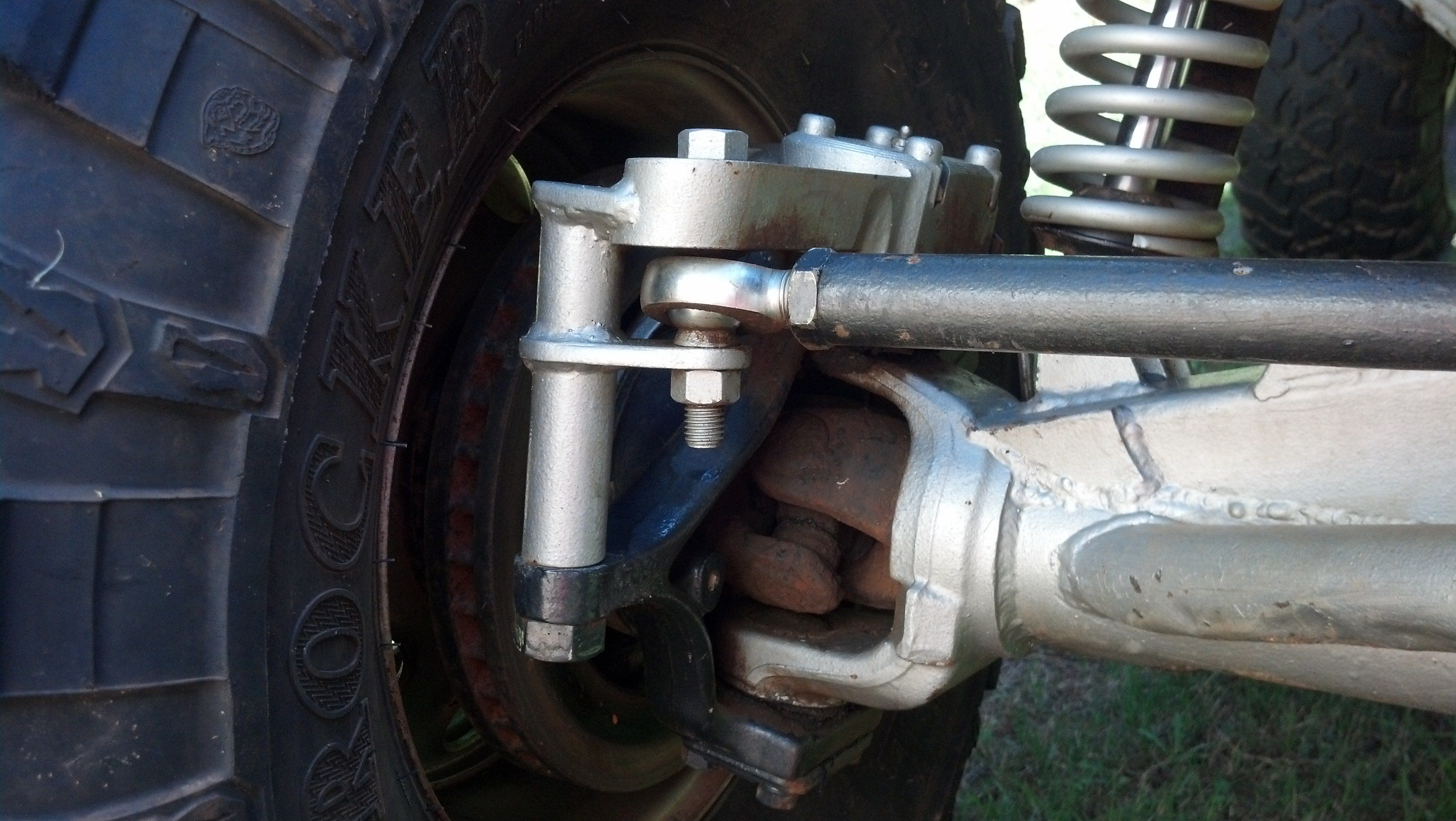

I went to Morris Mt a couple weeks ago and the last trail of the evening (Isn't that the way it always is??) Copperhead and I broke a drivers side knuckle at the top. After the Mr. Randy and Mr. Kris tried helping me get it out I decided it was best to leave it and bring back a knuckle to fix it with. My question is this- I bought a Reid knuckle to put on it, and I was wanting to know if I could weld a tab on the side of the high steer arms I have now in order to be able to run a long bolt straight through the high steer arm and the factory location, or would welding to the arm make it brittle.

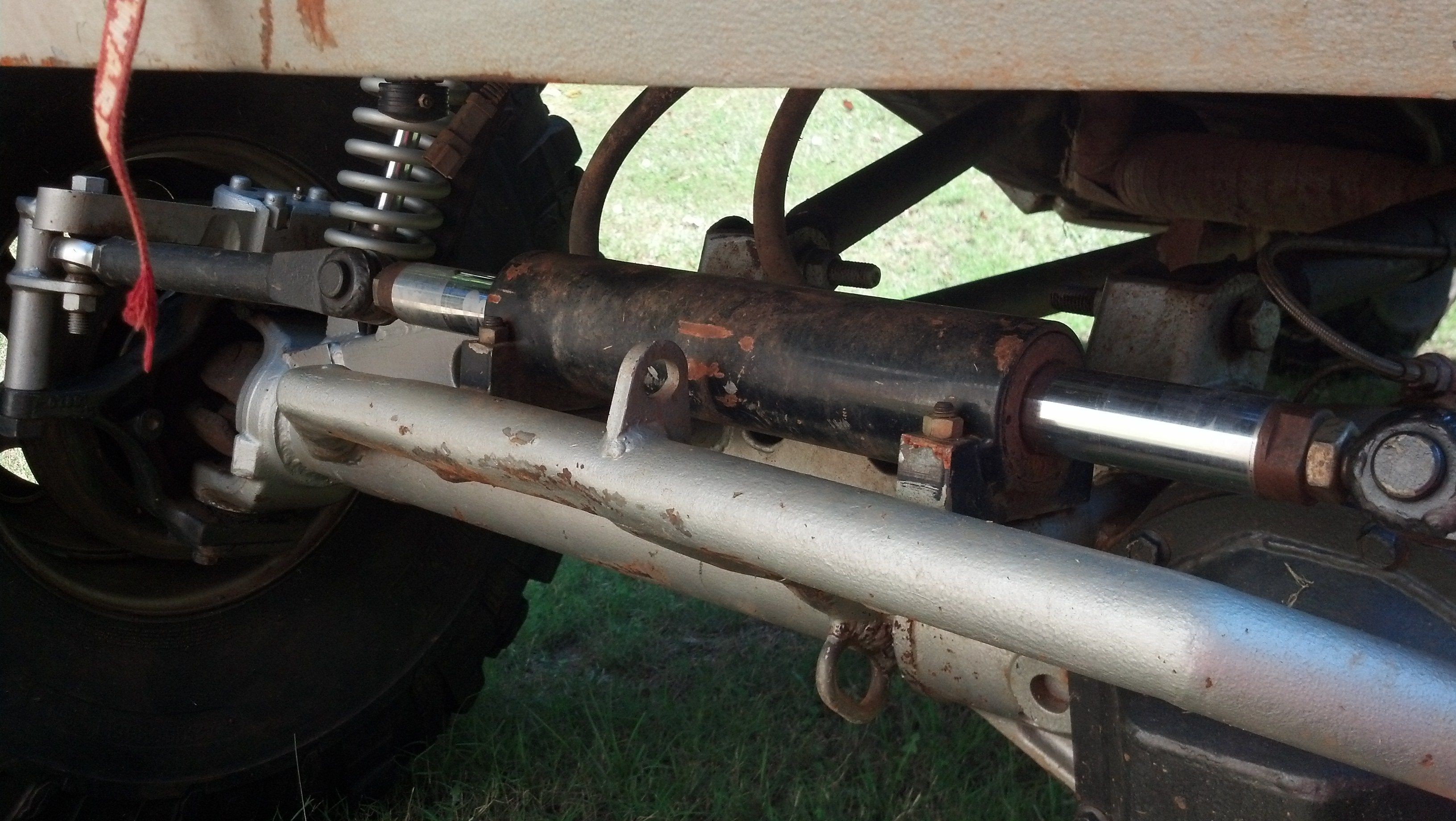

I think we talked briefly about my setup on Saturday in the rain. It has been like this for 3 years. No issues at all. I originally thought it was too close to the tire sidewall and would hit under side loading but it had never hit the tire. I highly recommend doing something similar to tie the high steer arm into the factory tie rod arm. This is the best pic I have at the moment.

Your bolt on high steer arms would be regular steel and you can weld to them without issue. The tabs and tube on mine are welded to the high steer arm. The factory tie rod hole was drill out to 7/8" and the tube is tapped to 7/8 fine thread. I bolted the arms down, then bolted the tube and tabs to the knuckle, then welded the tabs to the high steer arms. That way everything is in place prior to welding and can be unbolted and removed for maintenance. Now is a great time to mount you hiems in double shear too as well.
RustyC I am the one that you talked to Saturday, I appreciate you guys keeping a check on me. Your setup is what got me to thinking about modifying my setup.Thanks so much for your input guys! :dblthumb:
Sure I can get more pics this evening. It is nothing special suplus center cylinder, homemade tabs and 7/8" x 3/4" hiems.
