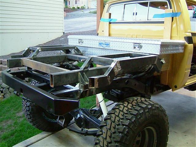

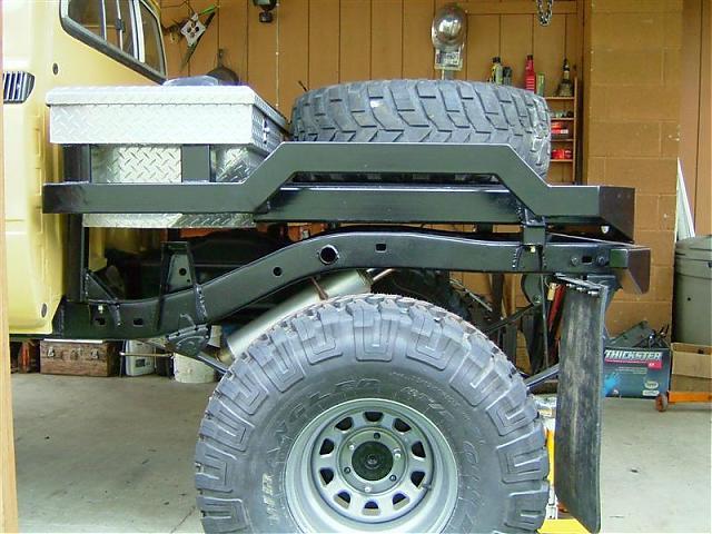

I did 2"x3"x1/8" on the outside frame. It is all welded to two short peices of 2"x4"x1/4" tube frame over the frame rails.
