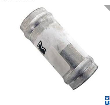

whiskeymakin Well-Known Member Joined Sep 10, 2008 Messages 1,695 Location Mid TN Sep 22, 2017 #1 Attachments 2017-09-22 13.35.28.png 65.8 KB · Views: 396
Jduck Well-Known Member Joined Jan 11, 2011 Messages 1,073 Location Athens, GA Sep 22, 2017 #3 Bead roller, or weld a bead around the tube
V vidio1 Active Member Joined Feb 4, 2012 Messages 38 Sep 22, 2017 #5 http://www.clubcobra.com/forums/tech-tips/110097-cheap-tubing-bead-roller.html If you're only doing 1 or 2 you can get by with something like this...

whiskeymakin Well-Known Member Joined Sep 10, 2008 Messages 1,695 Location Mid TN Sep 22, 2017 #6 I've welded a bead around one before I was just curious of it might be a cheap simple thing I could pickup.

The-Boss Well-Known Member Joined May 20, 2010 Messages 703 Sep 22, 2017 #7 Another diy version https://youtu.be/CGiunb8beDA
J Jbstewart777 New Member Joined Apr 11, 2015 Messages 4 Location New Market , Al Sep 23, 2017 #8 Vibrant performance sells a bead roller that flares like that but they are 300 bucks.
gottagofast Well-Known Member Joined Dec 11, 2015 Messages 1,064 Sep 24, 2017 #9 $130 http://www.jegs.com/p/JEGS-Performance-Products/JEGS-Tubing-Beader/1423179/10002/-1
whiskeymakin Well-Known Member Joined Sep 10, 2008 Messages 1,695 Location Mid TN Sep 24, 2017 #10 Thanks. I was thinking about getting that jegs one or one similar on ebay Or just buy that piece with each end flared for 5 bucks, cut it in half and weld it to the pieces im working with
