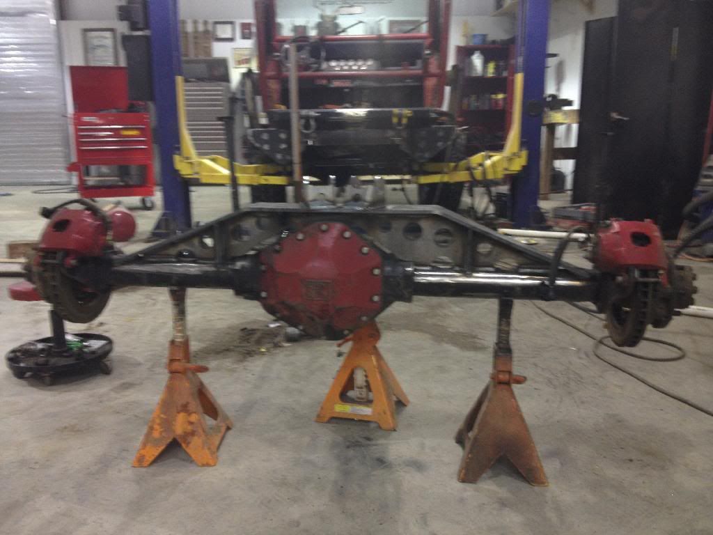

Started cutting everything out and getting ready for some new parts the artec front truss is one of the best designed weld on units that I have ever seen and not to mention I couldn't fab something that looks 1/2 as good and is very well priced IMO
