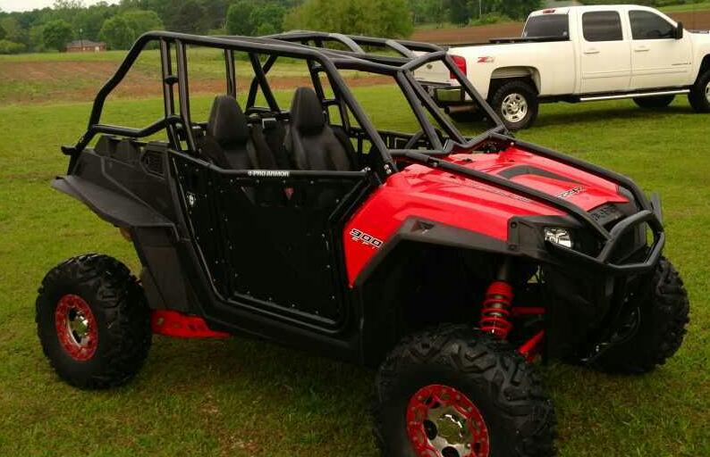

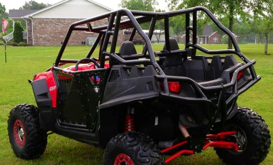

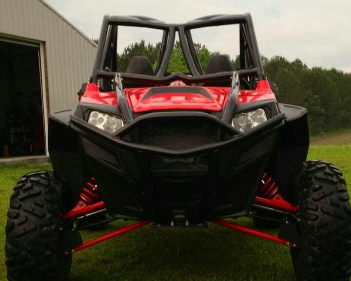

Got one of these a little while back. I had used a pro-tools for years and wanted to try a vertical style instead of the horizontal style. Been really happy with it so far.
Knocked this unit out with it.
