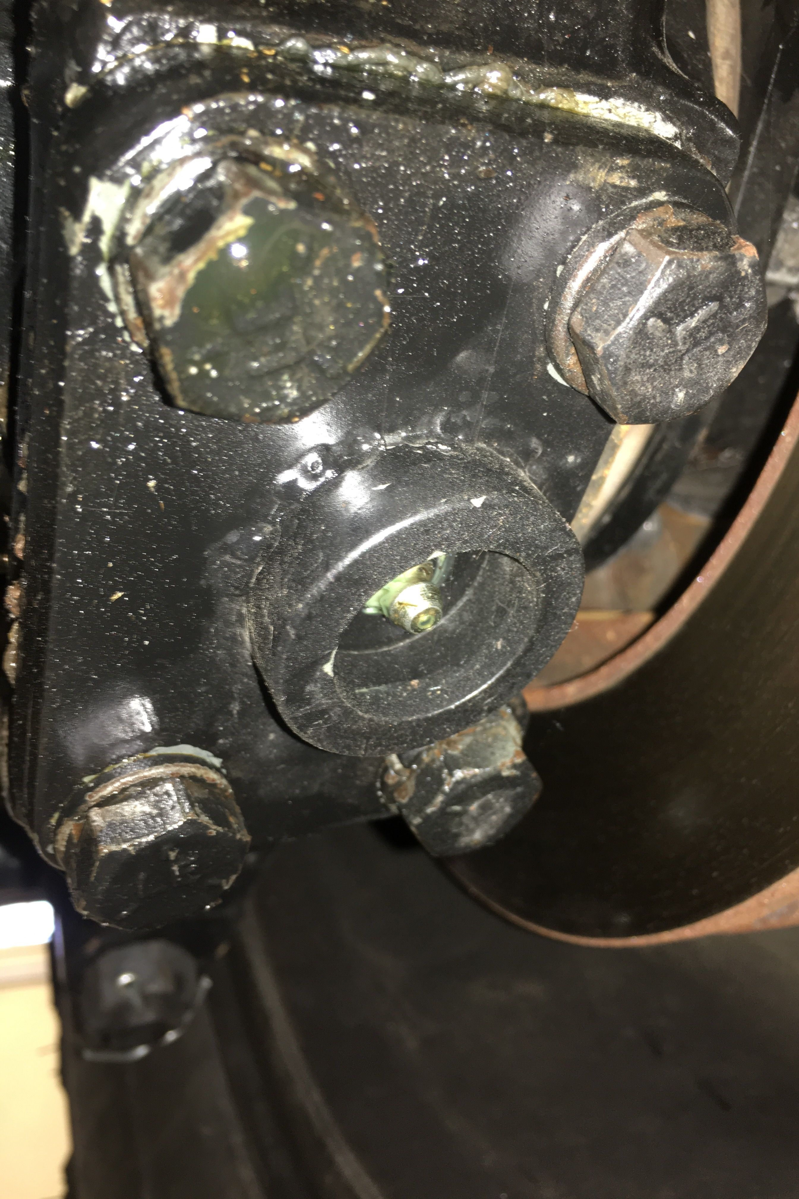

I cut a 3/4" pipe about 1/2" long or so if I remember right and welded it on. I can get a couple pics later and post up.

Ha, I thought I was the only crazy one....
This is what I was thinking of too. Probably depends on where you wheel maybe. Not sure how we broke all ours off but may have to do with the sage brush on the property.
Yep. This is exactly what i did. Its looking pretty mangled these days, but havent had to change that zerk out yet! Even had wood jammed in around the zerk and it was still good lol.
