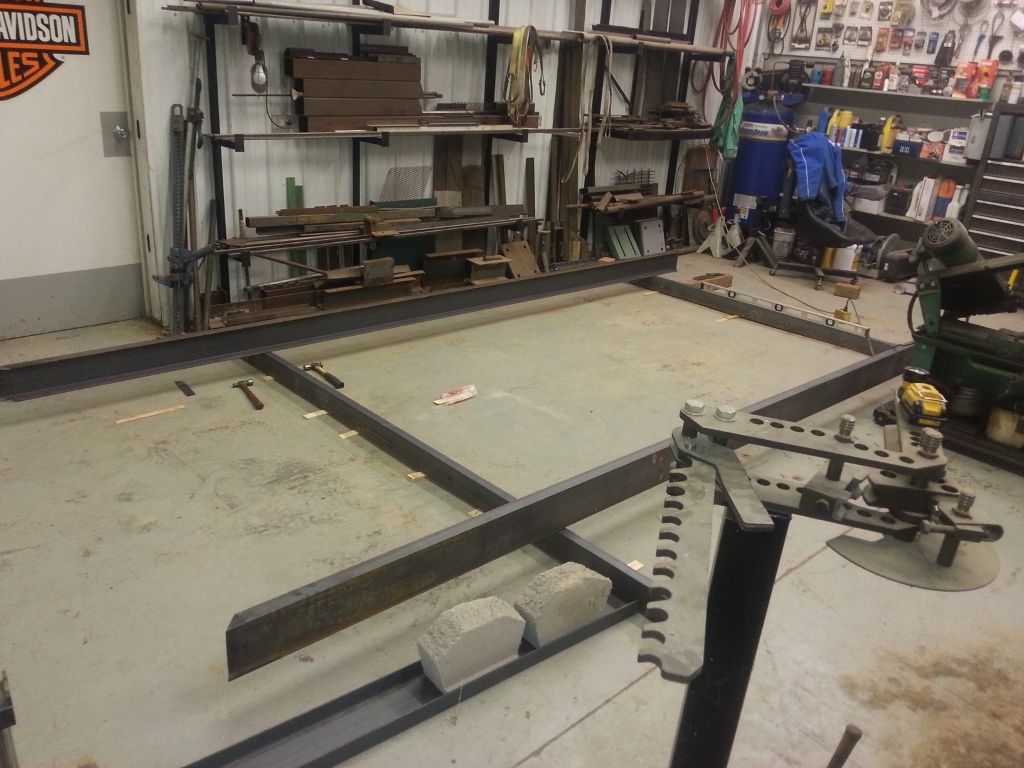

I'm not sure if there's any interest in a trailer build thread or not. It's certainly not up to par with most of the fab work on here, but I thought I'd give it a shot anyway. I've been a member for some time now, mostly looking, and learning and wanting to build my own rig some day in the future. I don't have the budget to own a $ 40,000.00 rig...wish I did, but sadly this trailer is gonna stress my funds quite a bit, not to mention my talents. With that being said (poorly I admit), here goes.
I'm new to posting on this site, so bare with me. I want a 20' split dove-tailed trailer. I've researched and looked at a lot of them online and this trailer will be the best fit for me out of all that I've seen. I want it strong enough to haul about anything I can throw at it, but still pull it with my truck. I started with 6" channel for the outside frame and 4" channel set at 16" on center for the cross members. I'm welding most of this with a Miller 251 mig welder, but I have stick and tig also if needed. I started out by getting everything somewhat level.
