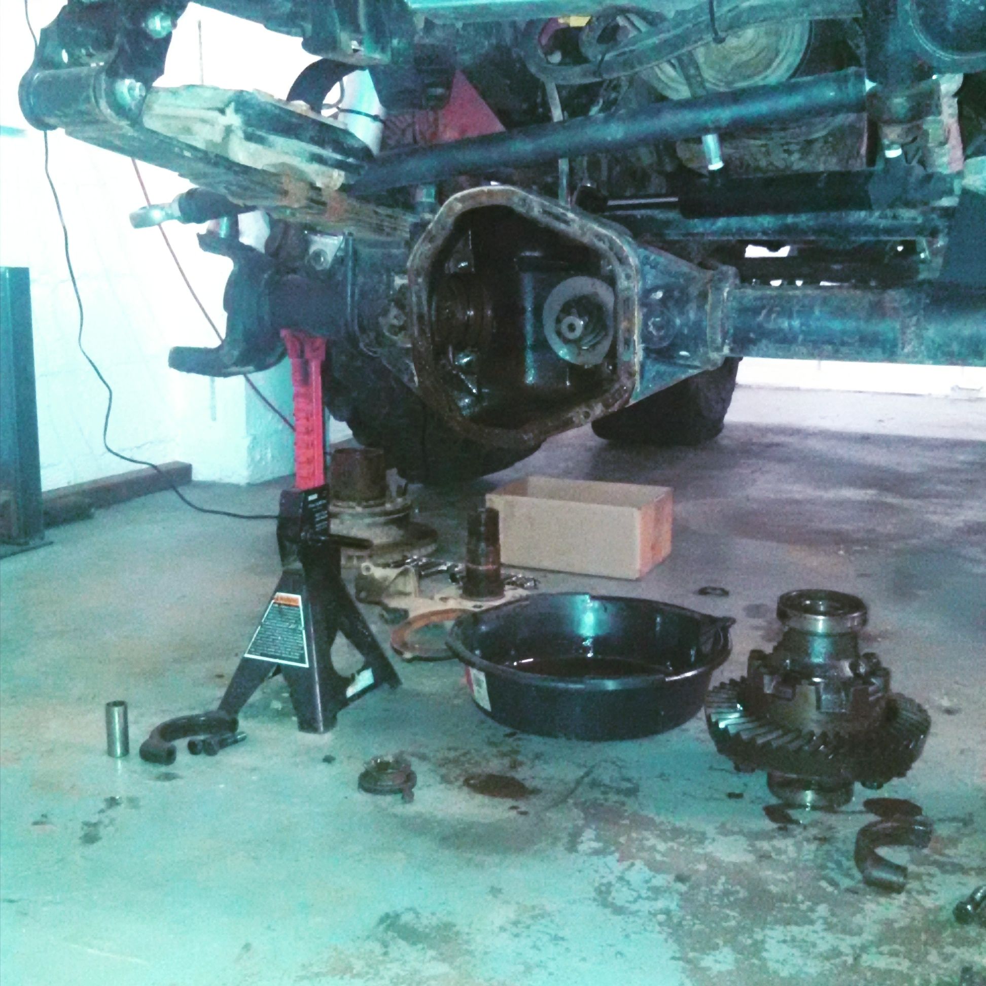

I'm doing the dirty deed of Dana 60 kingpins, axle seals, etc :gay: How have you guys cleaned 30-40 years of mud and muck out of your axle tubes? I didn't pull the housing out of the jeep, so it's sitting on stands in my "clean" garage.

Thanks for all the advice guys. I'm still working on this. I got one kingpin replaced last night, and broke the head off my breaker bar on the other side. As a motorcycle mechanic of 13 years, I now have a whole new respect for what tight AF is.
