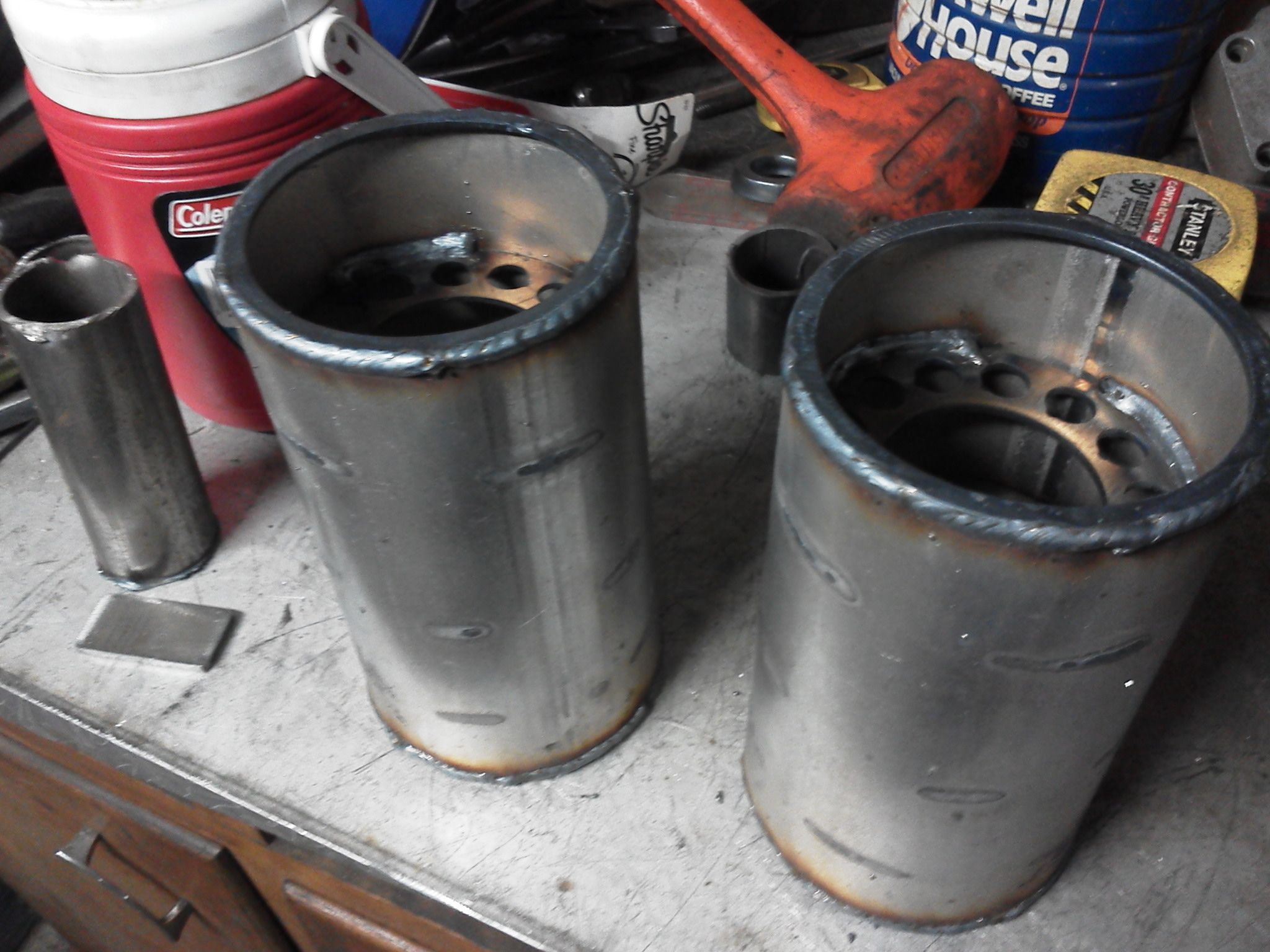

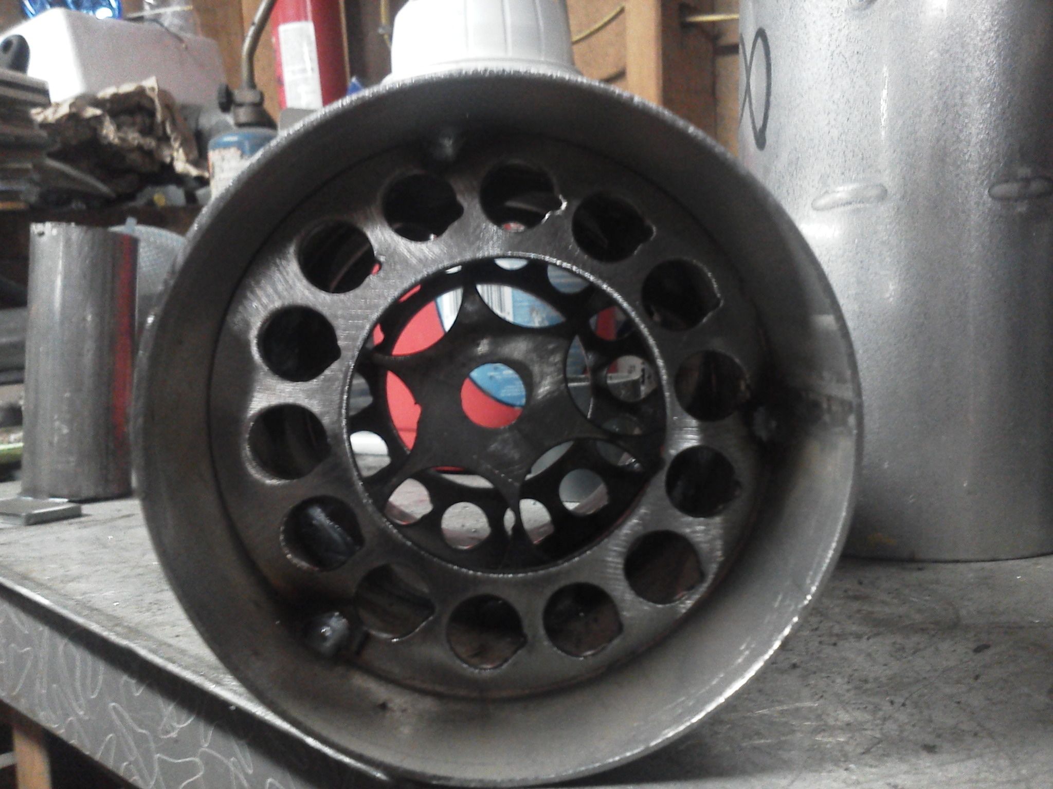

I made these out of a 4" piece of exhaust tubing and 10g plate. They're gonna be loud as hell but will take the shitty sound out of open headers.
My buggy has this in the headers an it sounds great I like em!!
I ran super traps on My open headers. They weld right to the collector. About four inches long. Change discs and make them sound any way you want.
BTW, what kind of shitty sound of you hear from open header? that's about the sweeeeeetest sound I know.
