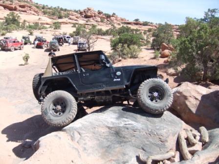

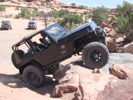

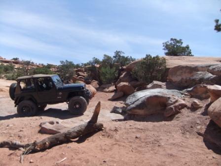

I am in Moab this week. Keep in mind that the rig was "finished" on Thursday evening and we left Friday morning. Ran Metal Masher Today. I tried, but was defeated on Rock Chucker.

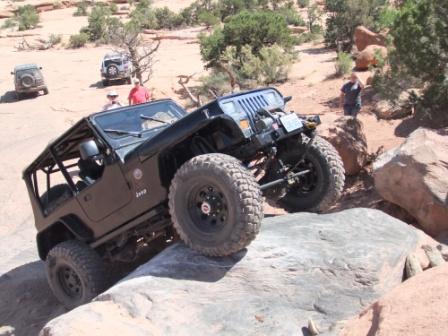

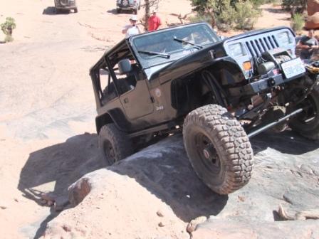

One more picture. This one "ALMOST" scratched the paint.
