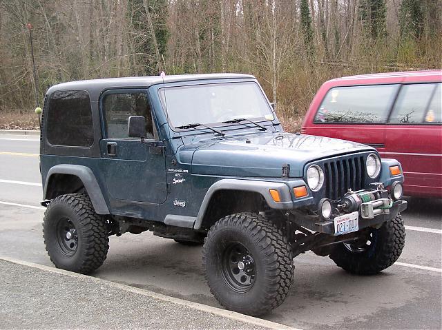

On my 97 TJ I installed a 1" body lift, a 1" engine lift and a 4" suspension lift.
Included in the suspension lift are 8 adjustable control arms and a "T" case lowering kit.
I rotated the rear differential to reduce the U-joint angle with the drive shaft
which worked well for the last 3 months, since the angle seemed good I have now removed the "T" case lowering kit to increase my clearance.
I am a experiencing a "mild" vibration that I assume comes from the drive shaft now that the angle is increased (still looks good to me but...)
My question is how much damage am I risking
Next week I'll be at the Nile Trailjam and will put the TJ though its paces but don't want to set myself up for catastrophic failure.

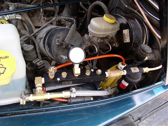

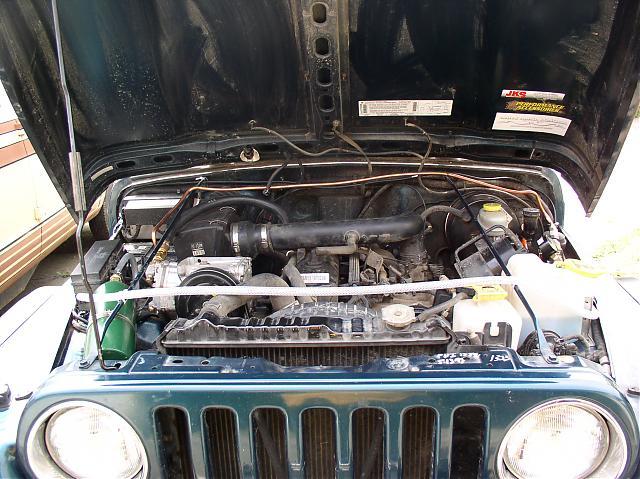

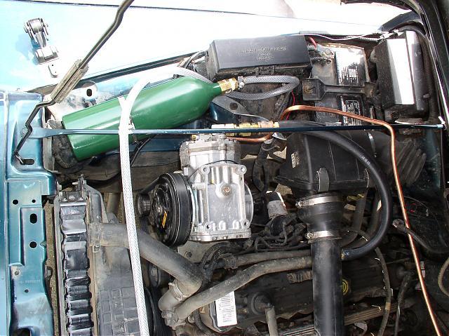

P.S. I installed a junkyard York and can't wait to use my new OBA!!!
the vibration seems mild to me, should I reinstall the T-case lowering kit until I can afford the SYE and longer drive shaft?
