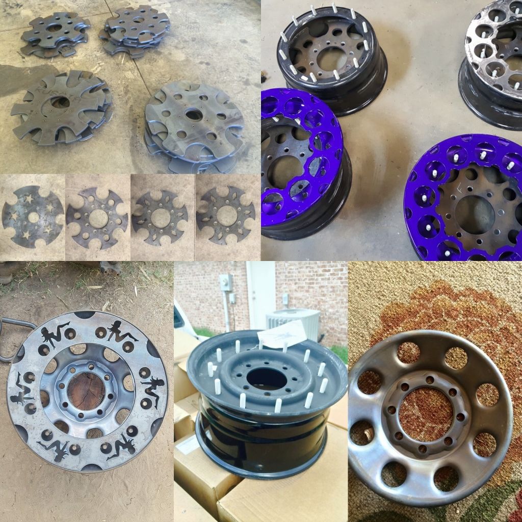

Not to hijack the tread but if anyone is looking for h1 double beadlocks
I sell new in the box never used 12 bolt h1's
with pressed centers or flat and
rock rings
I have even put silicone around the oring. Let it set up a night before you put air in
