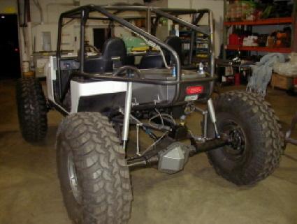

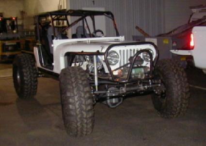

Here is my first attempt at building a rig from scratch. Started off by building my own frame then building from there. After building it would have rather just built a buggy but like the Jeep look.

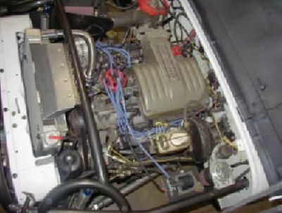

Here are the specs 4 link front and rear, foxs on all four corners, 5.0 slightly built:D , NP 435 w/dana 300, 60 front and 14 rear.
Took it out for its first spin tonight and it was a kick in the pants. Only problem is the rear main leaks so need to pull it all apart and fix it. Well hope to see some of you out on the trail hopefully will be up that way in a few weeks.
