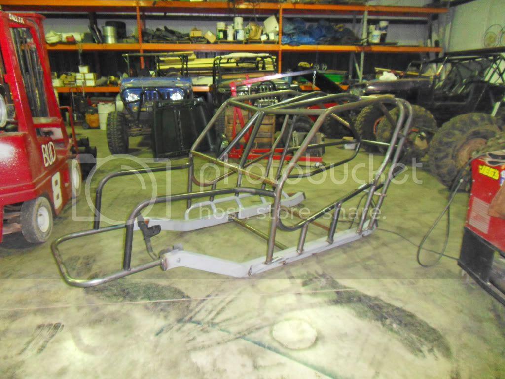

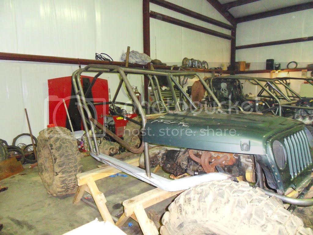

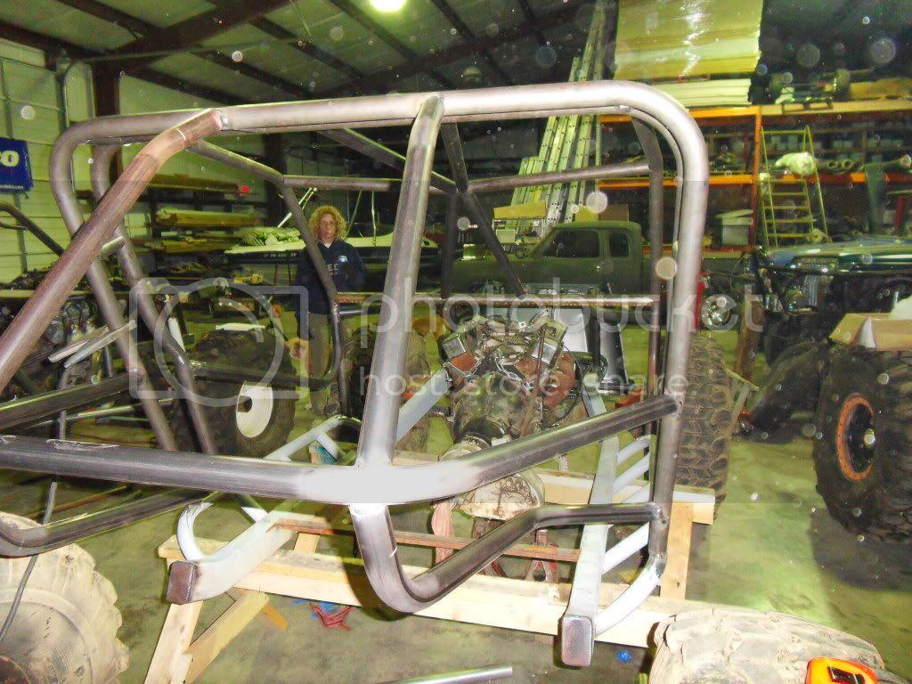

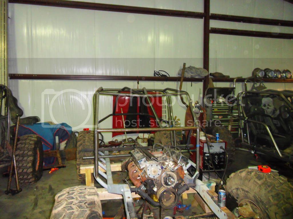

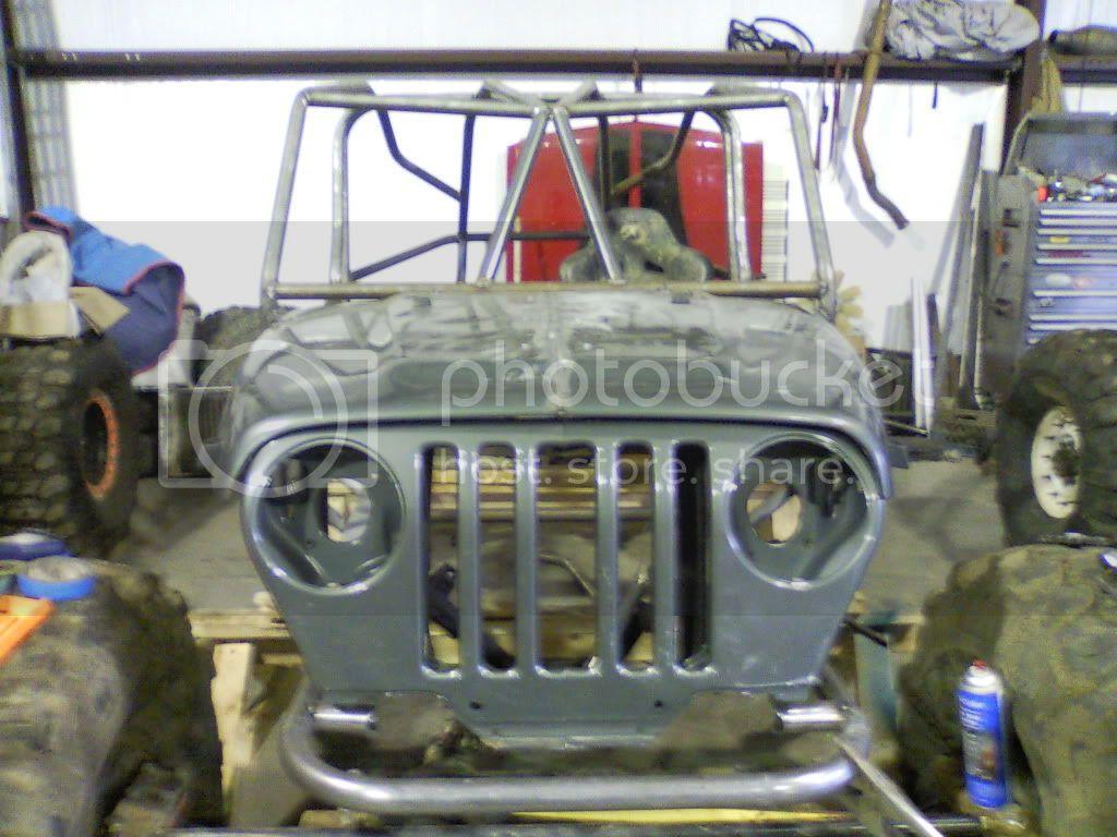

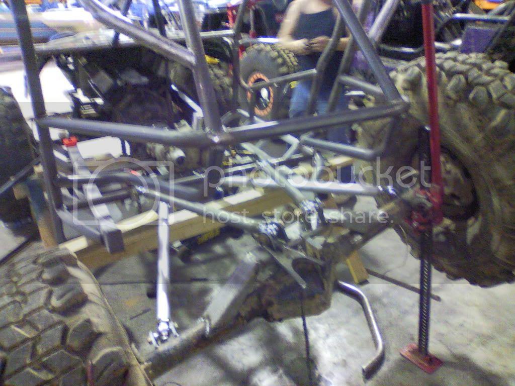

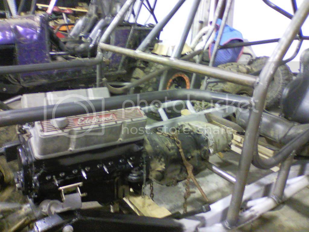

parts list is
60/14 bolt w/5.13 gears welded rear and lockrite in the front and 35 spline shafts and drive flanges

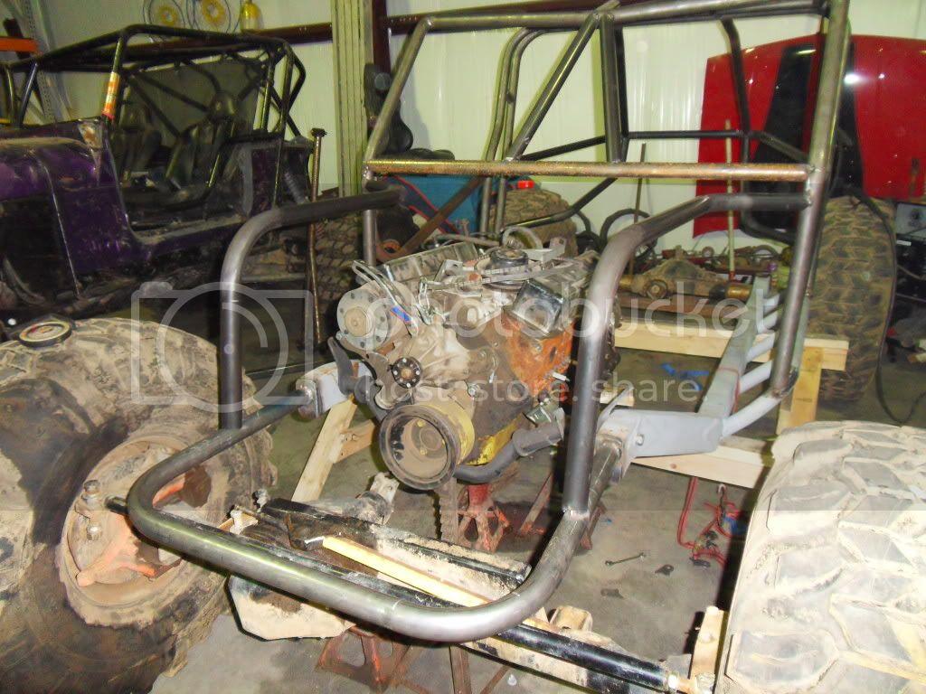

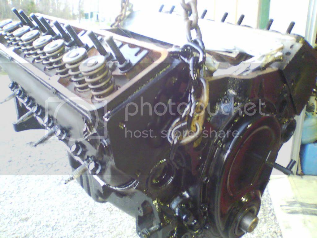

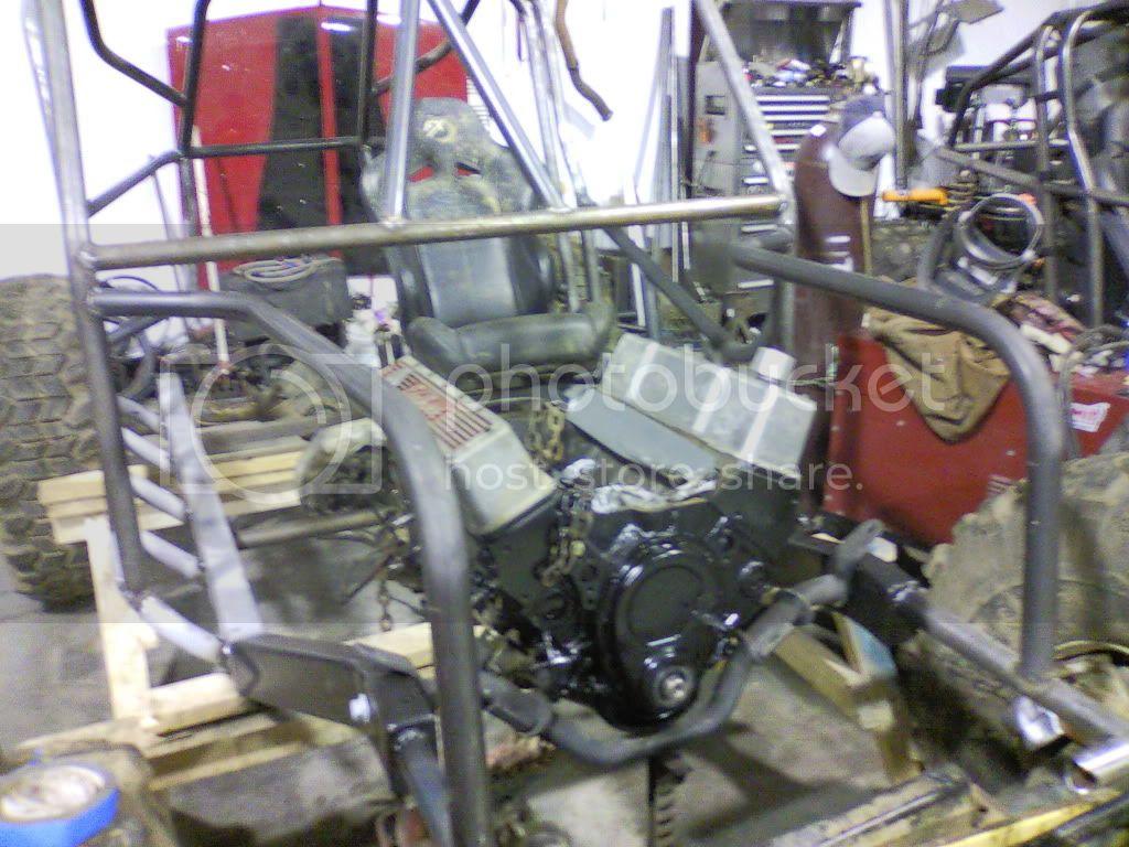

350 motor on propane
turbo 350 tranny/ dana 300 transfer twin sticked (stock for now)
42" swampers
tj hood and grille

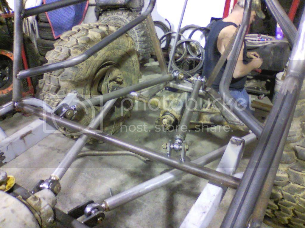

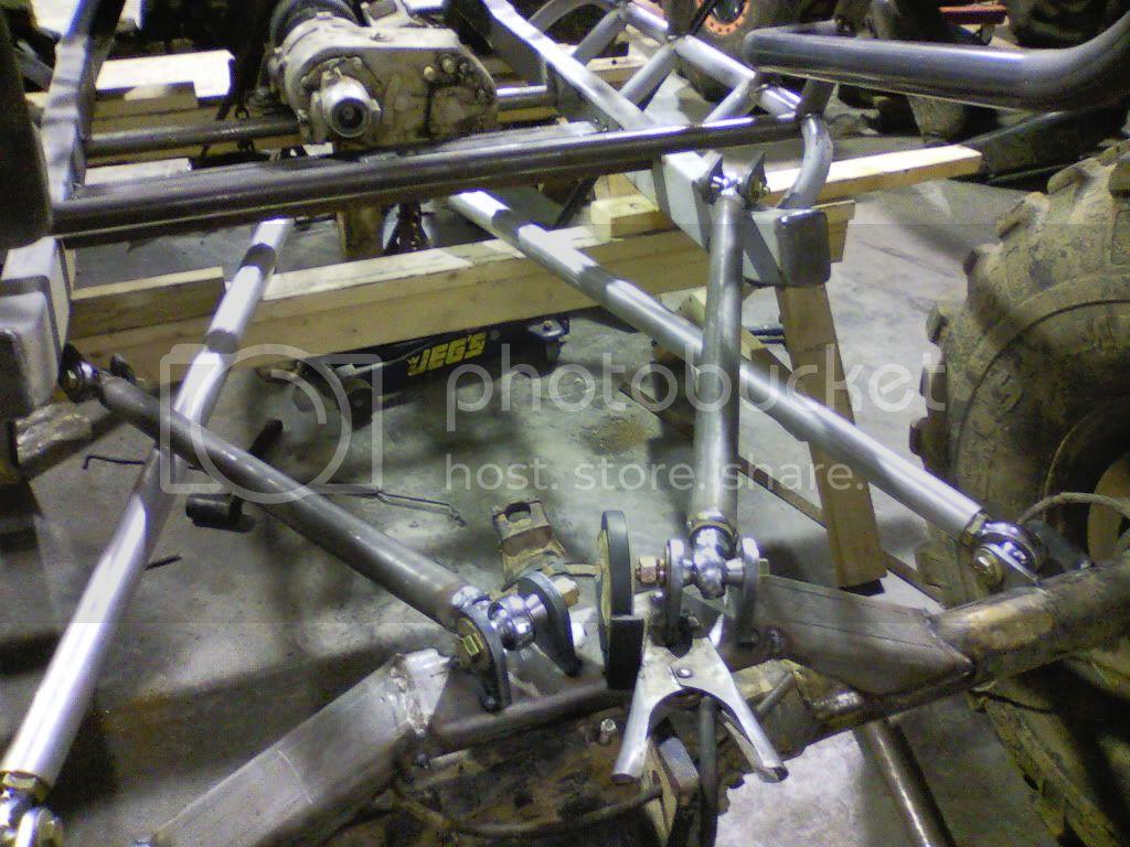

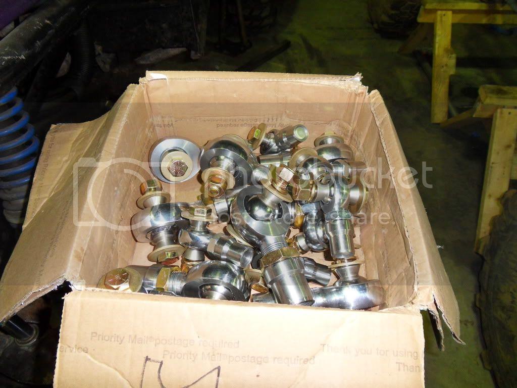

4 link f&r
shooting for 24- 26" belly height

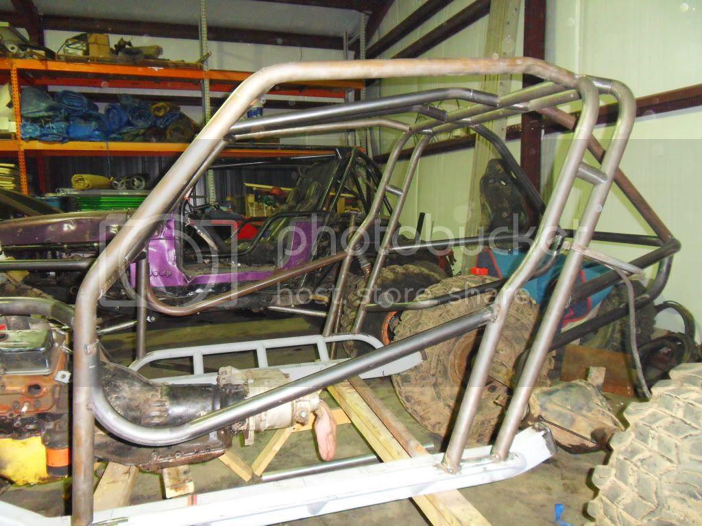

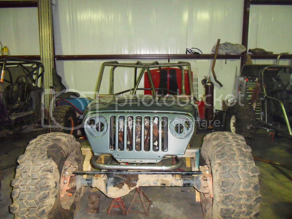

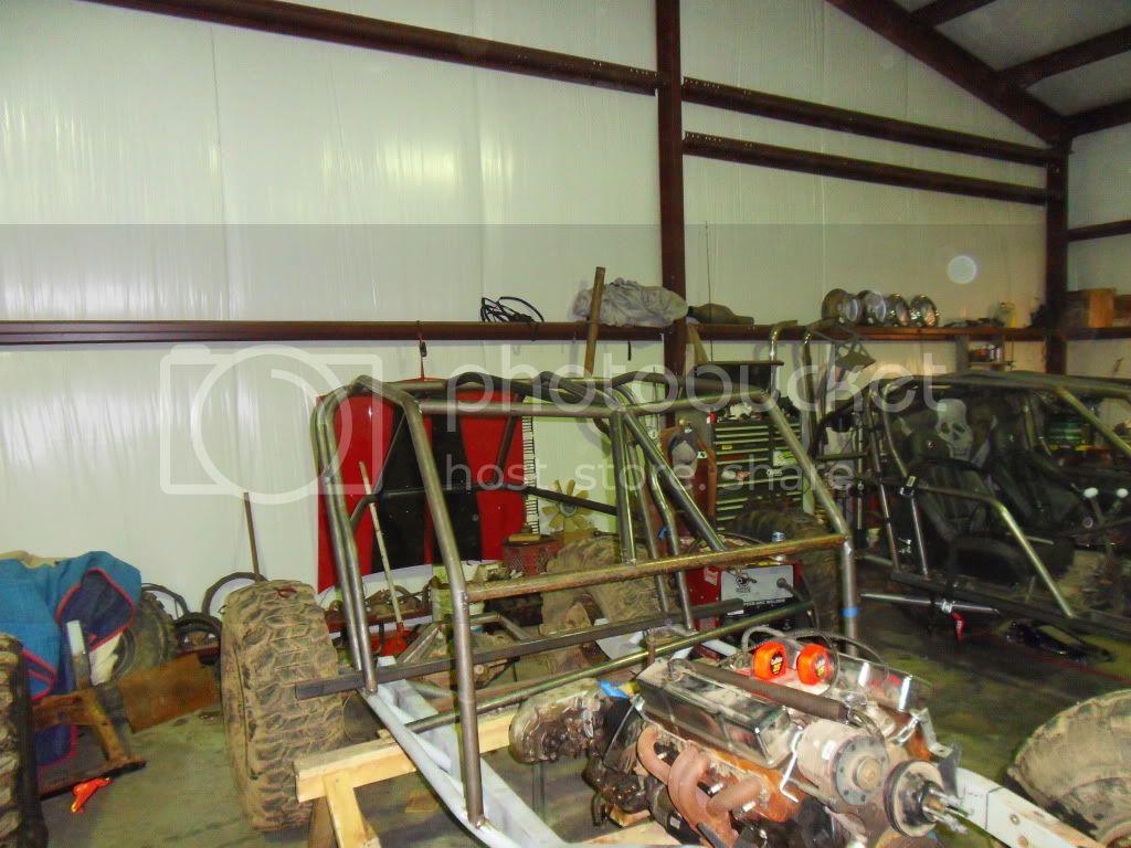

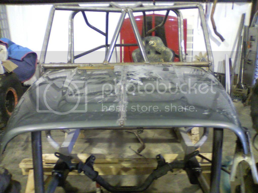

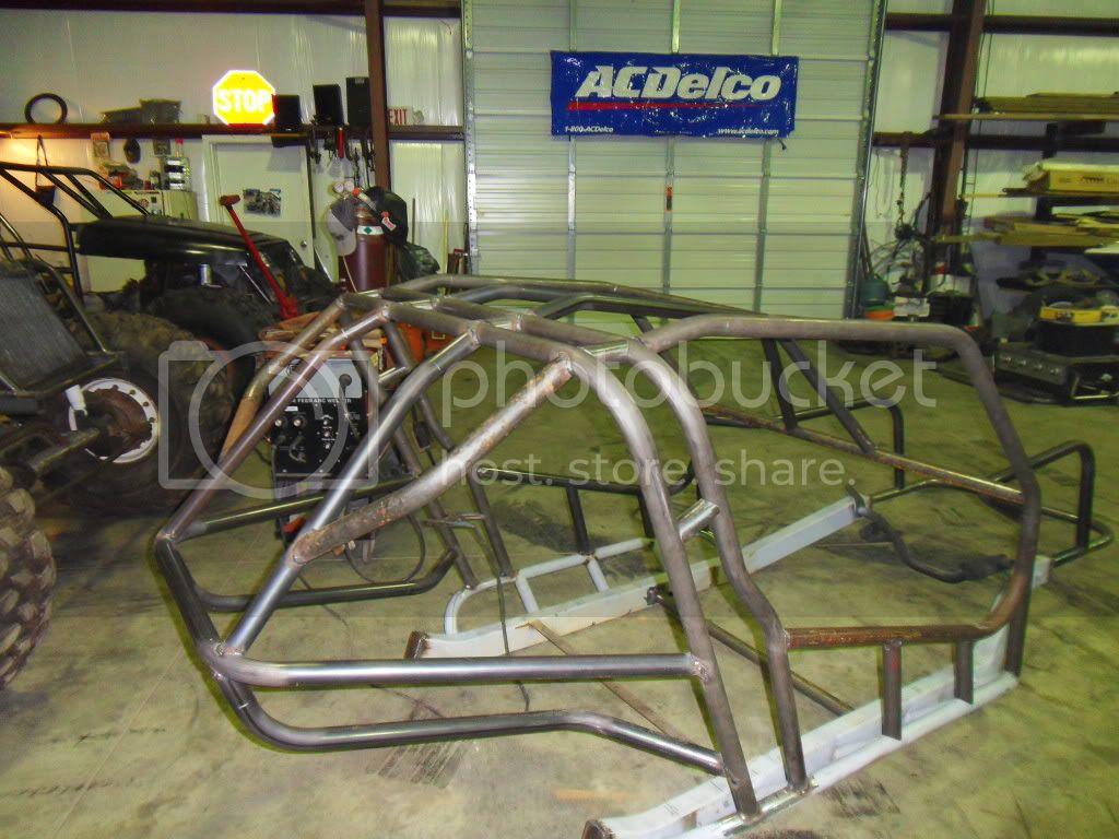

took to my buddy chads (green bean fab) to start the chassis and he has kicked ass and doing a hell of a job
[attachment deleted by admin]
