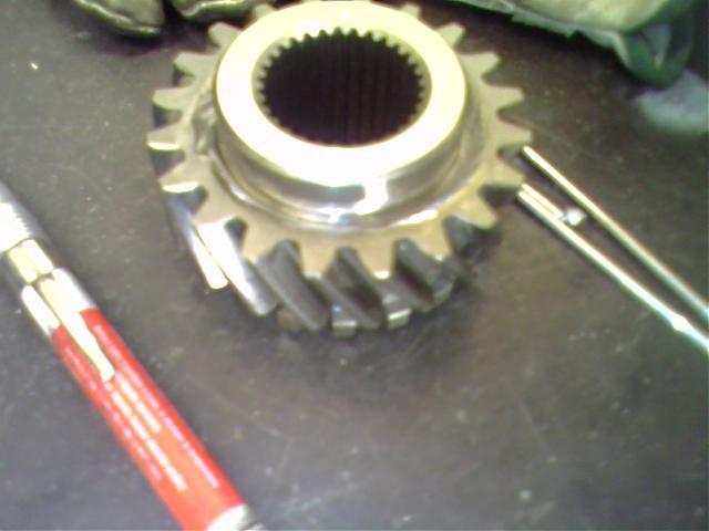

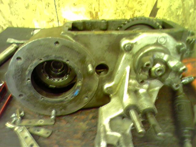

Well I guess you could say I have officially started the buildup of my 4 runner. The other day I finally tore into my 4:1 Dana 300 that I scored for free a year or two ago for my labor of replacing it with an atlas.
The reason the deal was so sweet is that it had something broken inside it, I had the feeling it was a broken input, and after a partial teardown, I found the broken input gear, it is a factory welded and then machined down, so after preheating and slow cooling 2x and then the lack of machining I put it back together with an added few horsepower (quickie paint job).

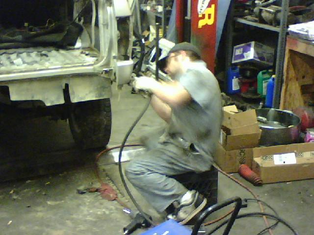

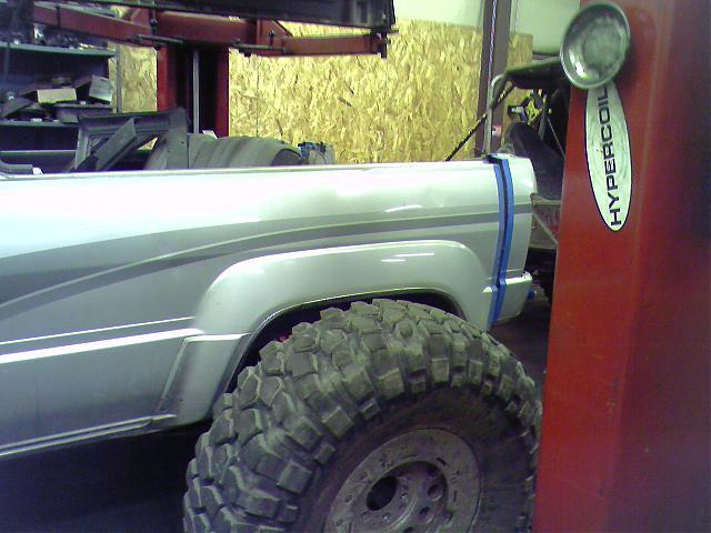

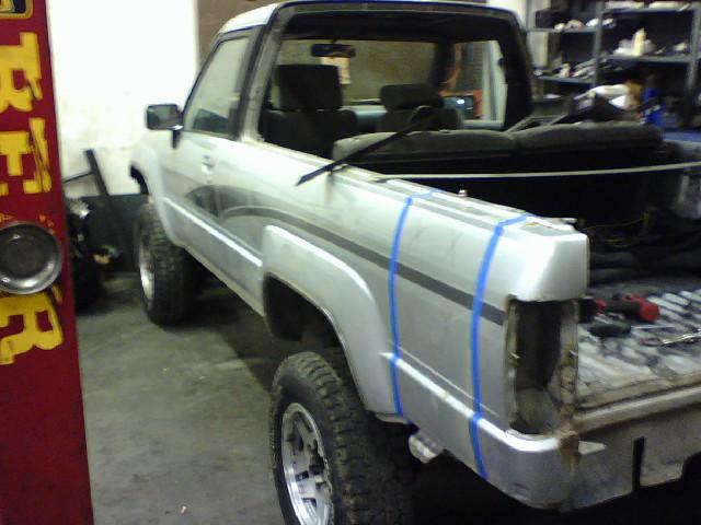

Tonight I pulled the top off and tore the rear wiring and crap out and started measuring, taping and cutting for the bob job. I decided on losing 13", so I started cutting it up, but since we didn't get done working on shop project's till damn near 9 tonight, when midnight hit I just threw in the towel. I'm sure I'll have the bob job done tommorow, and post more pics.

A couple more pictures of the short man cutting up his new toy..:haha:

just got off the phone with him he forgot the digital camra again:mad: just goes to show you the air is getting thin down at that lower elivation:haha: :haha: :fawkdancesmiley:

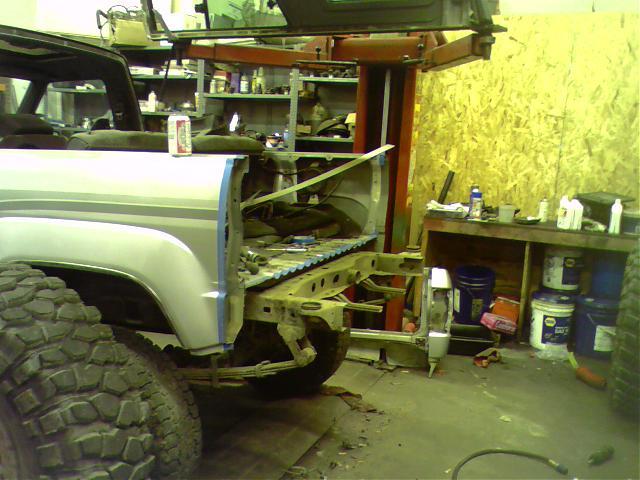

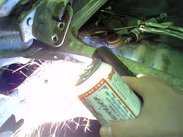

Well I didn't get as much done tonight as I wanted, but I did get plenty of beer drinking done. I can't finish the bob job till I cut the frame, and I can't cut the frame till I link it, seeing as how the shackle mount's are behind the cut point. 13 inches didn't seem like too much, but now it look's like it will work with me.

Yes that is a beer in the same hand I am torching with, and yes I was taking a camera phone picture with the other hand, and yes there was also a smoke hanging out of my mouth. good god I'm a talented f#$%.
