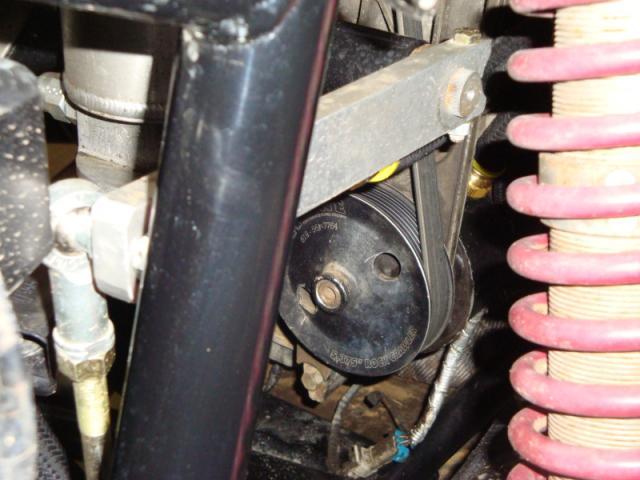

I'll get in on this too...JasonC, what are the pro's and con's of a system like this. Never seen a arm that short and wonder if is beneficial or not.
To my knowledge there isn't much(IF any) of a selection of different sway bar rates. You can fine tune it by changing the arm length--as that changed the leverage. Longer/lighter and shorter/heavier. This is what I got from my dealings with them..

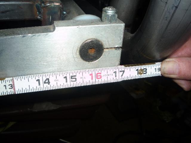

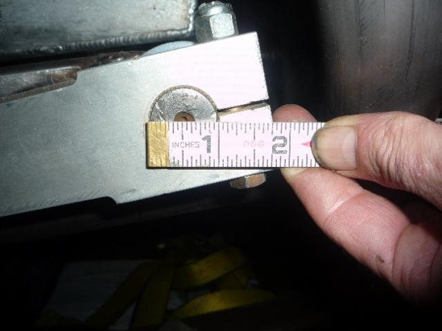

i have one 28" long i cant really use (bar and alum arms). how wide are your frame rails?
talked to Tony at Rock Equipment and he gave me a few pointers for my set up. I already have a 36" .75" bar and arms that I bought used of this board a while ago. The arms are 14" center to center, the axle end will be around 3-4" higher then the sway bar end. At the arm end on my axles to place the lower mounts a couple inches wider then the arms because as the axle drops it will swing in.
stan
Your going to want a swaybar in the rear Hip... jsut get different length bar.
ya for sure, he needs a longer/wider one
yeah i know i will need one and someone gave me one its just too short for my frame rails.
unless i mount it to the axel truss and run the arm up to the chassis. i would like one a little longer as where i want to put it it barely touches the frame rails:eeek:
so any one wanna trade? mine is 28 inches long and i think its 1" dia. ill measure when i get home tonight.
